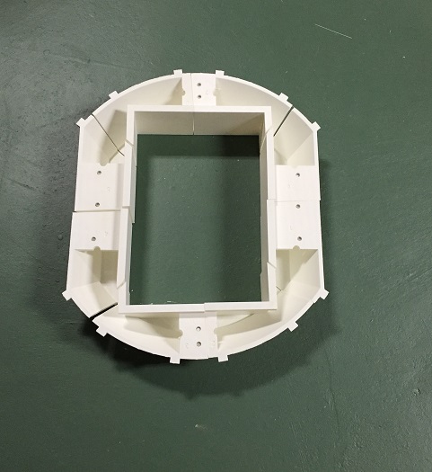

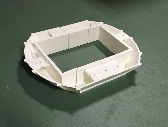

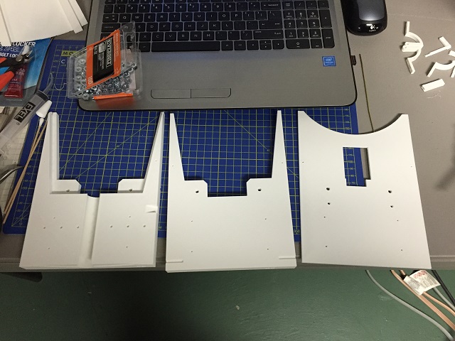

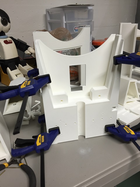

So I have started building the second ring of the main body.Before assembling this ring you need to put some steel pins in some parts.These will act as hinge pins for the opening compartments on R2s main body. The shoulder parts are made up of three printed pieces that are glued together and then slotted into the shoulder frame.This part needs to be very strong as it is where the legs join the body.

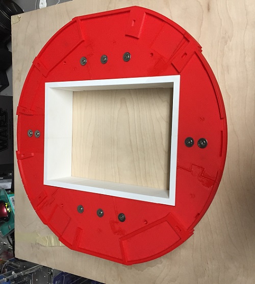

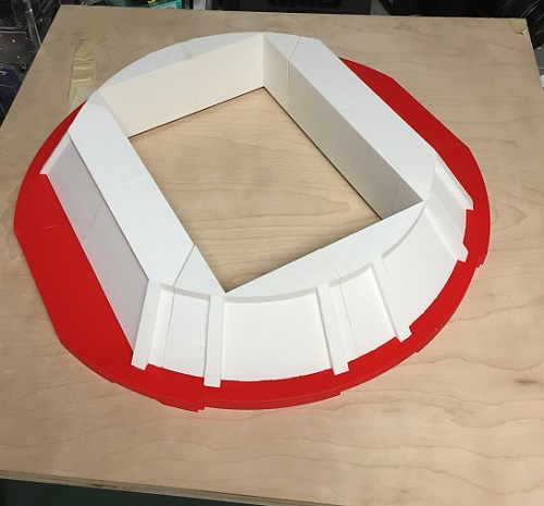

I have also printed the skirt (the bit that is underneath the main body).These parts were pretty big and took about 12 hours each to print. The parts have recesses for nuts.There are holes in the base ring that align with the nuts so you can bolt the skirt to the base.I used 10-32 nuts and 1 1/2 inch screws.The nuts were epoxied into the recesses in the skirt.Once the skirt has been glue together I will attach it to the basering with the screws.There are some plastic parts that help to hold the parts together.These were very fiddly to install, but help in keeping everything aligned.

The skirt is now finished and bolted on to the base ring.
