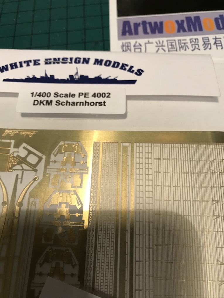

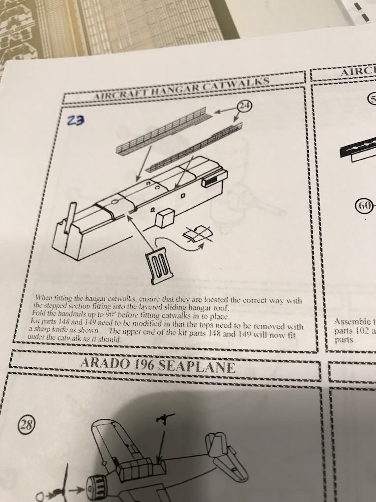

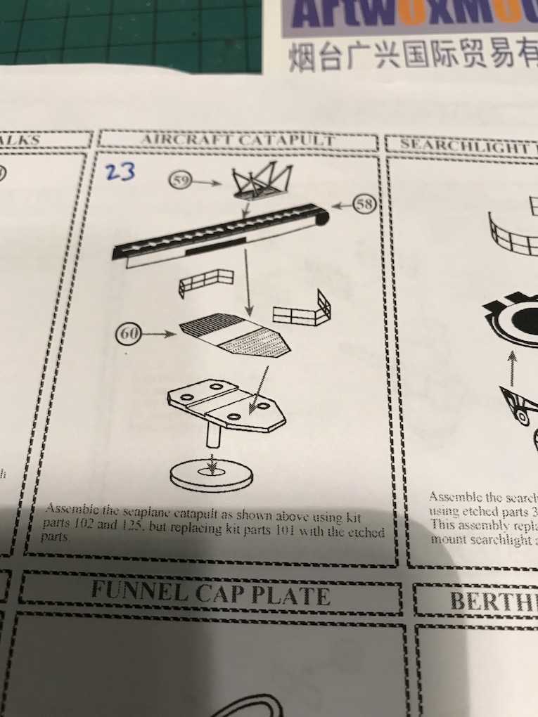

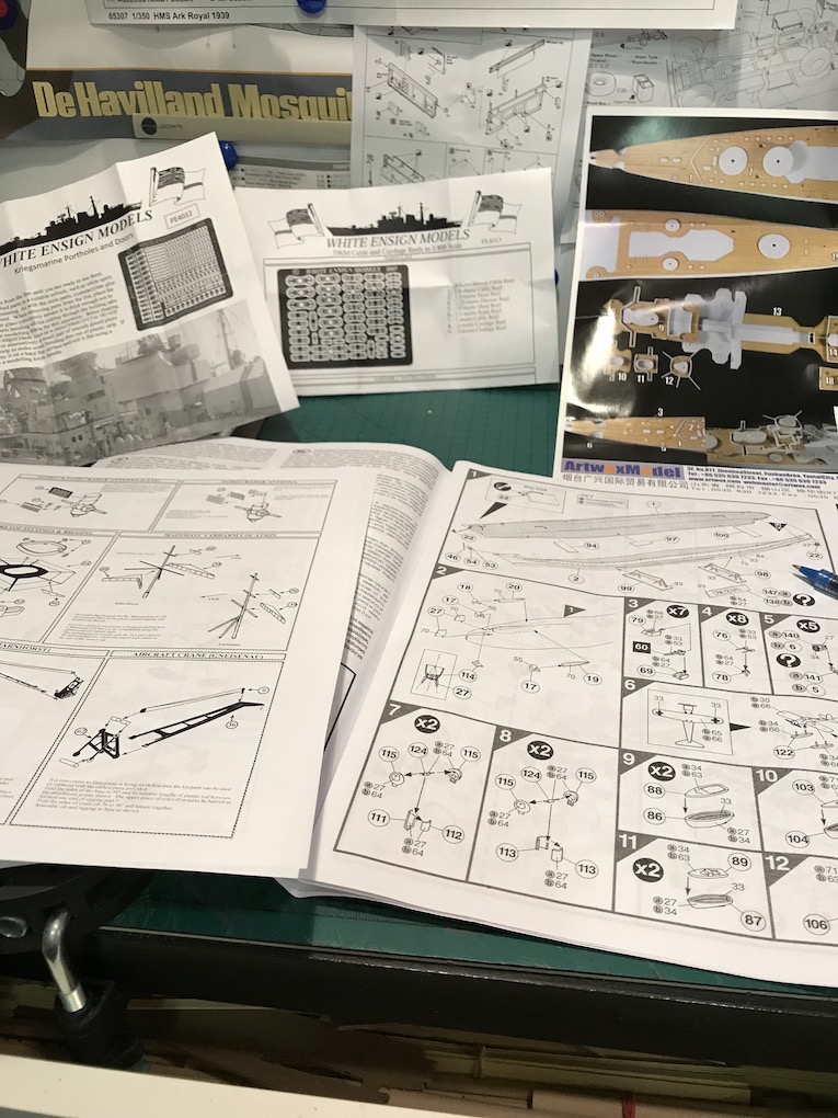

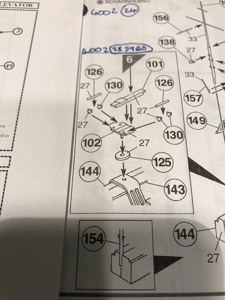

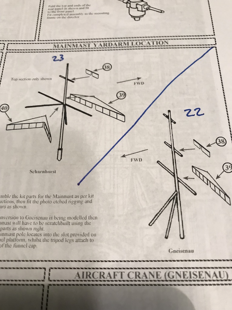

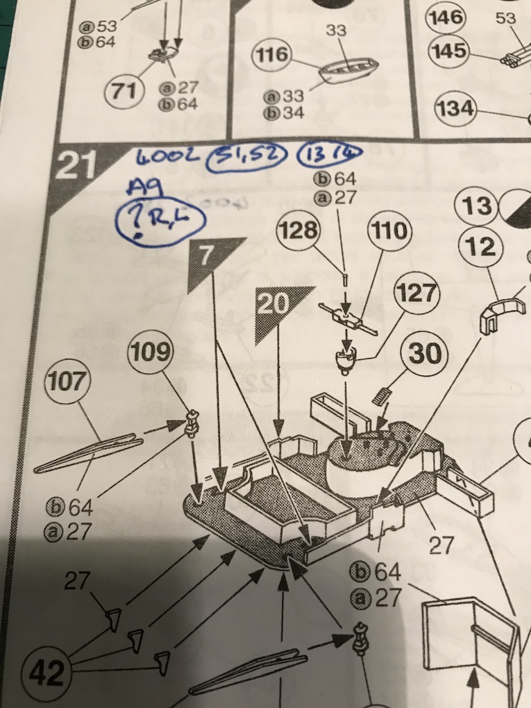

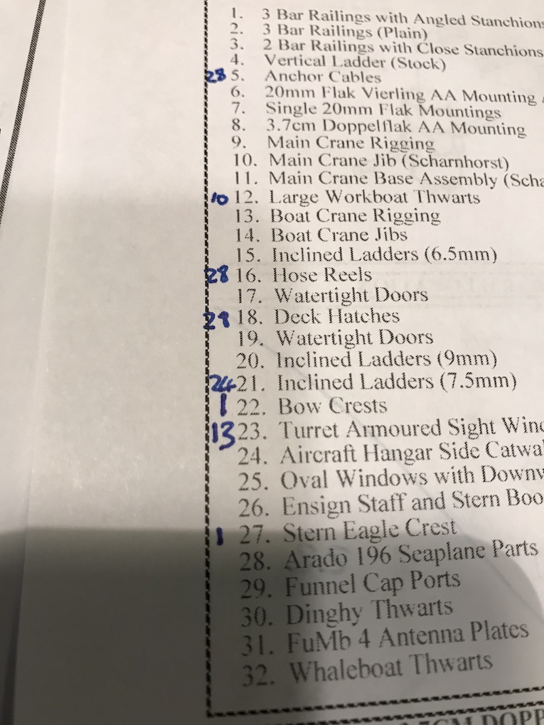

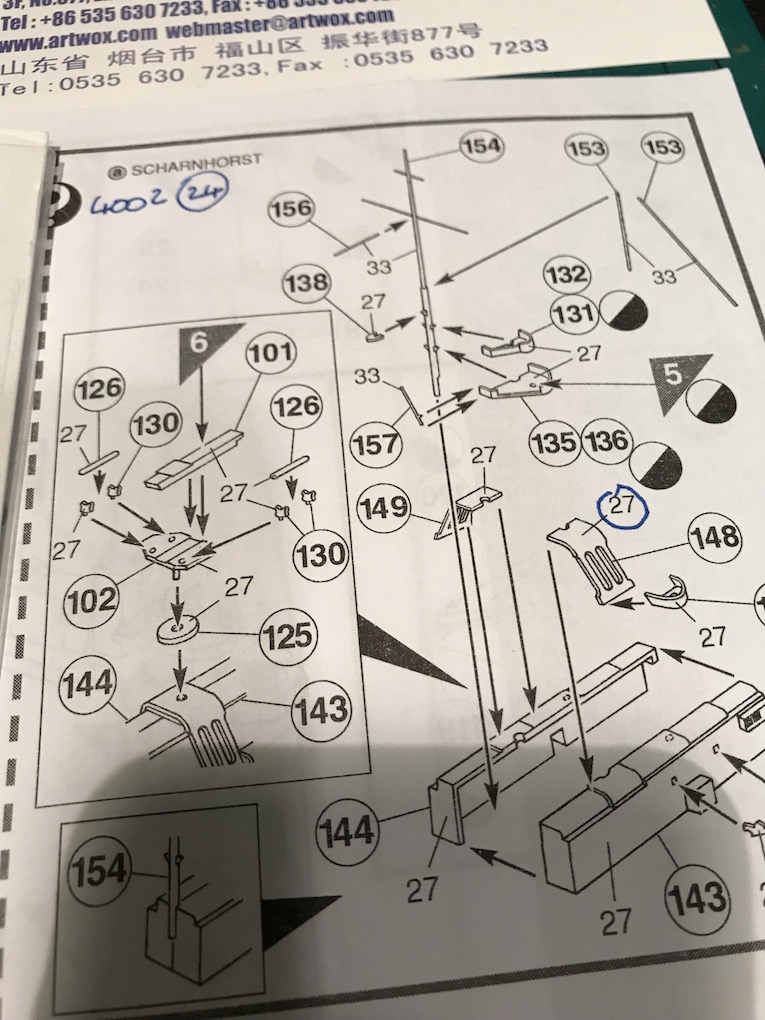

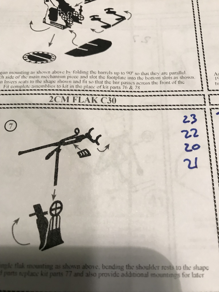

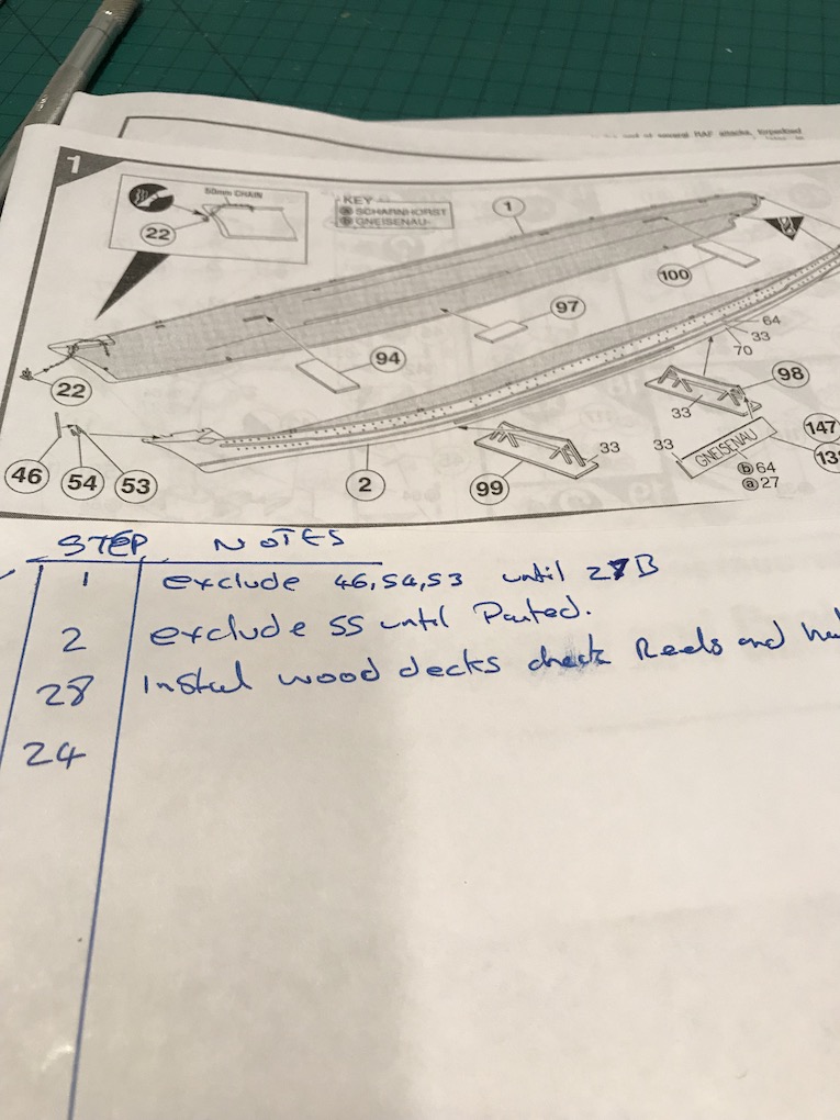

Crows Nest - How to organise multiple Instructions.
In this blog I wanted to discuss how to organise build instruction where you have to bring several instructions together. Most kits come with some form of build sequence to follow which has been designed by the manufacturer to help you build the kit without any issues. but what happens when you introduce more instructions. with the ever growing range of after market additions updates and replacements available you can be faced at several sets of instructions to digest. whats more all those changes to the original kit may well require a change in the build sequence to accommodate the changes.
Having built countless models that have incorporated several sets of instructions I wanted to share the way of working that I have refined over time.
To demonstrate my way of organising a build I will be using the Heller Scharnhorst 1:400 kit instructions along with 3 sets of White Ensign etch instructions and a set of Awok wood deck instructions. Photo 1
1. My first rule is that the Kit instructions should remain 'the' set of instructions refers to in the build.
2. My next step is to identify each set of instructions with some form of reference, I use the kit reference if possible for example PE4002 to refer to the large etch set as in Photo 2. if the main kit instructions do not have step numbers I create them
3. I carefully go through the instructions for each set and note them in the step on the main instructions as well as the secondary instructions. You will see in Photo 3 I have added '23' this refers to the step in the main instructions that these etch parts are used. In Photo 4 you will see I have noted within step 23 of the kit instructions the addition of part 24 from etch set 4002. Also you will se I have hi lighted that part 27 of the kit needs to be looked at, this part is modified.
4. Where several parts are used together in an assembly such as in Photo 5 I group these together on the instructions as in Photo 6. This is important as sometimes there may be more than one assembly within a step. Photo 7 shows two sets of etch assembly and the 'A9' (artwork part number 9) refers to the wood deck required in that single step
5. if necessary separate steps on the secondary instructions to reflect the main instructions. photo 8 shows two options being separated as they are in different steps on the main instructions.
6. Some Items may be used in several steps, note them all down so you don't miss anything as in Photo 9
7. Not all parts on the etch fret may require assembly and my not be shown in the instructions. photo 10 shows some parts which are not shown in the instructions, again I will ensure that they are referenced on bot sets of instructions.
8. if your unsure if parts may be need note down that question in photo 11 you can se I have added '?r/l' hear I am questioning if I need to ad railings and ladders. I will do some research to establish this and use the parts in the etch to fit out the assembly correctly. I will do the same if I feel something may need scratch building or modifying.
We now have a full set of cross referenced instructions allow you to clearly se at what point you need to consult the other instructions and also where you can straight build without having to check back.
The last thing to do is sanity check the build process.
9. list out al the steps in the instructions, in the case of this build there are 28. on a sheet of paper I then put the steps in chronological order to how I won't to build the kit. in the case of Ships I generally prefer to build from the middle out. I will also make some build notes. in photo you can see that I have decided to build step 1 first but omit some of the parts until later, step 2 second and step 28 (installing the deck) third
10. the final step is to add additional stages if necessary, Photo 13 shows me adding a step to instal the main deck railings and flag staff as the final stage.
You now should be able to build feeling organised and without worrying you missed something
I would love to hear peoples thoughts on this, how do you take this? any tips you want to share?
Until the next Blog
jase attached the following image(s):

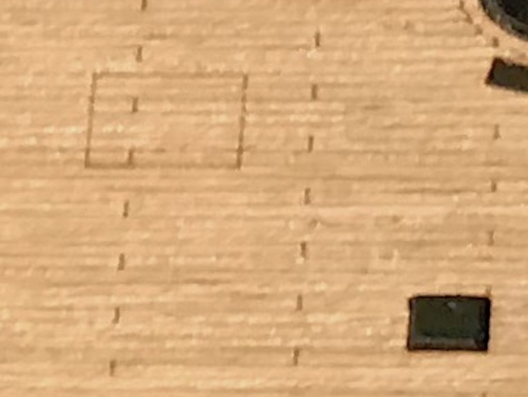

Planking a wooden ships hull can be tackled in different ways. The one thing all model builders will agree on is that it takes time, calculation and thought. It is common to plank a ship using wedges to fit the gaps that naturally occur as the planks are laid, there are plenty of methods of doing that process. but what if you want to avoid dong this? whether it be a model with a single planked hull or the second planking, if you want to show strips running the length of the hull with no gap filling then you will need to create a planking fan.
A planking fan maps out the thickness of your planks at each frame they are fixed to. traditionally this involves measuring the gap, making calculations and plotting on large sheet of paper and hoping your maths hasn't let you down, it can be quite time consuming.
However there is a simple and quick solution these days, the use of a spreadsheet. So I have created two planking fan spreadsheets that create the template for the creation of your planking fan, one in Excel and one in Numbers. they are both free to whoever wants them and can be downloaded from the links below
Excel
https://www.dropbox.com/...20fan%20Excel.xlsx?dl=0
numbers
https://www.dropbox.com/...king%20Fan.numbers?dl=0

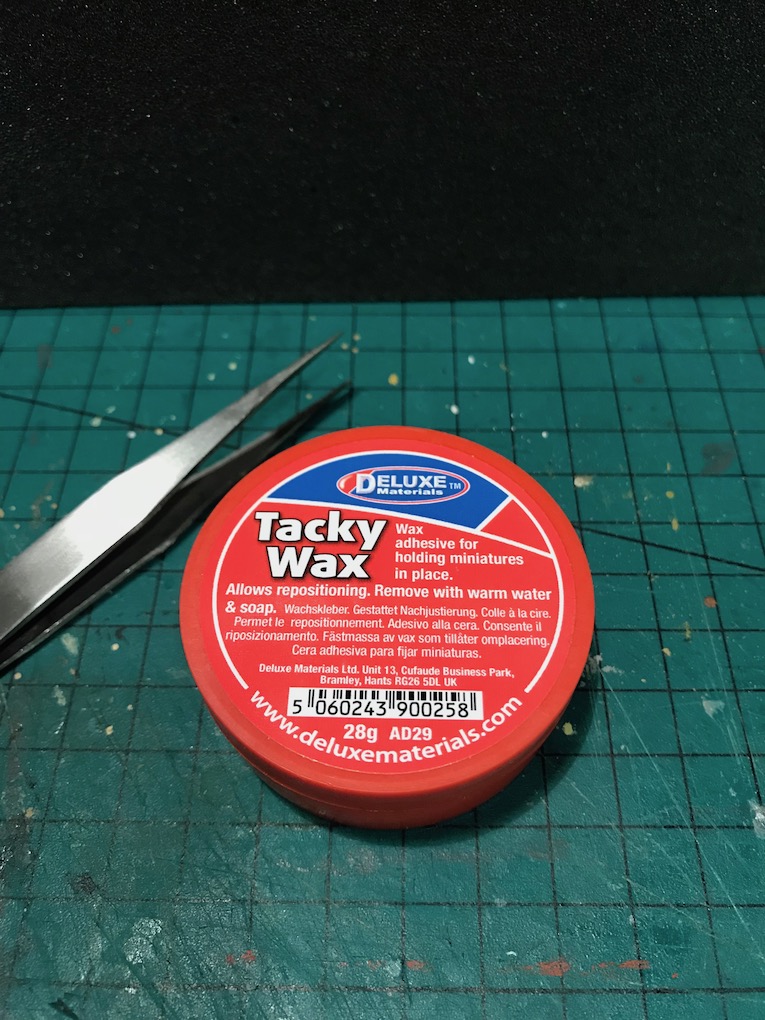

#29 Posted : 06 December 2017 21:26:07

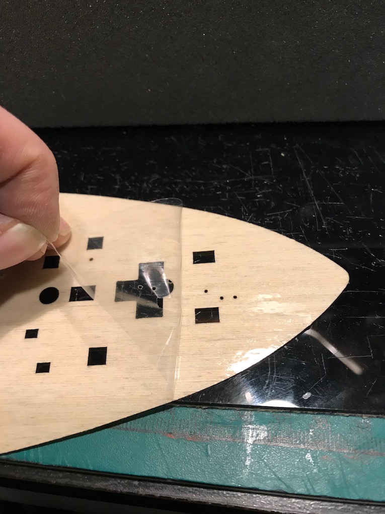

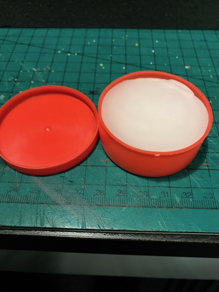

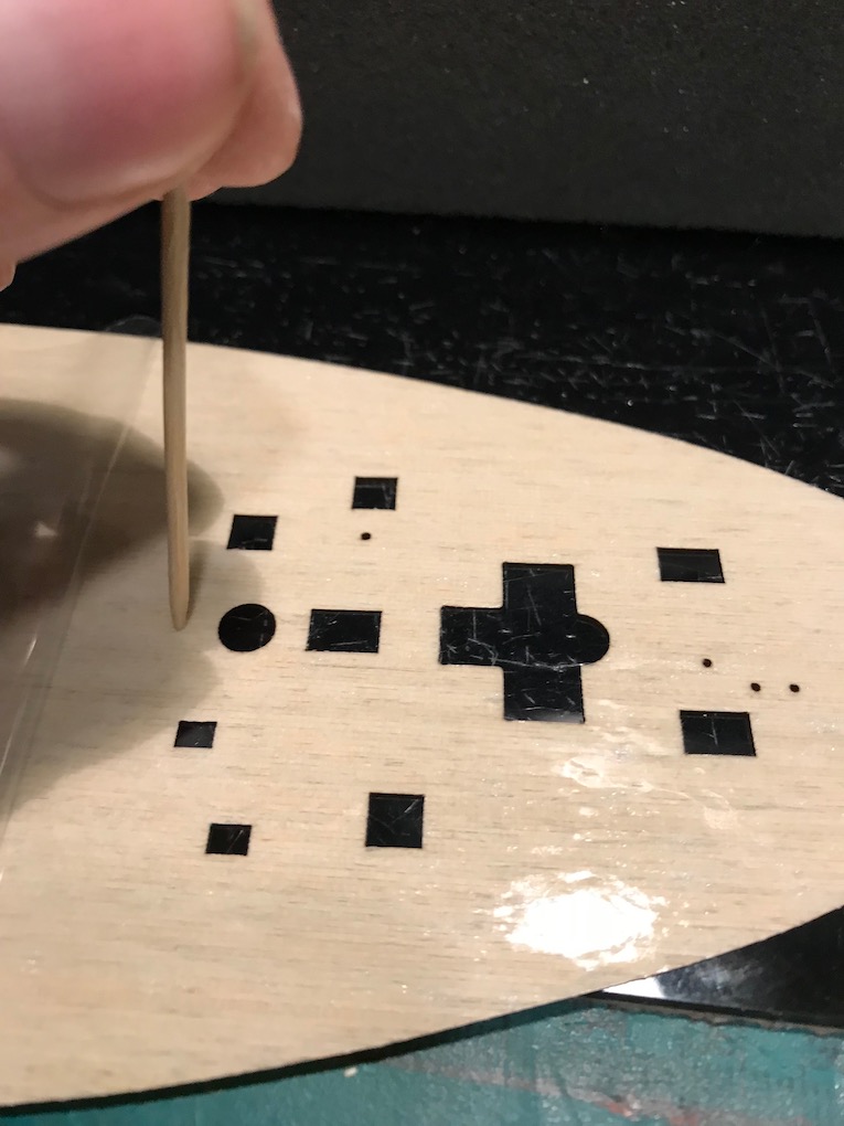

Ditty Box - Tacky Wax
In Todays Blog I wanted to talk about Tacky Wax, sometimes known as museum way.
Tacky Wax is a semi-perminant adhesive that is commonly used by model builders of dolls houses and railways, but is often overlooked by other modellers. The product is is promoted as the ideal solution for placing figures or other objects on a diorama as you can reposition them, ideal for railway modelling and why it is a common product in museums.
Tacky Wax has loads of potential uses, I have used it for keeping screws on a screwdriver, complex multi-part dry fitting to check everything fits as it should, placement of small parts and for placing figures and vehicles on dioramas.
The advantage of this product over other glues is that it won't damage the paint or be absorbed by your diorama sub-stright. For ship builders its the ideal product for placing crew or even placing ships boats or parts like guns that you may want to reposition occasionally.
Some caution should be used on wood that has not been sealed with a varnish but otherwise this is a great product with so many potential uses.
A pot of tacky wax will set you back about £3 and it is said you are more likely to loos the pot then use it up as it goes such a long way.
#30 Posted : 07 December 2017 10:45:49
I get the idea of using this stuff to temp secure figures or items in place, but does it not leave a wax residue on the part if using it for holding parts?
#31 Posted : 07 December 2017 14:54:55
Genraly I have had no issues as you use a very small amount, any residue is much less than you may get of the wax etch placing pencils for example, however it ia always worth checking it out with spare material before using it. If you use an excessive amout you will have to clean the parts.
Many thanks for looking in

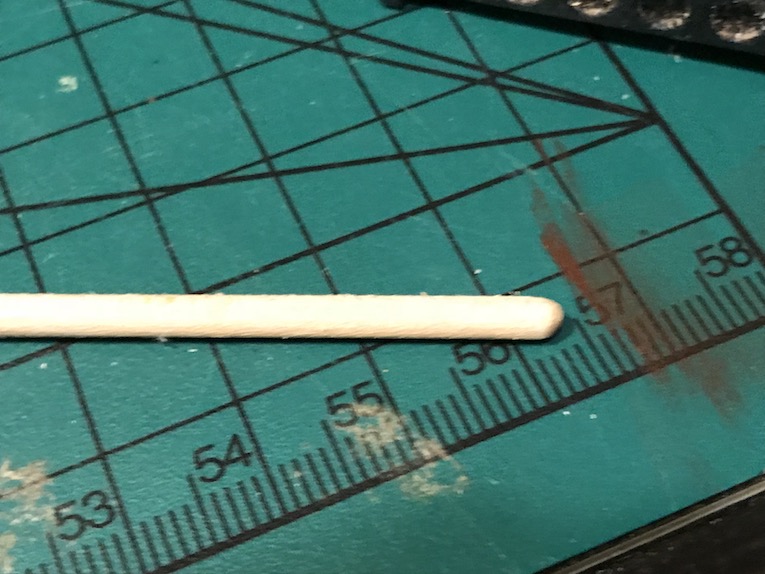

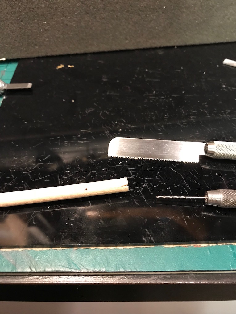

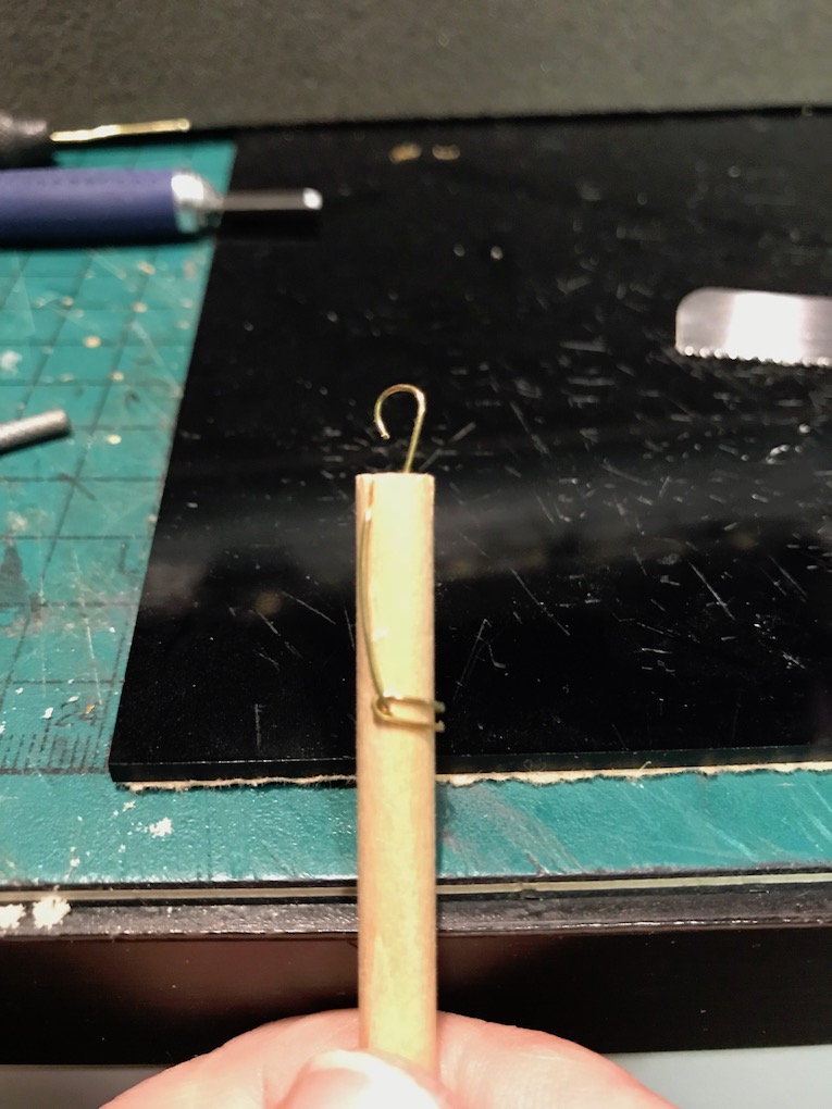

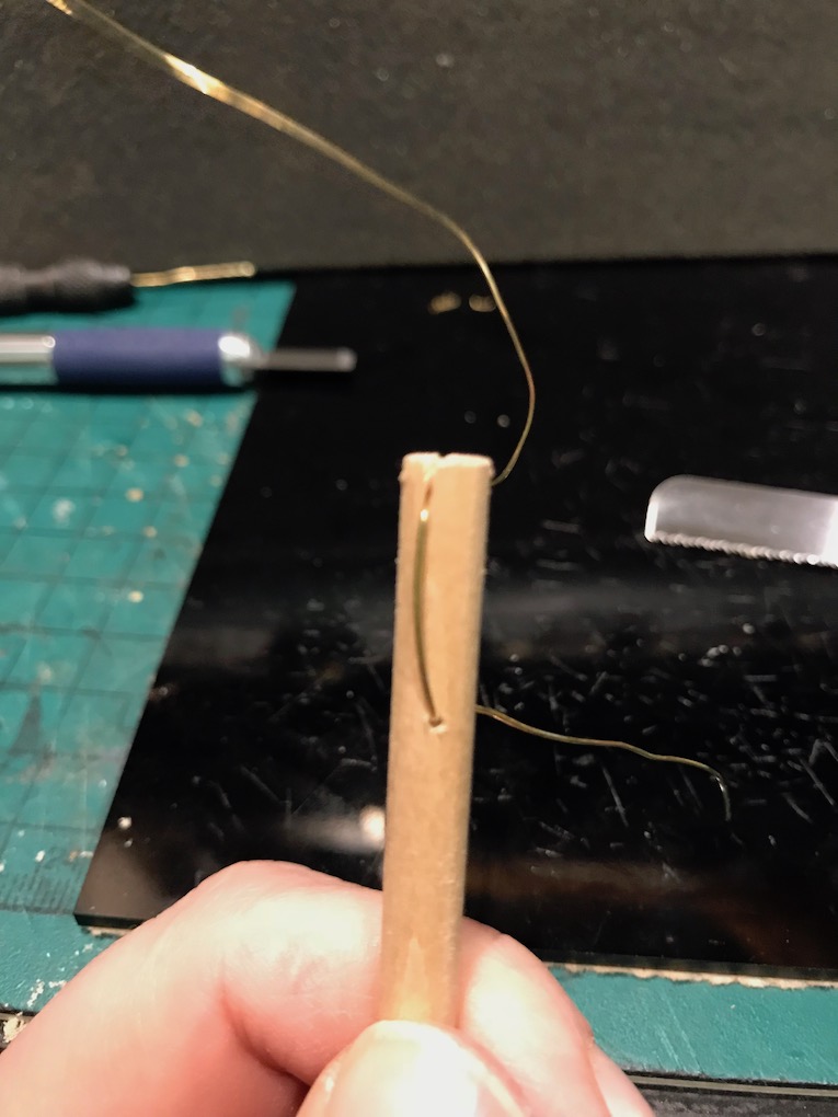

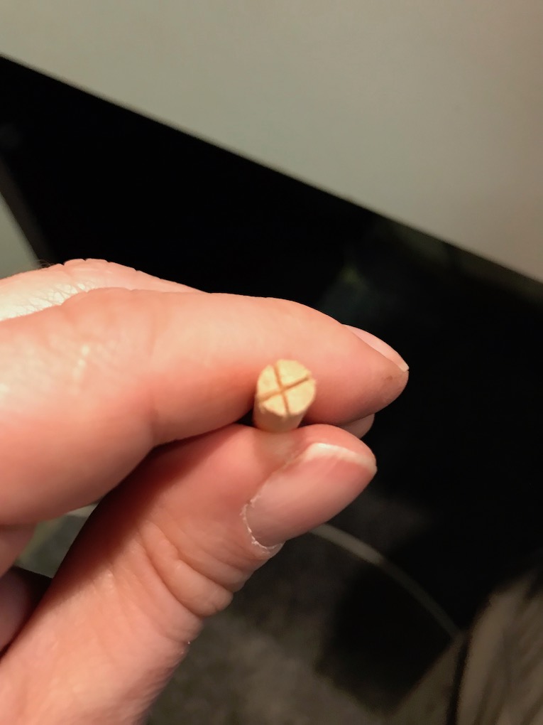

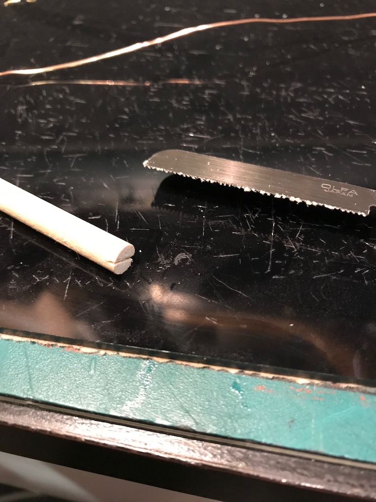

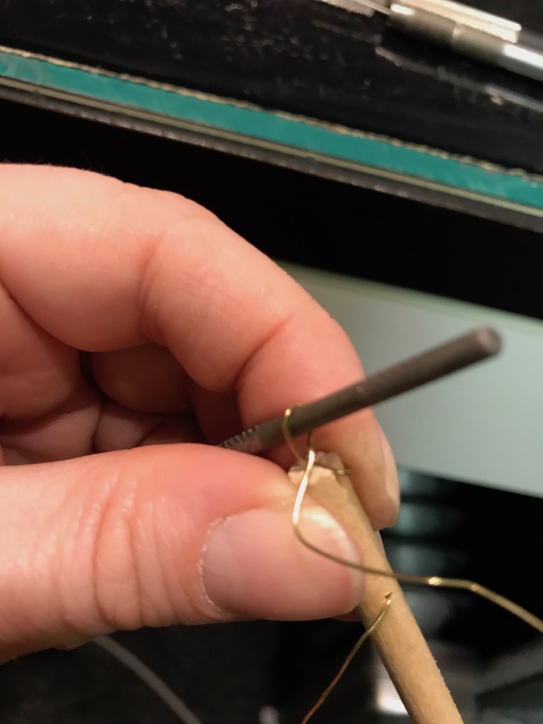

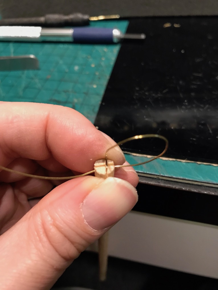

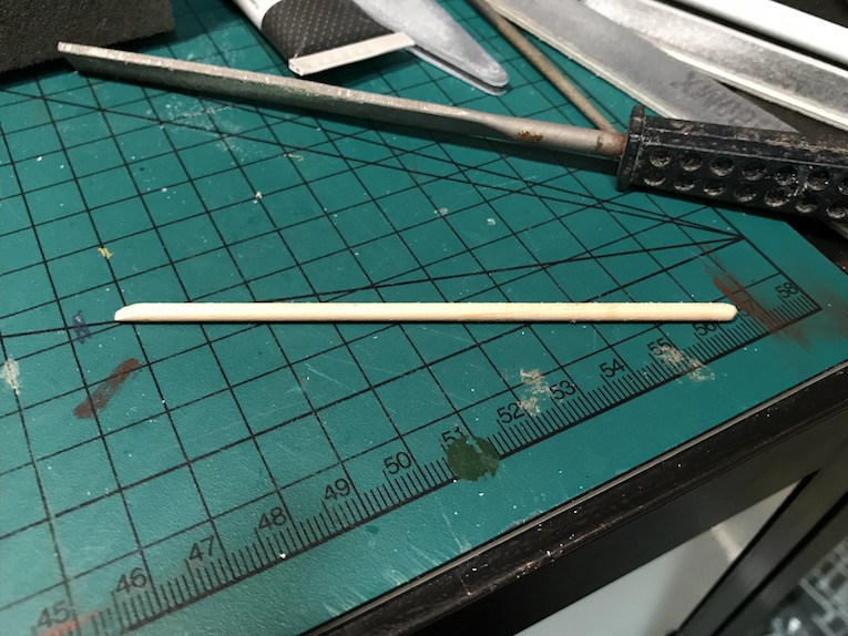

Block & Tackle - make your own tool, Cordage hook.
Hi all,
In this blog I am going to show you how to make a cordage hook tool that will cost you next to nothing to make saving you £5 on a shop bought one, and is actually better to useBigGrin
to make this tool you will need a wooden dowel about 5-7mm wide, a length of stiff wire .5mm, a .5mm drill, small amount of tape,a wire cutter, a fine saw and 5 minutes of your valuable time.
The photos below follow the steps.
Step 1. Cut a slot in the end of the dowel about 2mm deep, then repeat so yo have a cross.
Step 2. Drill a hole wide enough to take your wire in my case .5mm. the whole needs to be about 2cm from the top of the down where you cut the cross. the hole should be roughly in line with one of the slots.
Step 3. Thread the wire through the hole and check that it sits in the slot. You need about 2 cm of free wire remaining not threaded.
Step 4. Make a loop in the wire ensuring that the wire passes on the inside above the down as in the photo
Step 5. Push the wire that is on the inside of the loop into the slot.
Step 6. Next push the outside wire loop down into the other slot so that the wire is on top of the first section of wire in the first slot, bend the loop down so it does not ring back.
Step 7. Gently pull the free end of the wire so that the loop closes against the side of the dowel (this should be the bottom wire).
Step 8. Bend the free end of the wire up so that it is at a 90 degrees angle at the centre of the dowel, this should be against the top wire which is holding the bottom wire firmly in place.
Step 9. Form a small loop in the wire, I have used the handle of a needle file to help form the bend.
Step 10. take the wire cutters and cut the wire so that the loop becomes a deep hook. you want the hook to be wide enough to get your rigging thread in easily but not to short that the thread comes out easily when you use it.
Step 11. Bend the wire that is remaining from the hole to pass under the wire on the other side that travels from the hole to the slot and bend it back on its self to lock it in place.
Step 12. Finally wrap a bit of tape around the end of the dowel so that you dont cut your finger on the wire end.
Job done. this tool will allow you to grab and drag rigging threads from the far side towards you, or move them out of the way when working, it has lots of uses and the hook will work better than the hook on the shop bought one
All that remains is to wish all the followers of Scuttlebutt and my builds a very merry Christmas and a prosperous New year
#34 Posted : 22 December 2017 11:21:09
An interesting way of not having to buy the tool, though I would say that the dowel needs to be more slender.

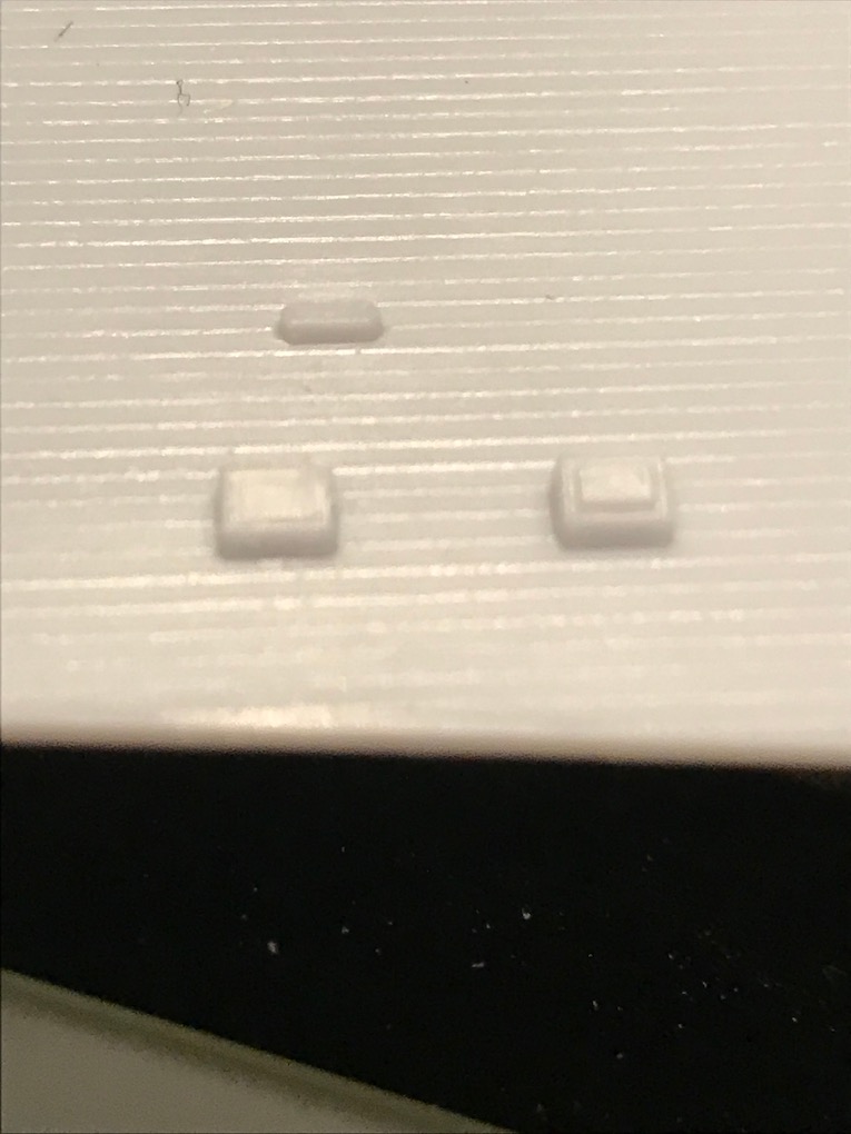

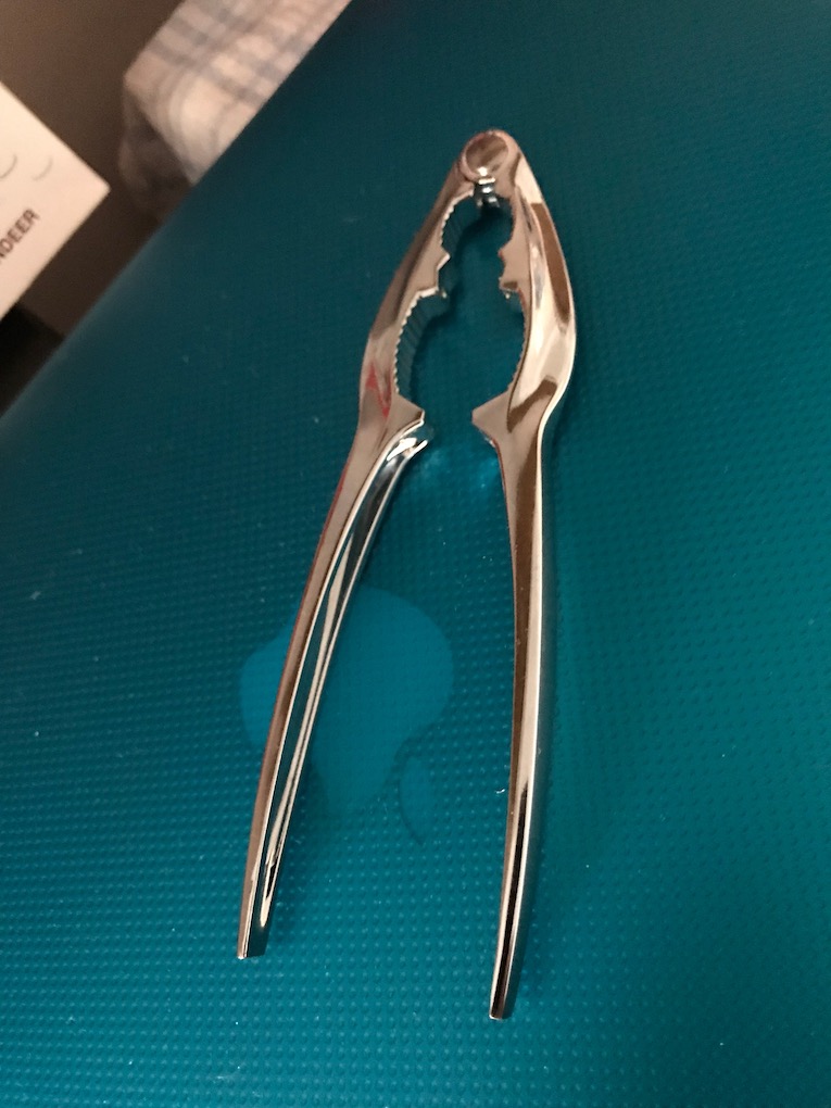

Bilge - The Christmas Scrounge.
So Tomorrow is Christmas Day, my favourite day of the year and an important day for us model builders...
Yes Christmas is a good day, Time with the family, a big dinner, maybe a family bond game, Dr Whoo special and no doubt a two Ronnie's repeat to, whats not to like. But its not the only reason I like Christmas. Us model builders tend to be a resourceful bunch and no doubt we have all put something modelling related on the Christmas list, But for me one of the best bits about Christmas is the opportunity for a bit of scrounging, there are lots of things about for the model builder to grab that could be useful in the hobby. hear are some of my favourite past grabs:
Packaging card, can be used for paint masking, its also good for shaming bulkheads that need building up on wooden ship kits.
Got a replacement electrical appliance? then cut the plug cord of the old one and strip it for the copper wire, so may uses in our hobby from making grab Handels to rigging or lashing cord, areas lots and lots of uses
the cable ties used for holding toys in boxes are great for holding things together while they dry, or even to bunch shrouds together before rigging them, again many uses.
I have used the clear agitate from packaging to be used as glazing
All those jar tops from making mince pies etc, are grate for decanting a bit of glue in or even paint mixing pallets.
I have cut the bottom off a 2.5 ltr pop bottle to use it as a water trough for decals
My favourite scrounge was 2 years years ago I grabbed a nut cracker, its such a good tool for removing stubborn paint, glue and any other screw cap, there is nothing I struggle to open with a nut cracker.
If you have ever scrounges something really useful I would love to hear about
#36 Posted : 25 December 2017 00:11:11
One this I tend to save and use a lot and that's the screw tops from milk bottles. Give em a wash out and they're great for decanting small quantities of glue, once the glue has dried you simply bend the top and most of the glue comes away allowing you to reuse the top.... Throw away and use another when the old one is past its best..... no expense spared.....BigGrin BigGrin

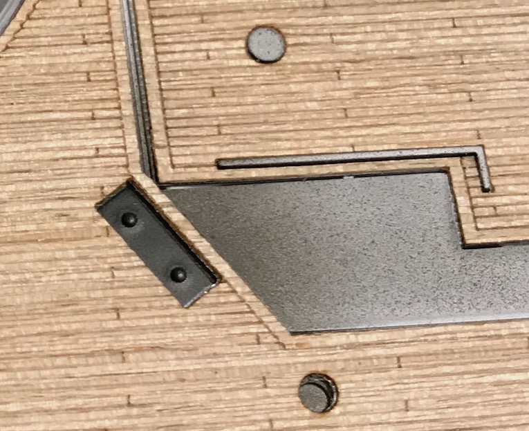

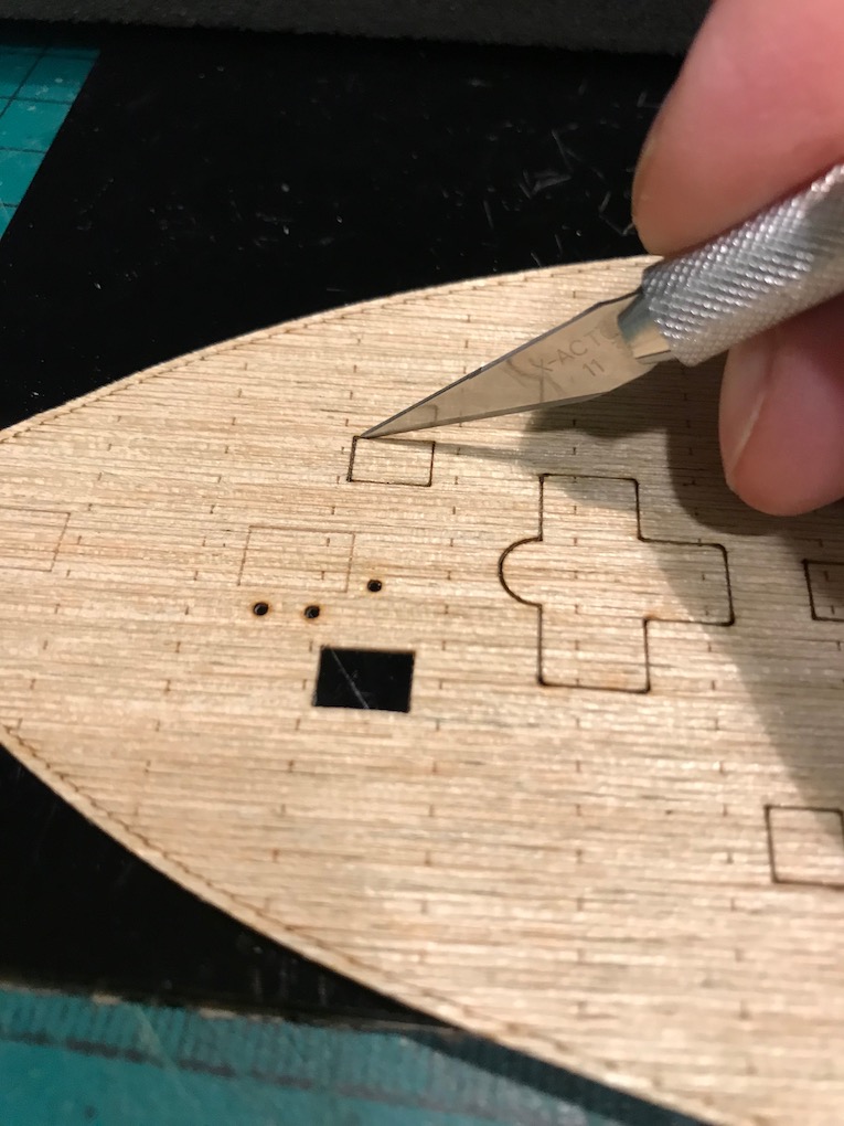

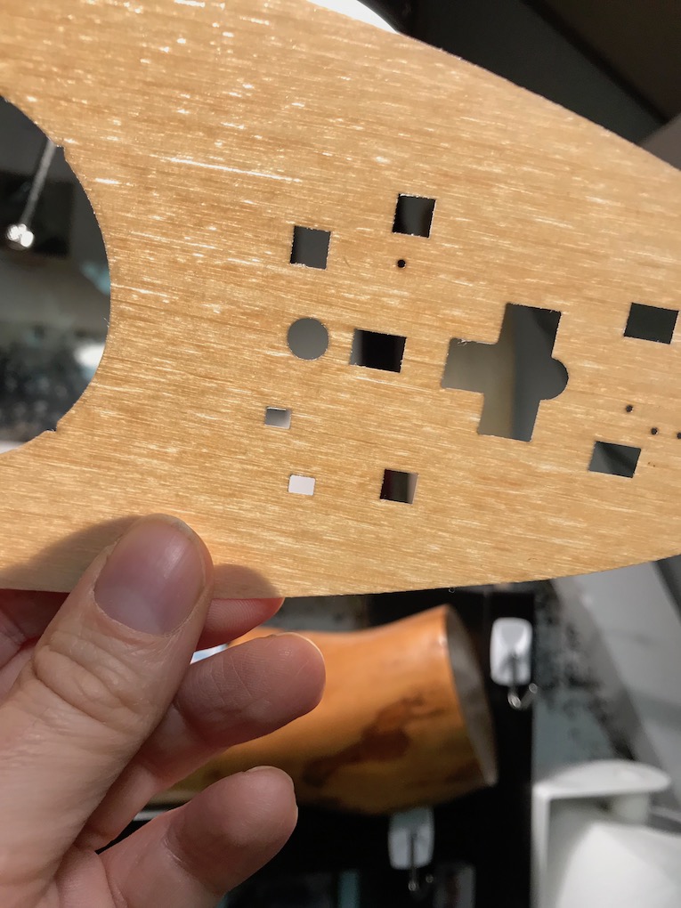

Crows Nest - Laying laminate wood deck
Real looking wood decks are becoming an increasing future of the model builders arsenal when looking to improve the look of their plastic model ship. the idea is simple enough but actually applying them is a bit more tricky.
This is how I go about adding laminate wooden decks,
The first thing to think about is a tool for ensuring you have the edges down properly, to my knowledge no such ting exists, so you need to make one. Basically you need a rounded end for pressing down larger areas and a narrow point end for in between small raised details.
I have made one out of some 3mm dowel. simply sand one end to form a chisel flat and round of the other end
With your tool in hand we are ready to go
1. remove the deck piece from the sheet. its very tempting to just pull the deck pieces away but its possible to rip the deck. It is best to take a new blade and run it around the cut edges trimming through the tabs as close to the edge as possible. do the same with any sections that may need cutting out from within the deck piece. note some decks may have markings on them for positioning other parts, these should not be cut out. sam pin holes can be just pushed through with the point of the knife.
2. Check. hold the deck to the light and check you have tried away all the tabs. you only need the tiniest bit of tab left for it to cause deck misalignment.
3. Prep the deck, check what needs to be done to the plastic deck anything need removing or modifying for etch then do this first. then paint any of the deck detail that will protrude through the deck once laid.
4. Test fit. Before removing the backing film it is important to orientate yourself with the fit. you can only remove the deck once at most if you get it wrong so a test fit will help ensure you understand the fit. Check that all the holes clear ant raised points in the deck and that any location holes are lined up.
5. Carefully peel back the backing film using the edge of a sharp blade to separate it from the deck. it is very important not to touch it with you fingers as the adhesive backing has a lot of grab but once soiled loses its adhesion quickly. I use the point of a cocktail stick to hold the deck down while I peel off the film.
6. now comes the tricky bit. VERY IMPORTANT DO NOT APPLY THE DECK AT ONE END AND ROLE IT OUT. If you do this you will slowly move the deck out of position, it will snag on raised detail and the deck will not go down correctly. the way to fit the deck is to lower it into place evenly and level all at once. hold the deck over the plastic deck and lower it on. normally it will go over a turret barber first then gradually over other detail. once your about 1mm above the plastic deck, check your edge alignments and allow the deck to natural fall, it will make contact in some areas not in others.
7. fixing the deck. Start from the middle of the deck and and push it down with you finders first. as you get to parts of the deck that butt up to an edge use the chisel end of your tool to push the deck down. any holes in the deck should be gently pushed down using the rounded end of your tool, apply just enough pressure to make the adhesive grab, if you press too hard you can damage the deck.
8. Hopefully all went well if not you can carefully peel back the deck and try it again, but you won't get a second chance the adhesive will be ruined after that. if some of the deck is not quite sitting correctly a sharp no 11 blade can be used to trim deck. if an edge of the deck is not staying down apply a small amount of CA onto the plastic deck and weigh the wood deck in place until the glue dries.
