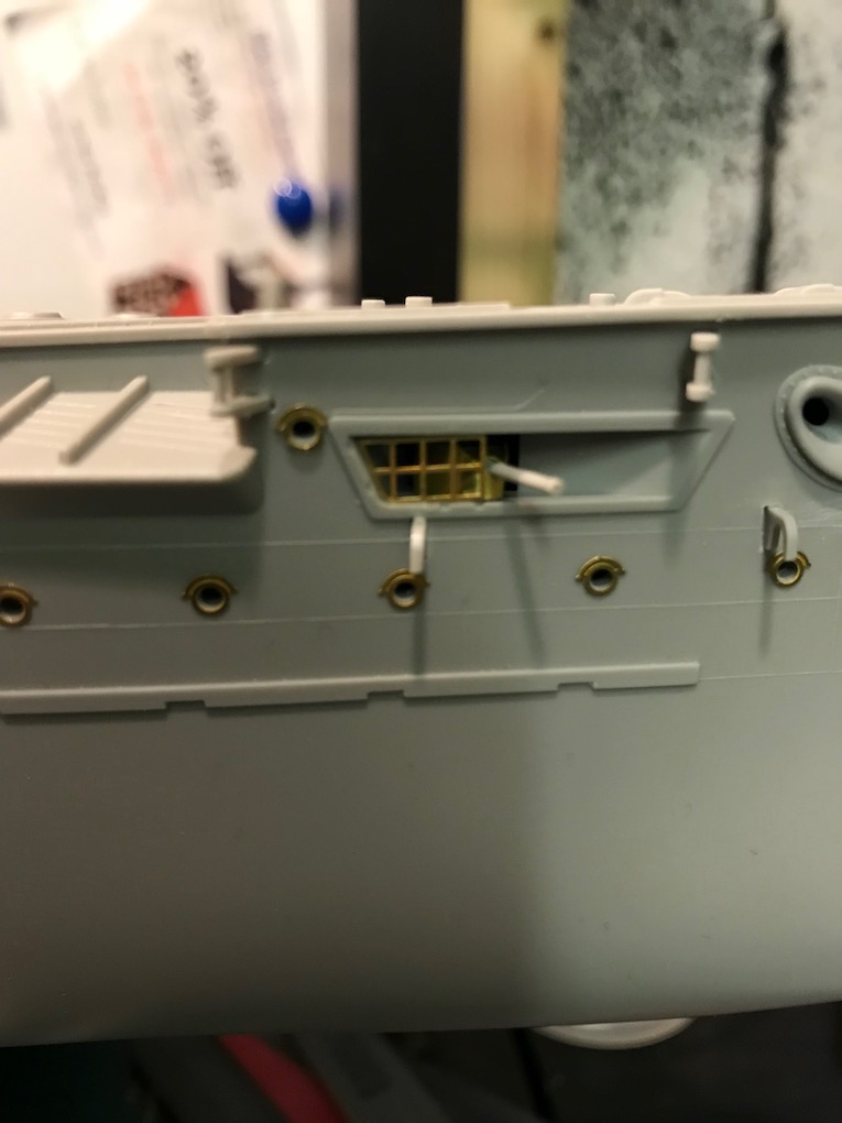

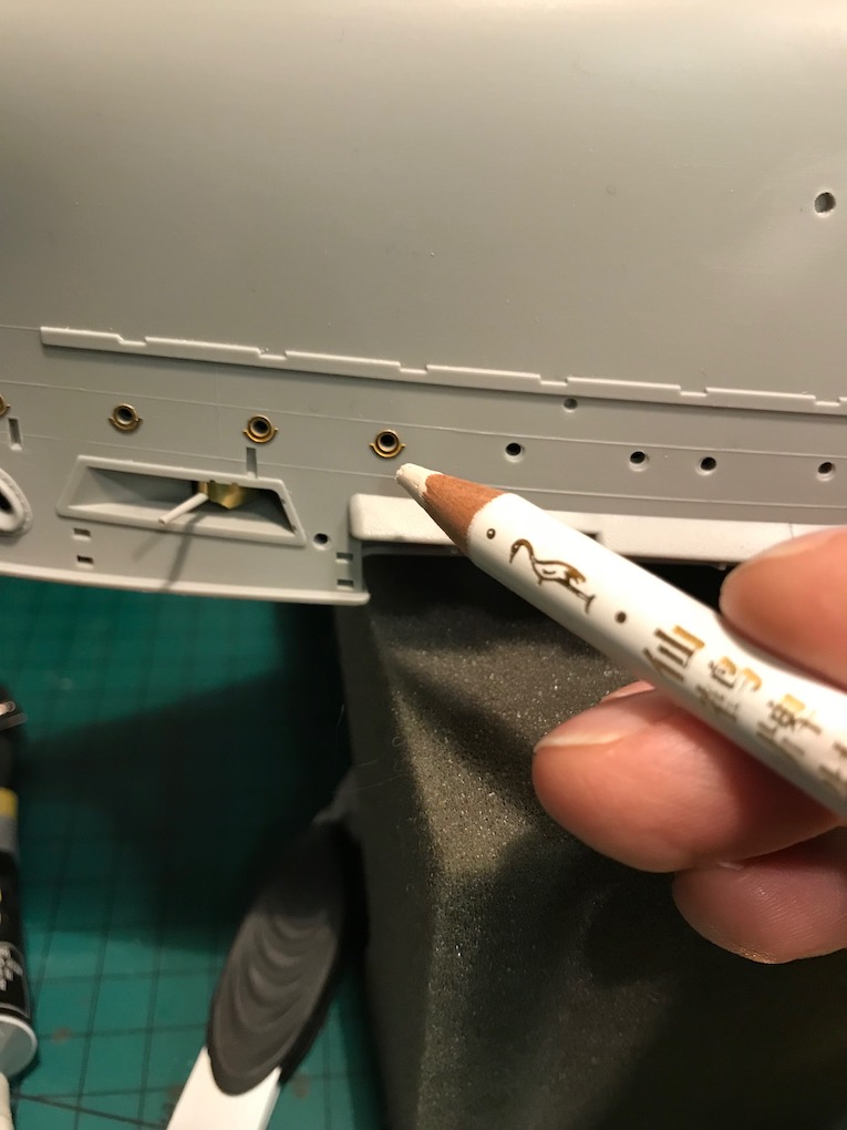

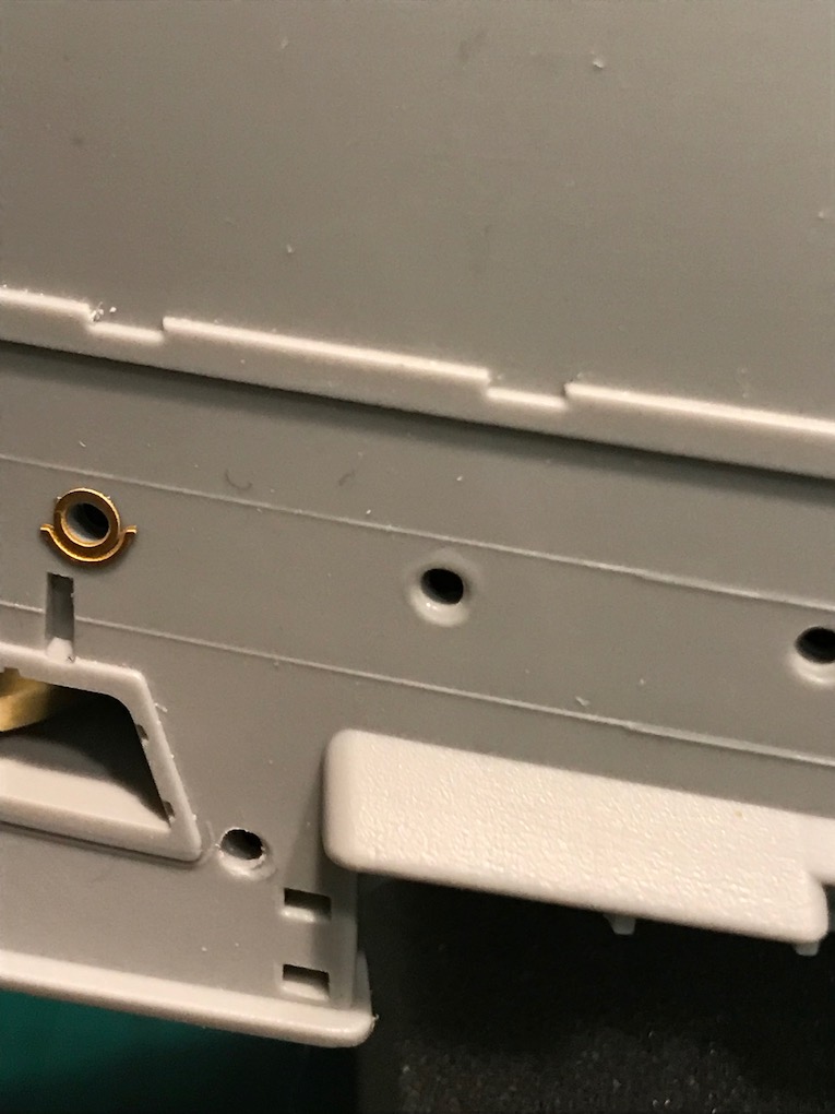

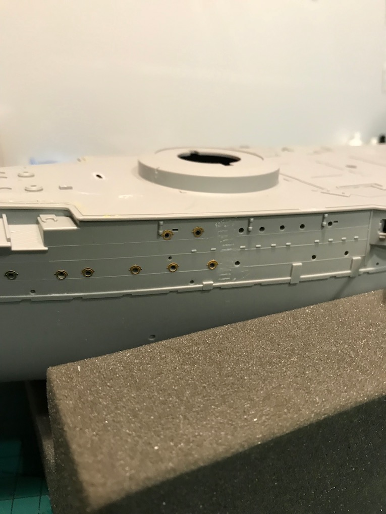

Hull Construction Part 3, Scuttles part a.
Adding etch scuttles makes a big difference to the look and feel of a ships hull, even if you have drilled out the scuttles. Comparing picture 1 and 2 you can immediately see depth of detail the etch brings.
The process of adding the scuttles is relatively simple if not a little repetitious. The scuttles are carefully removed from the fret using a sharpened No. 11 blade.
A small amount of medium CA glue is decanted into a stable container, I use a milk bottle top. I use a length of fine wire in a pin vice to apply the glue around the edge of the drilled out scuttle as in picture 3.
I use a wax etch placing pencil to pick up the part and, with a steady hand, place the shuttle in place, taking care to keep an eye on the parts orientation; as in pictures 4, 5 & 6
Some of the parts need to be trimmed to fit. any scuttle that looks like it may foul is dry fitted first and then trimmed as required, this can be done with the same No11 blade. See picture 7
So as not to lose the scuttles removed from the fret I tend to do a small number at a time, completing a section of the hull at a time.
Thanks for looking in

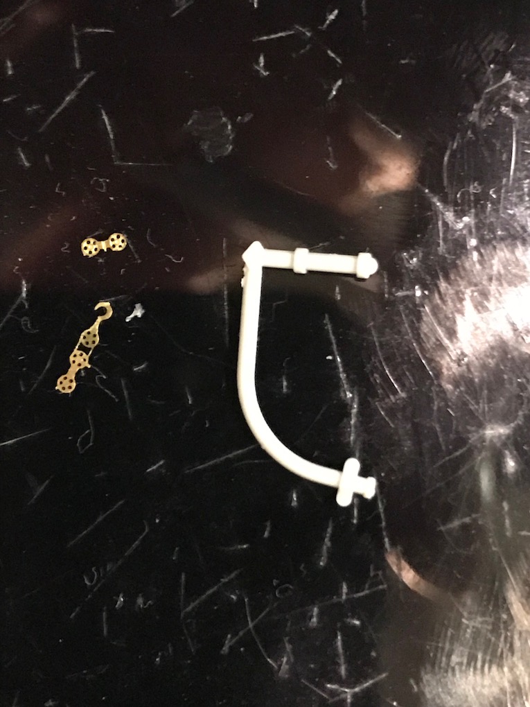

Hull Construction part 5. Davits.
As I progress along the hull there is the occasional folded davit that needs to be fitted before scuttles can be added.
the kit parts have two circular blobs to represent the hook and pulley but the etch update set has this covered. Photo 1 shows the kit part before modification to allow the addition of the etch and the 2 etch parts used. the two parts fold to make a thicker pulley wheel.
the two moulded on pulley wheels are just snipped off with a sharp blade.
the etch was folded with tweezers, I did not glue the undersides as the glue used to attache them to the davit are will be enough to hold it all together.
I found it easer to attache the davit to the hull before attaching the pulley wheels.
The finished effect is excellent
