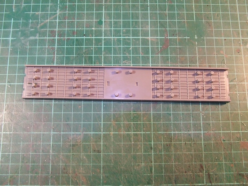

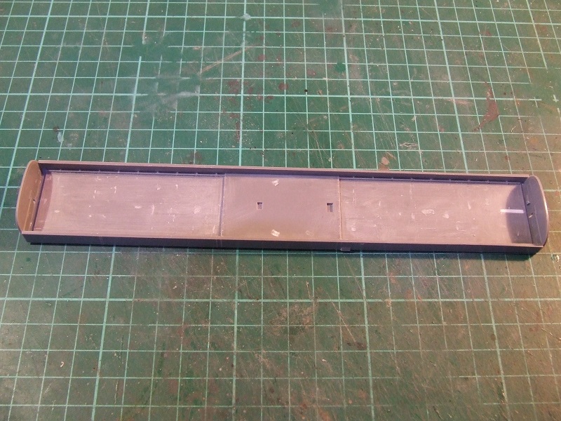

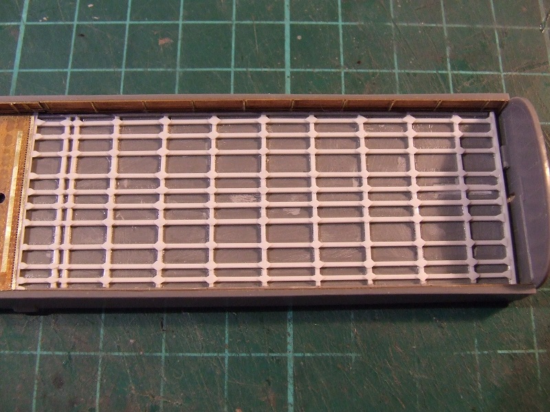

Hello all,
Time for my first update with some actual building to show.

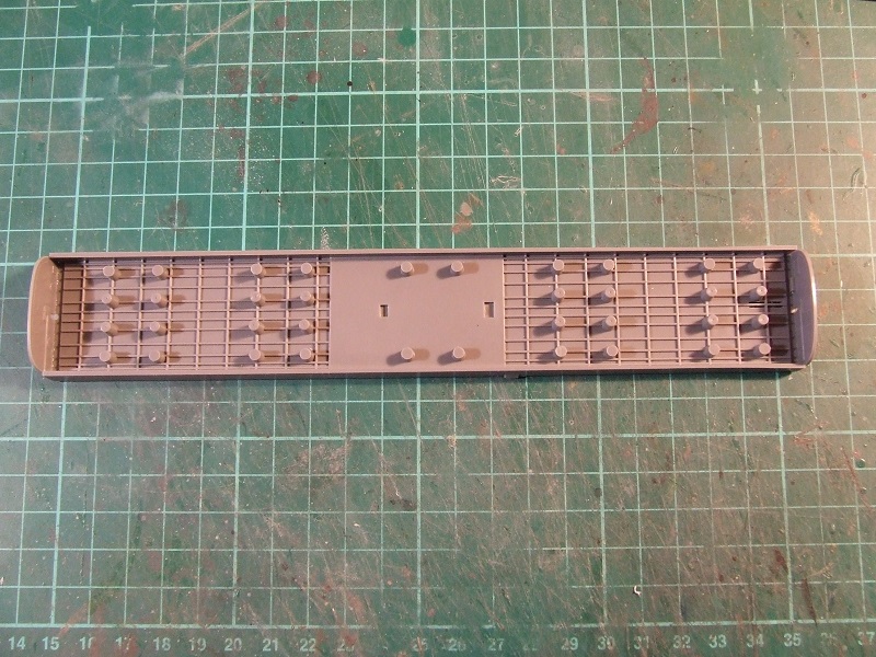

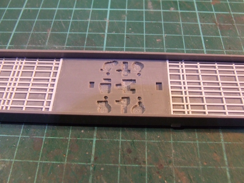

I was going to start with the cockpit and interior as is the normal sequence with model aircraft kits. However, the floor to the cockpit and forward interior also doubles as the roof to the bomb bay on the underside as can be seen in the first two photos below. This kit although a recent re-release is based on the old 1976 moulds and as such is a little basic in places. Such is the case with the bomb bay which although it has some of the airframe structure moulded integrally, also has some rather strange cone shaped pedestals to which the bombs are supposed to be glued. These needed to be removed and replaced with something more realistic and accurate! I didn't want to fit all of the interior items on the upper side of the floor and then have to do major surgery on the underside to correct the bomb bay faults so decided to tackle the bomb bay first and I can then just tape the bomb bay doors temporarily in place to protect my work whilst fitting all of the fuselage interior at a later date.
So, after gluing the front and rear bulkheads in place, the awful pedestals and all of the moulded structure was removed with micro chisels and scalpel and the remaining flat areas sanded, then any marks filled with Mr Surfacer 500 and again sanded to get them perfectly flat. I then had to spend countless hours rebuilding the structure from 0.5mm square sectioned plastic strip. The longerons were fitted first then the cross braces were individually cut and glued in place. Reference was made to photos of the real bomb bay for placement of the cross braces. Some narrow strips of 10 thou plastic sheet were then added where the structure meets the centre panel. I will also be adding small diamond shaped 'fishplates' across the top of all joints between the longerons and cross braces as can be seen in photos of the real bomb bay. I will then be making some scratchbuilt ribbing that runs along the inside edges of the bay and then there is a lot of pipework and PE brass bomb bay parts to be fitted. More of that in the next update.

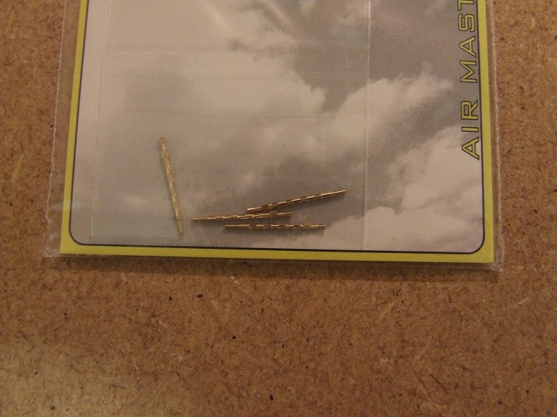

I also tooh delivery of two more reference books and some machined brass replacements for the .303 Browning machine guns, all of which can be seen in the last four photos below.
Thanks for looking, all comments and criticisms welcomed.

Very nice start Kev.
Those master barrels are incredible. I purchased the same brand for my kit. So much detail on such small parts.
#26 Posted : 14 January 2018 23:18:54
lovely bit of scratch building and looks all the better for, nicely done that manCool

Nice start Kev, a definite improvement on the bomb bay.
#30 Posted: : 16 January 2018 14:20:08
Thanks for looking in and your comments Graeme, very much appreciated. Yes, a worthwhile improvement though plenty more detail still to add to the bomb bay yet. Cool ThumpUp

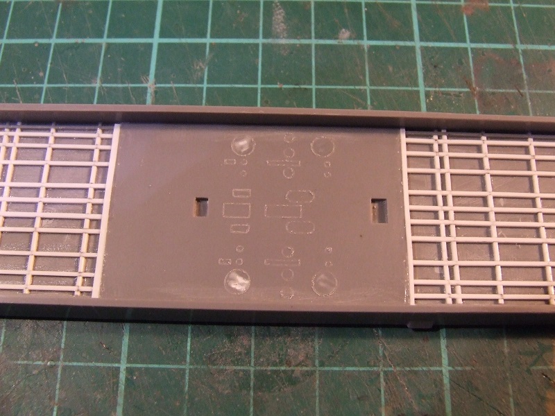

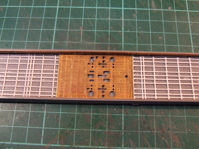

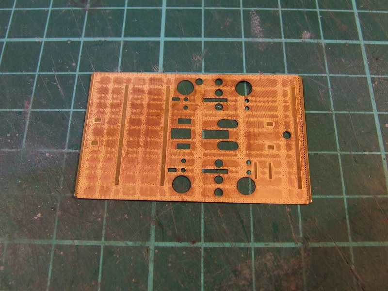

Hello all,
A bit more done to the bomb bay conversion. Doesn't look much but there's a lot of work gone into the few photos below! Blink
I've started adding some of the PE parts from the Eduard Bomb Bay set, the first being a large plate with lightening holes that sits almost centrally along the bay and is the area where the large 'Cookie' bomb will sit along with a few standard bombs. Looking at photos of the real bay, the airframe beneath these holes is hollow, though Eduard suggest just gluing the plate flat against the kit plastic. I decided to enhance this slightly so used the plate as a template, marked the holes with a scriber and spent several hours removing material with micro chisels and then brushed a little Tamiya 'Extra Thin' liquid cement to smooth off the rough edges. It all still looks a little rough at the moment but when painted won't show as anything other than a few holes in the bomb bay roof?
Next job was to add some long PE plates along the sides of the bay, three on each side, which contain some missing details and cabling. I will be adding more scratch built pipework and some ribbing on top of these plates.
After that I've started to add the small diamond shaped 'fish plates' that sit on top of the rib intersections as can be seen in photos of the real bay? Probably unnecessary, as most of it won't be visible when the bombs are fitted, but some of it will and it's added detail anyway! Several hours were spent cutting small diamond shapes from some 10 thou plastic sheet and carefully gluing them in place. They were all cut by eye, so may vary slightly in size but not much and I don't think it will show when painted black? The last photos show the end effect with one half of the bomb bay having these plates added and the other half yet to receive them. I think it is a nice improvement to the overall look of the ribbing?

#38 Posted : 20 January 2018 15:03:08
Very nice update Kev.
Its as you say you can spend an age on one tiny area and it looks like you have not gone very far but then suddenly all those small sub-assemblies all come together and your almost there.
Hope it continues well.
#39 Posted : 20 January 2018 15:52:44
Great work on the bombay Kev BigGrin regards PhilCool
#40 Posted : 20 January 2018 16:28:00
Posts: 7,287
Points: 22,168
Some lovely work on the bomb bay. Love
