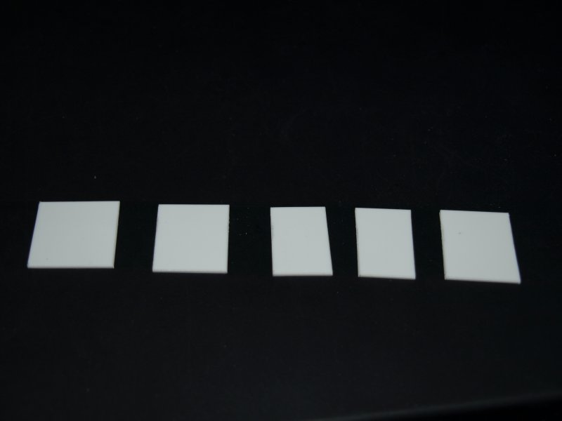

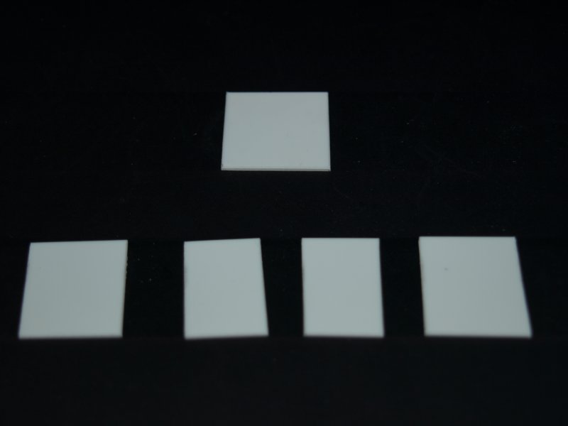

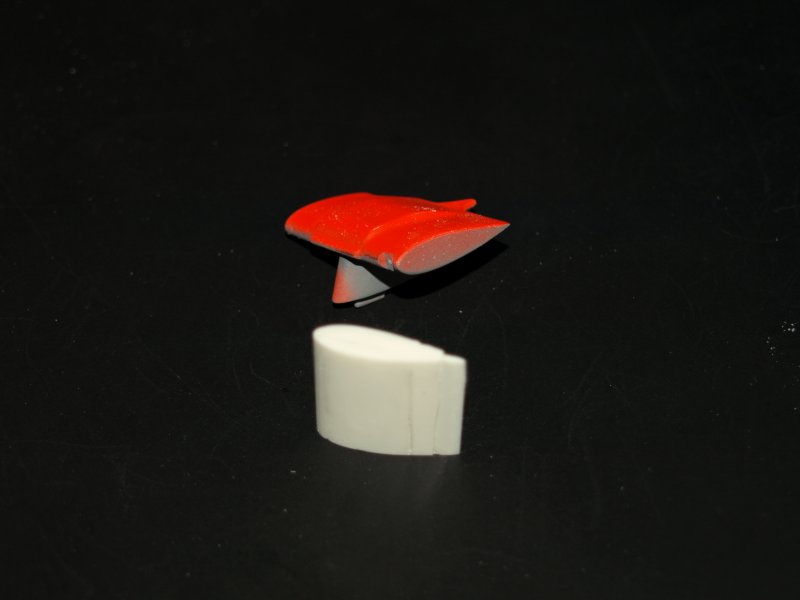

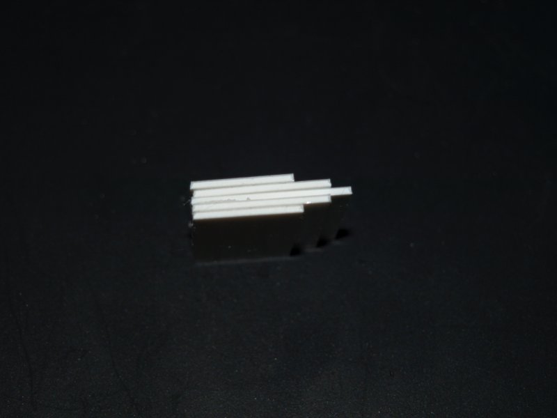

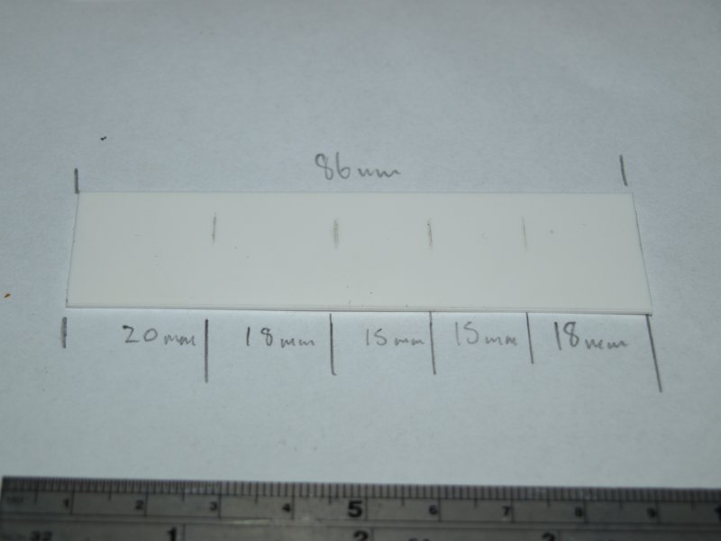

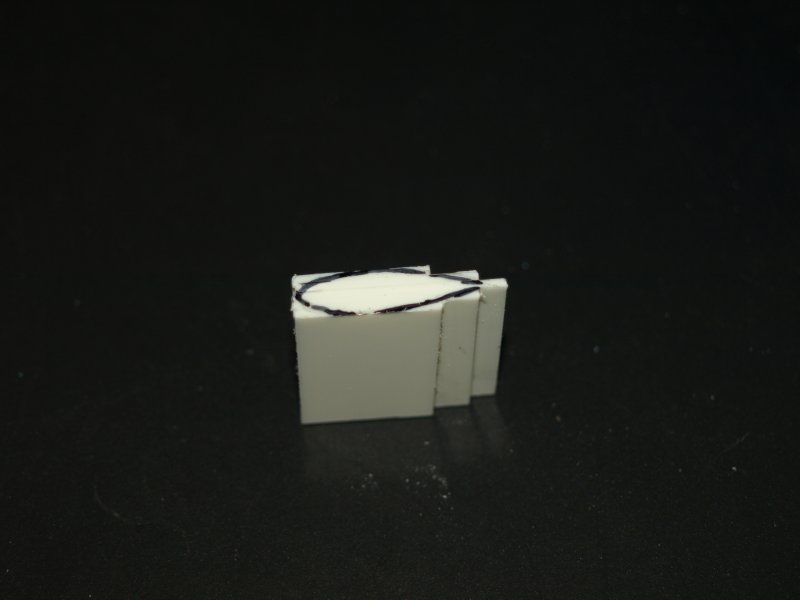

Ok this is how it's done
1mm plastic card cut to a lenght of 86mm X 20mm wide
Mark out the lengths as shown.
Longest is the middle sandwiched beetween the other 4 as shown. Wait for glue to dry for at least a few hours then sand flat one side. Use this flat edge as your template of the "aero" effect ( I'll show these later)
Start to file down the leading edges and use the original Top Camera pod as a guide so to get the right form..
Bottom pic is with carbon decal on top..needs bottom decal then coat of lacquer

I use needle files and a material called "MicroMesh" it's like sand paper but cloth so its flexible.. been using it for over 10 years and never wears out. Use with water like "wet and Dry" sandpaper... Final pic is 1/2mm plastic card wrapped around Camera box to give "raised detail.. This will then be primmed and then carbon fibre added then Lacquered.. once the main airbox part arrives then the other side will be filled etc to fit.. I'll do this by adding a few pins and then 2 holes drilled into the side to attach.. I'll add more as ai go along and I hope you all don't mind me adding these to this thread?
