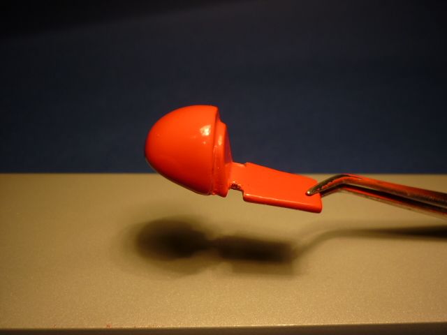

#23 Posted : 26 September 2012 20:38:56

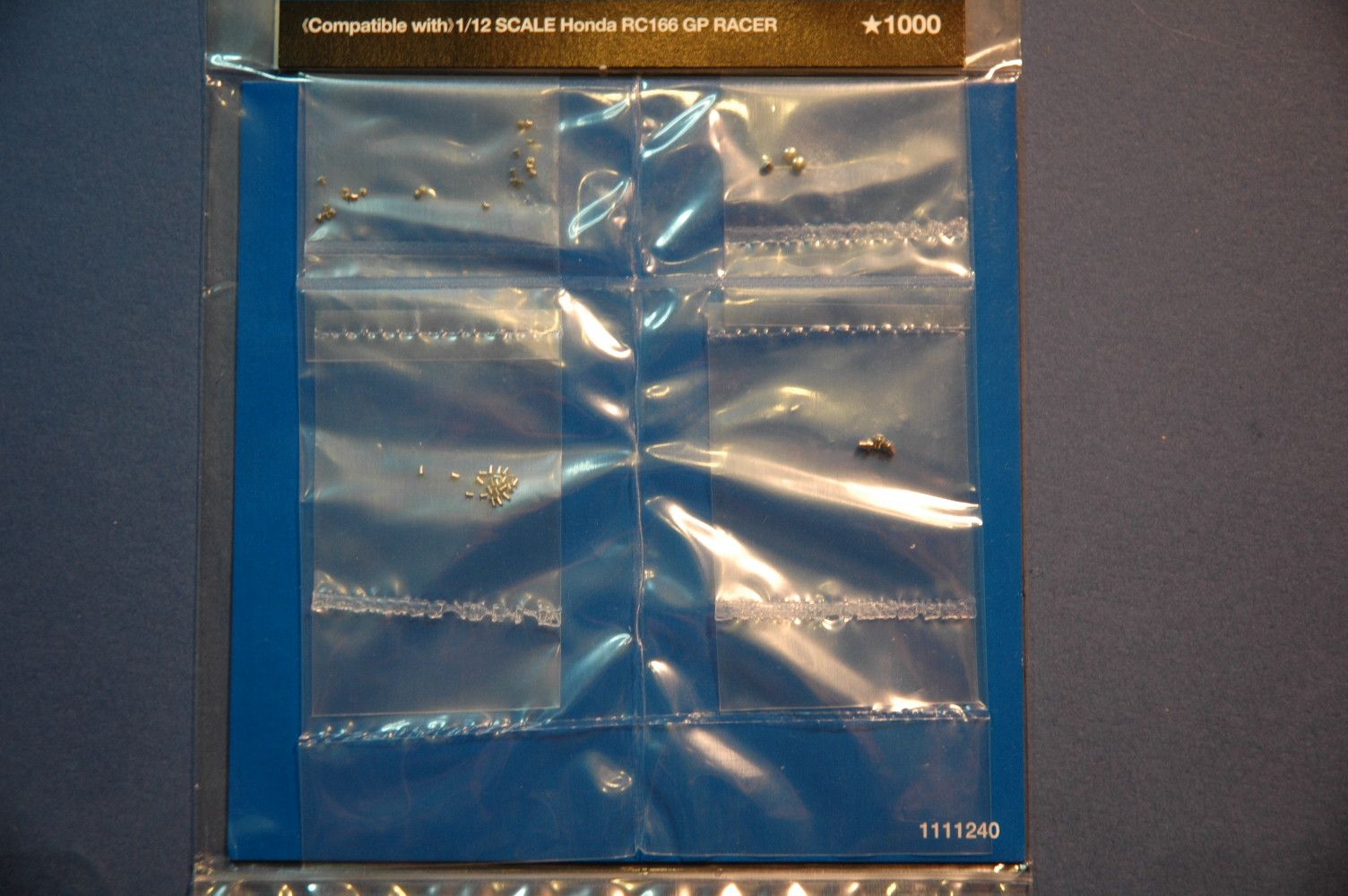

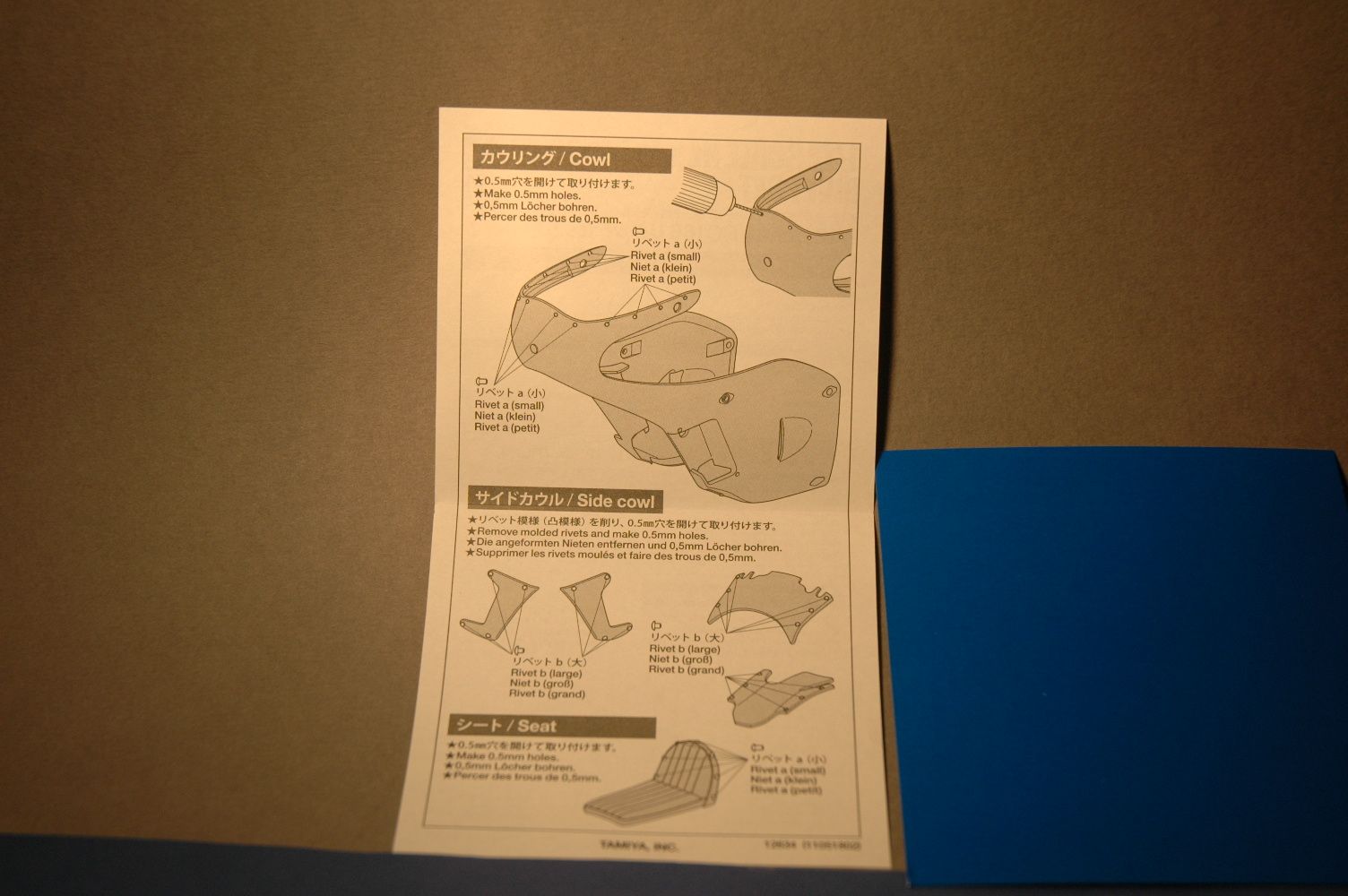

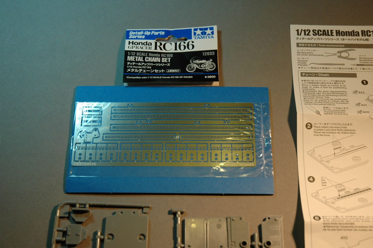

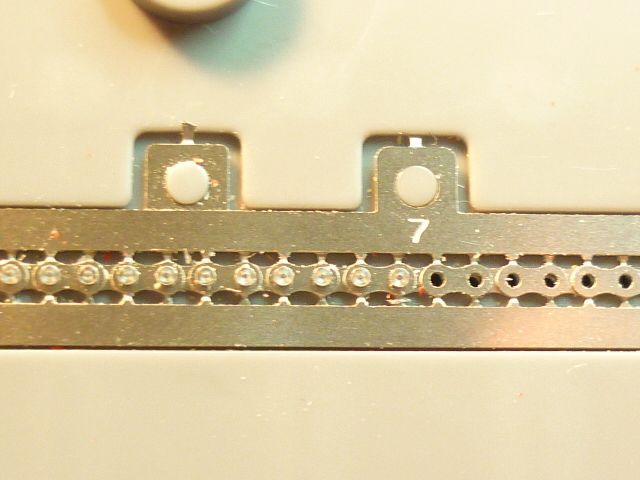

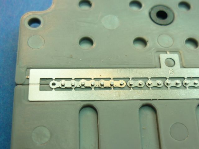

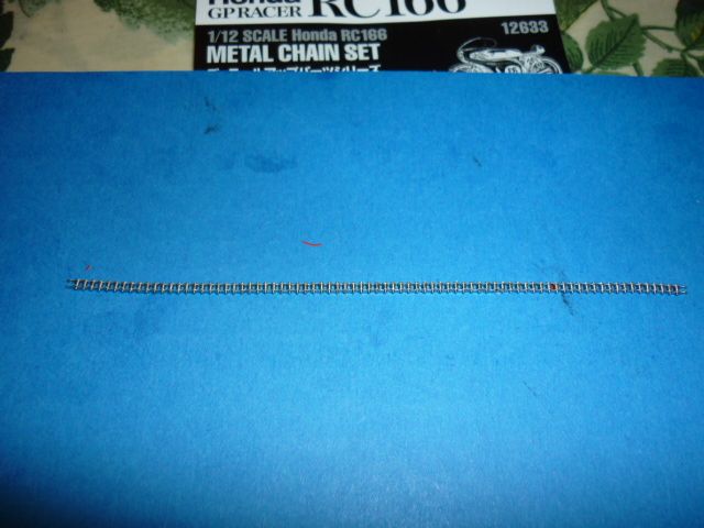

Hi all,

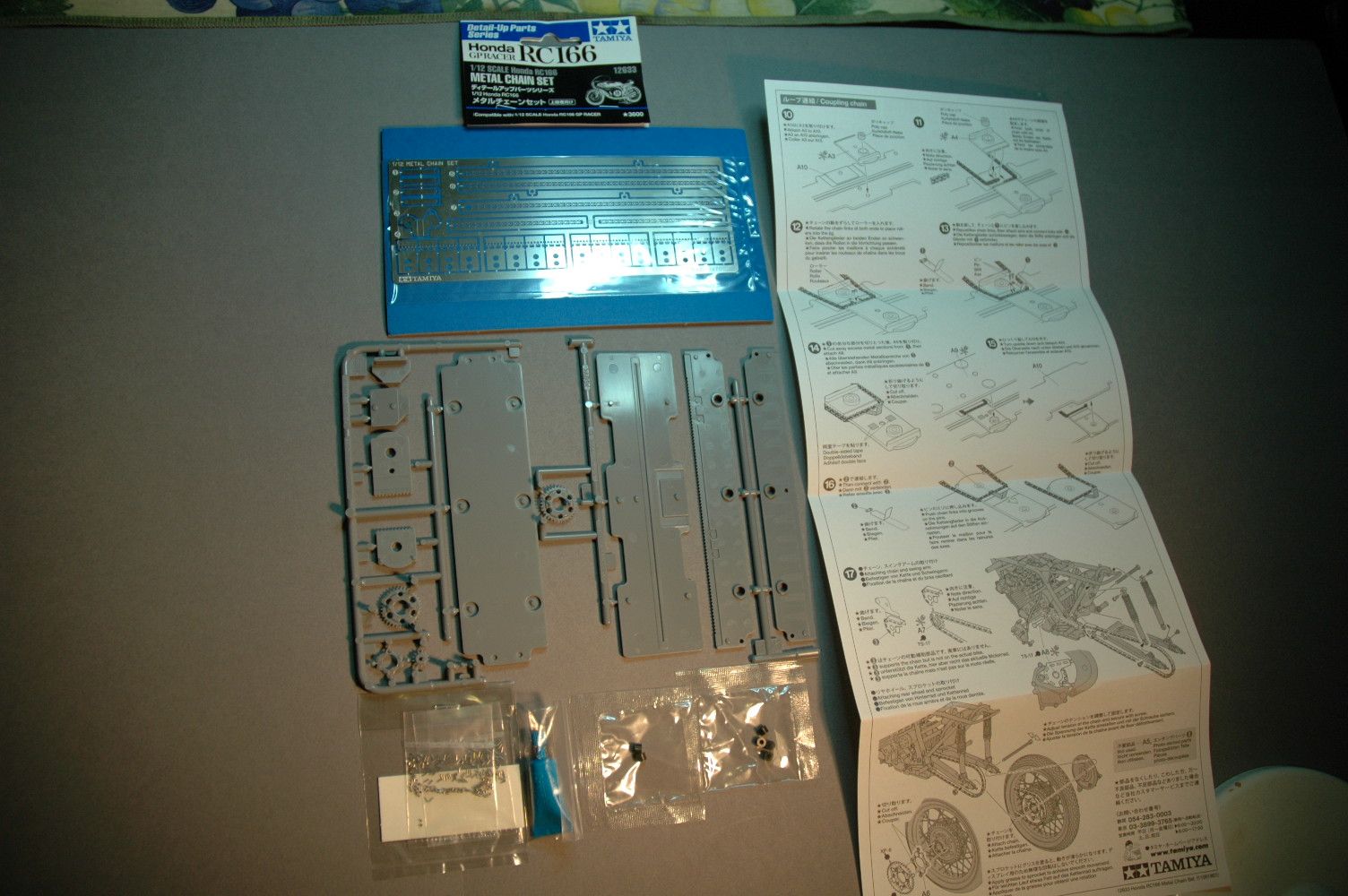

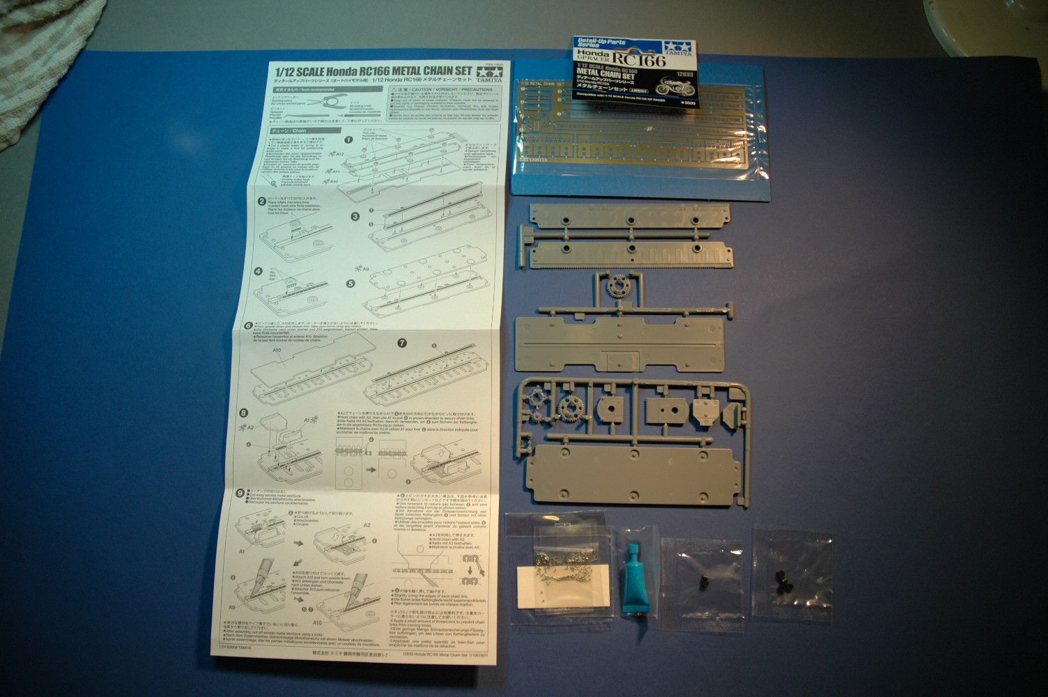

Today I received my final parts for my Honda RC166 looks like I will be very busy fitting all the parts.
The first pictures are of the metal Chain Set all though there are some plastic bits.

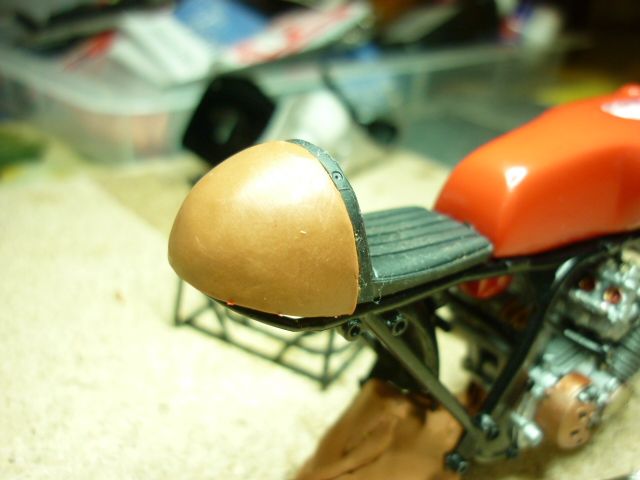

The next set of pictures are of the Seat and Cowl Rivet Set,now the reason that I brought the Seat set was to try to get around the problem I have with the rear seat,I mention in my last post that I felt the seat look to small against the black rubber mould,thinking the rivet set would solve the problem but looking at the upgrade I think not.
Now I wonder what you think,the only way is to build the seat up to the or near to the top of the rubber mould,this can be accomplish by using White Puttey, making a gauge sanding down and re-spraying.
Regards Trev.
Thanks for your Time.
Trev.
#24 Posted : 26 September 2012 21:13:13
BigGrin Hi Trev
Some impresive add ons you have there that should make an excelent model and very nice work as ussual,i think the only option you have with the fairing is to build it up to the correct height.

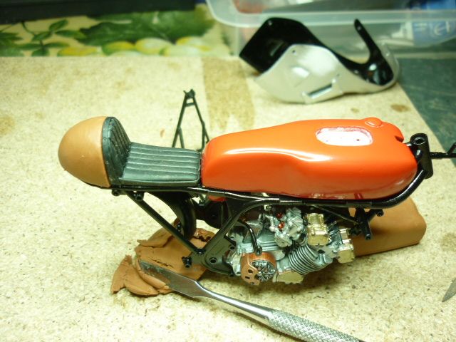

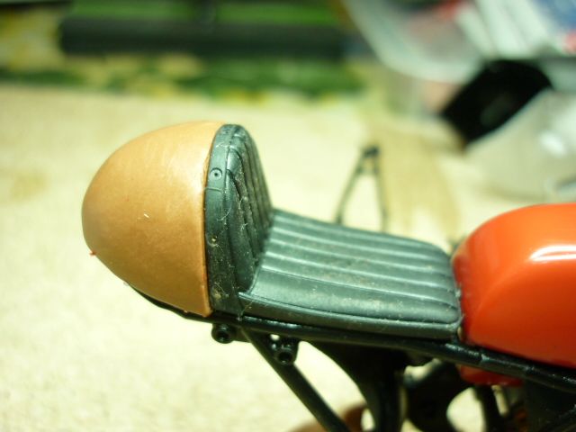

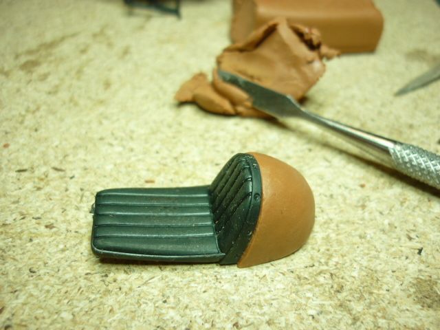

#27 Posted : 29 September 2012 00:15:15

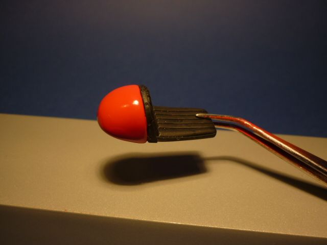

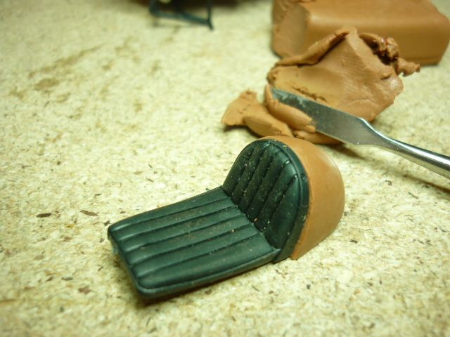

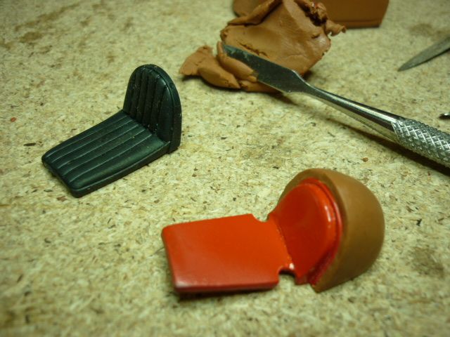

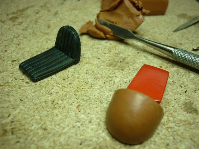

Hi all,
Can I just say thank you all for your comments, all so thanks to Rob for guidance to a picture on wikipedia which helped me re-shape the rear seat.
If you look at me new post you will see what I have done,I think when I re-spray it will look ok.
1st Picture mixing the clay.
2nd Picture Re-shaping the seat.
3rd Picture Smoothing seat for Re-Spray.
4th Picture Rubber Mould fit.
5th Picture Rubber seat fit.
I will post more pictures when I have re-sprayed the rear seat,I hope it will match the shade of the tank other wise there will be a shed load of work.
Regards Trev.

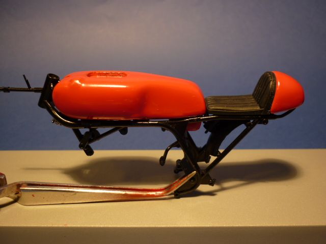

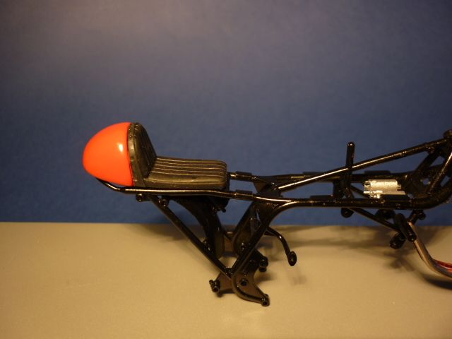

#29 Posted : 04 February 2013 23:20:27

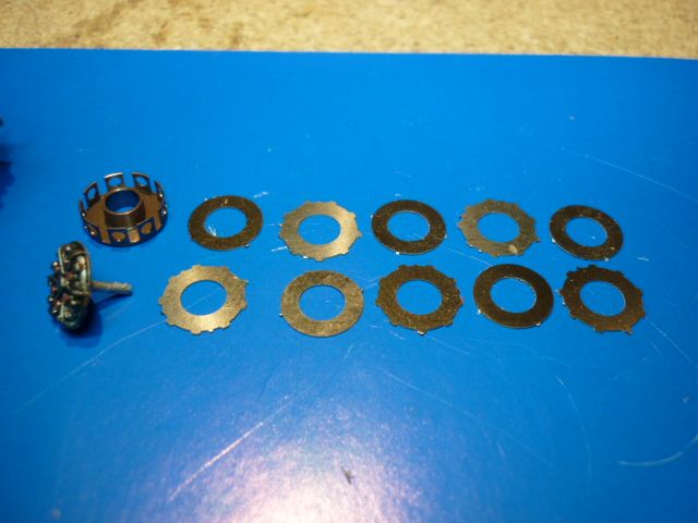

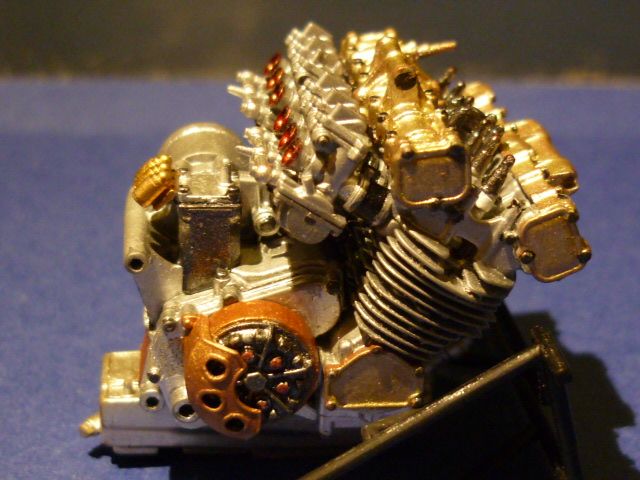

Hi All,
Just having a rest from copper plating the Victory,so I carred on with the Honda seat I have rebuilt and resprayed the seat and fuel tank.
The next pictures will the making of the very fine Chain and fitting the five plate clutch.
Regardes Trev.

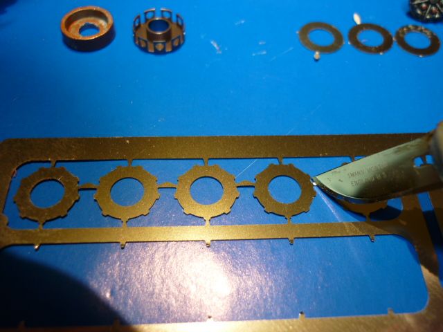

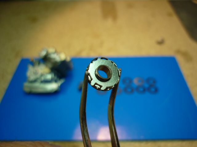

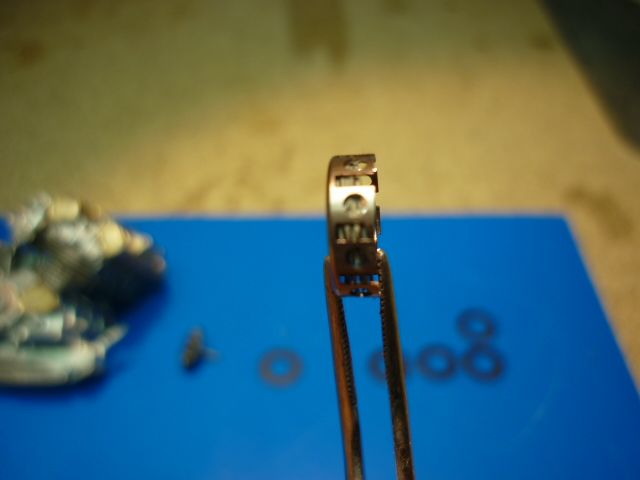

#30 Posted : 07 February 2013 22:13:33
Clutch Assembly,
First picture clutch as kit.
Trev.
#31 Posted : 07 February 2013 22:18:32
Wow what a difference!! How much more to do before it runs?BigGrin Being a mechanic by trade and a bike owner, I can really appreciate the work and the detail it has added!! Superb!BigGrin BigGrin
#32 Posted : 07 February 2013 22:56:56
Hi Nemesis,
Thanks for looking,can't wait to show you the metal chain assembly it took all day sunday to assemble.Have a look at the chain pins and rollers.
Regards trev.

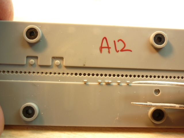

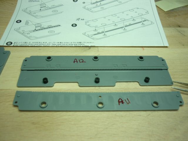

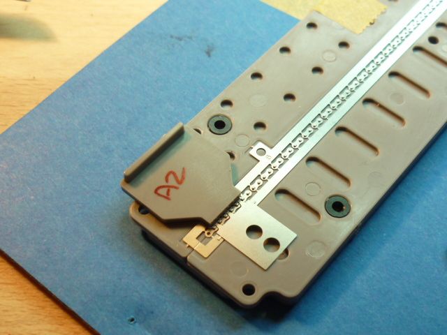

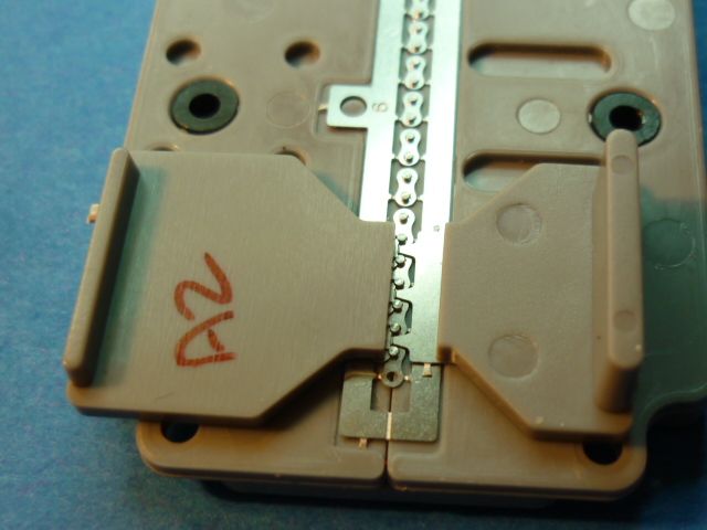

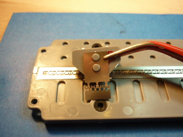

#34 Posted : 09 February 2013 10:37:46

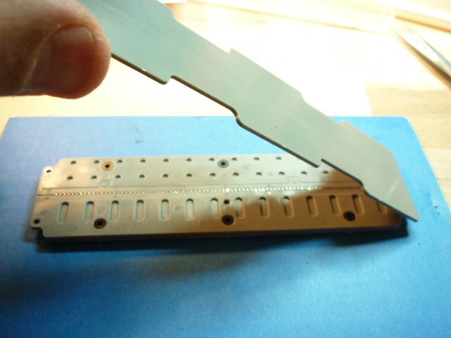

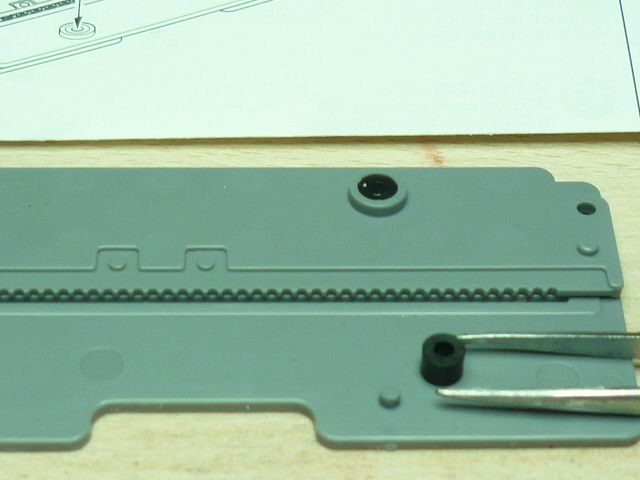

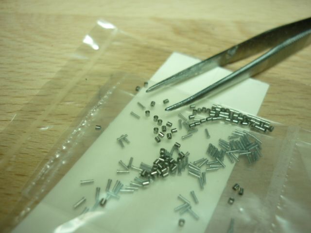

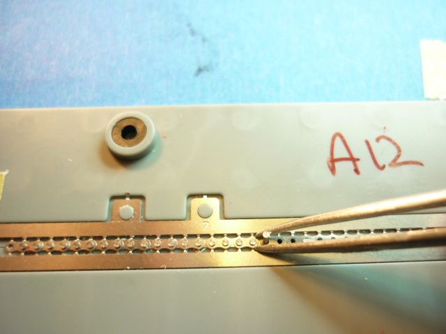

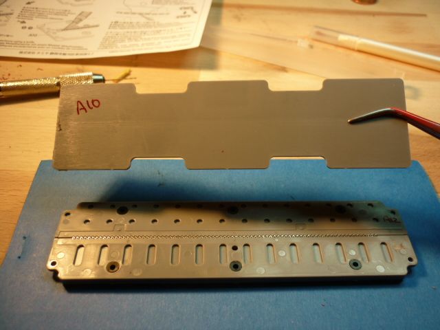

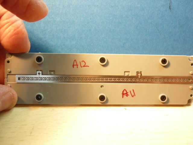

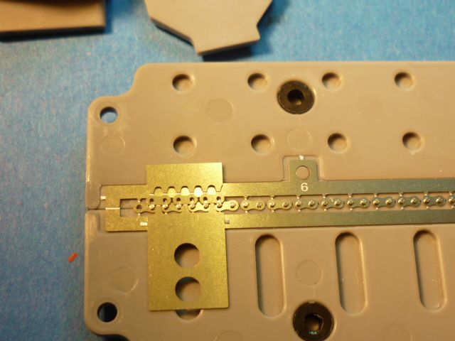

Assemble of metal Chain.
Assemble Jig.
Assemble of rollers.
Adding rollers.
Adding links.
Adding pins.
Turn over and repeat.
Add links.
Bend back and remove.
Remove chain.
Next job Front Fork's.
Regards trev.
#35 Posted : 09 February 2013 10:45:30
Now that is very clever, and what a superb upgrade!BigGrin And I thought some of the Friul tracks were fiddly!!Blink BigGrin It will look perfect when fitted, as it will add some weight and sag really well. Is the rear wheel adjustable so you can tension the chain? Brilliant build, I love it!!Drool BigGrin
Nem
#36 Posted : 09 February 2013 11:10:49
Nem, I thought you would like the chain kit,so yes you will be able to adjust the rear wheel,when I have to adjust!is the tension at the top or bottom of the chain?.
trev.
#37 Posted : 09 February 2013 11:19:57
BigGrin Hi Trev
wonderfull work there ,now that jig for the chain is very clever and a must to stop all theCursing Angry Crying . Keep up the good work and the pics coming
#38 Posted : 09 February 2013 11:30:31
On a full size bike the chain is adjusted with the tightest point of the chain at the bottom and a certain amount of slack is required at the top (depends on manufacturer). The measurement is usually between the top run of chain and the swing arm, my Hayabusa is 20-30mm free play. On the model I think it will be down to a small gap between chain and swing arm, but it will be trial and error as to what looks right. But with the weight of the chain you will get sag, and that will give it a perfect look when its done!! I love it!!BigGrin BigGrin

Thanks for looking and your comments,I think that jig was a clever way to construct (the only way) the chain,you have got to hand to Tamiya.
