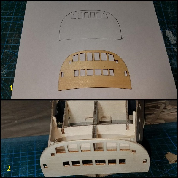

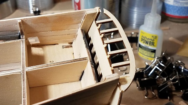

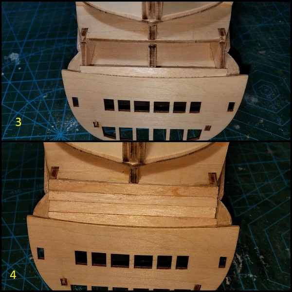

Located the Transom (part 34) and sanded the edges and surface. Before attaching the transom to the stern of the ship, I traced a window template for use in a later step (pic 1). I then glued the transom in place on the stern (Pic 2).
Using the 5 x 2mm planks, I covered the lower area of the aftercastle (Pic 3 and 4). The first plank needs to be shaped to match the curve of the transom.
Now on to more planking. LOL

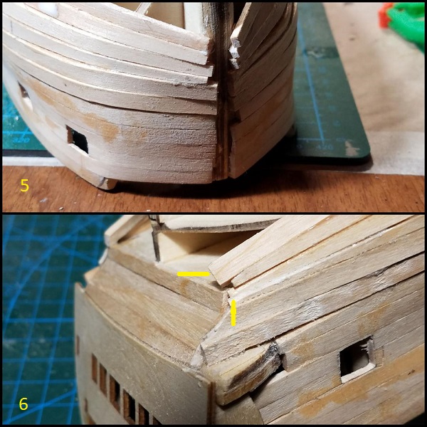

Step 10a
Step 10 deals with finishing the planking of the lower hull. I'm going to split this step into sections for the log purpose. I start off by fitting 2 planks below the last row from before (Pics 1 & 2).
The next 2 rows of planking needed to be tapered to a width of 2mm at the bow and to a point at the stern (Pics 3 & 4). The next plank is tapered to 2mm at the bow and left whole at the stern. It is twisted around to lay flush with the aftercastle planking (Pics 5 & 6).
In the next update I will finish the planking.
By the way, the instructions warn you to be careful not to break the stern transom during the planking. Well guess what I did. Yup, I BROKE THE TRANSOM! Luckily, it glued back fairly easily.

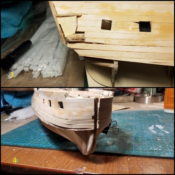

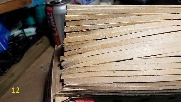

So I have finished planking the hull (Pic 11 & 12). Not the neatest job I've seen. Especially had trouble with the lower part of the stern (Pic 13). I need to invest in an electric plank bender. Didn't get the results I wanted with soaking and nippers.
Looks like I'll be doing a lot of sanding and filling.

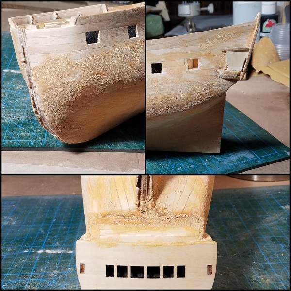

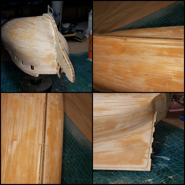

Steps 11 and 12
Step 11 consisted of a lot of sanding and filling. Enough said.
In step 12 I first fitted and glued the bow stem (part 35A) in place, followed by the keel (Parts 36A, B and C). The stern post (Part 35B) was the Final part of this step.

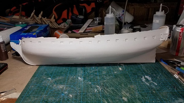

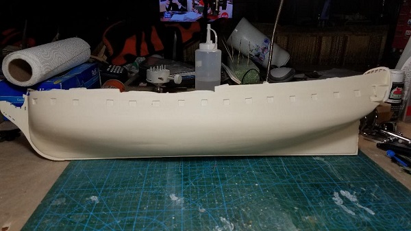

I forgot to mention that I painted the hull with Vallerjo Aged White.
