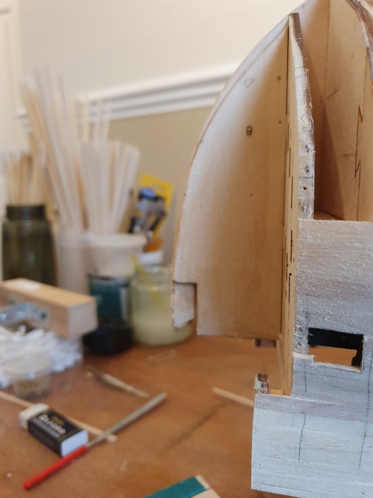

Quite a horror show tbh with the damage....
Ive cut away all the bits a the forward bulkhead is exposed without any bow formers showing..
Sorry Del but i will require entire new bow formers as some of the replacements where damaged and the slotted parts into the forward bulk head where in the slots so i had to cut thecout carefully with the scalpel tedious but had to be done......
So bow formers 8, 9 10, 11, 11a are required if its not possible then i may have to find some balsa sheet and carefully cut them out.....
Im now working out where to cutting planking as the top row ends at rib
17....
The split i thought that ran down the front bulk head turned out to be a pencil mark....must get my eyes tested....

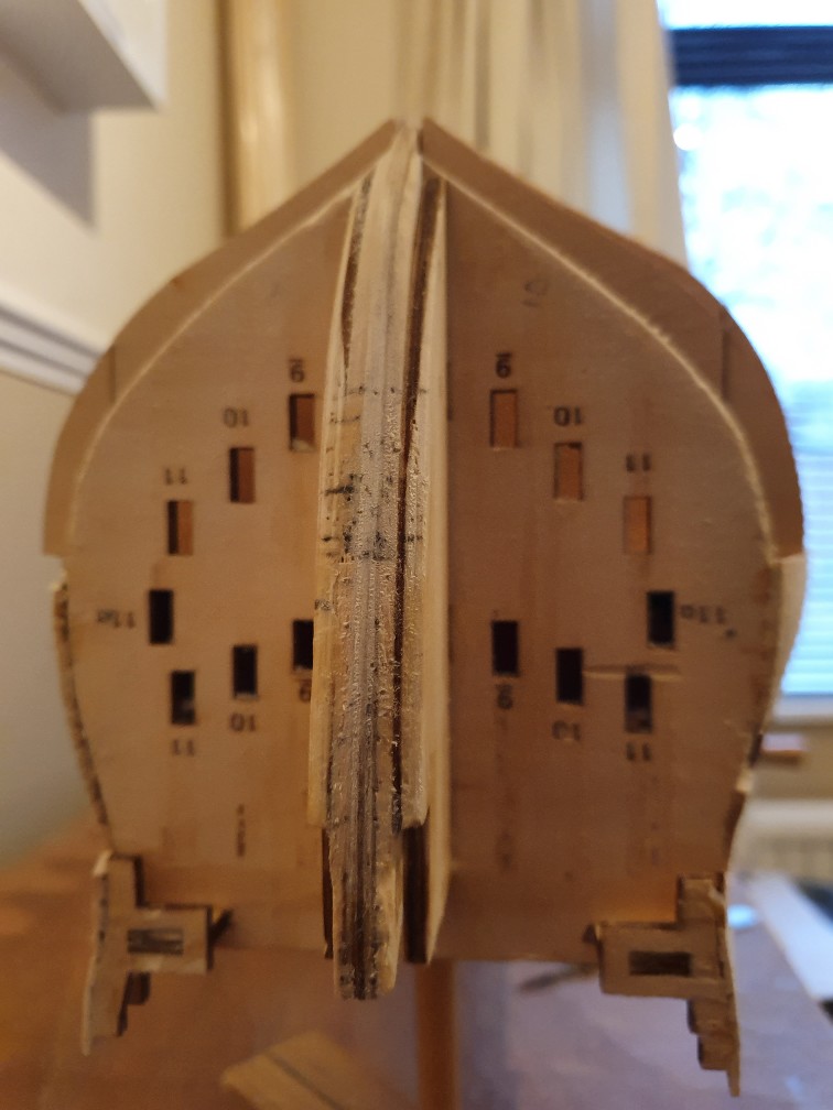

I have removed the first plank on both sides as it goes back to rib 17 and i have taped up the area where plank 17 was to protect the decking edge and the other exposed ribs also i have taped where i intend to stop.....
I have marked the rib 17s to where the planks butt up and im going to try and removed them carefully with my scalpel....
I have located a dealer that sells 4mm balsa sheets and balsa blocks and will use the sheets to fabricate the bow formers....
So im going to start to remove these planks carefully...

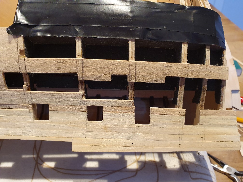

Well that worked out better than i orignally thought...
As you can see ive worked to the staggered plank system and dont really want to cut more off....
Just the other side to work on now.....

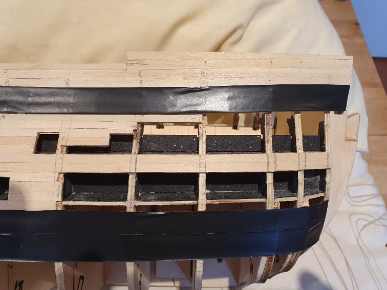

Well ive managed to so the otherside the lay out is slightly different but not much....
Tthanks del for the info about balsa strength, i can also get a sheet of 4mm birch modeling ply so i will collect that.....

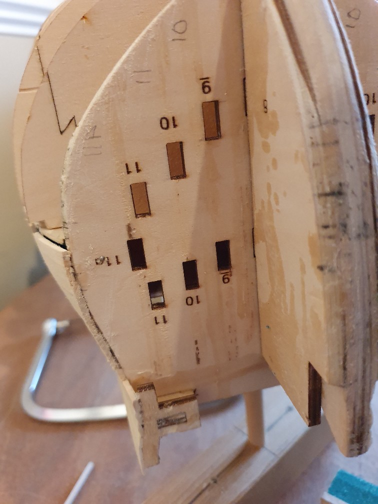

Well i started on making bow formers no9 yesterday and after a slight cockup and started again i managed to make two of them only took 3hrs.....
Hardwork by hand.......
Any way today im onto bow formers no10......
I make them 2mm slightly bigger on the curve and rub them down to the pencil line....
Look good so far......

All forward bow formers have be made and sanded.
The spare front bulk head came in handy to test if they fitted or not and they look good.....
Going to fit them on lto the ships frame and if they look ok glue them....
