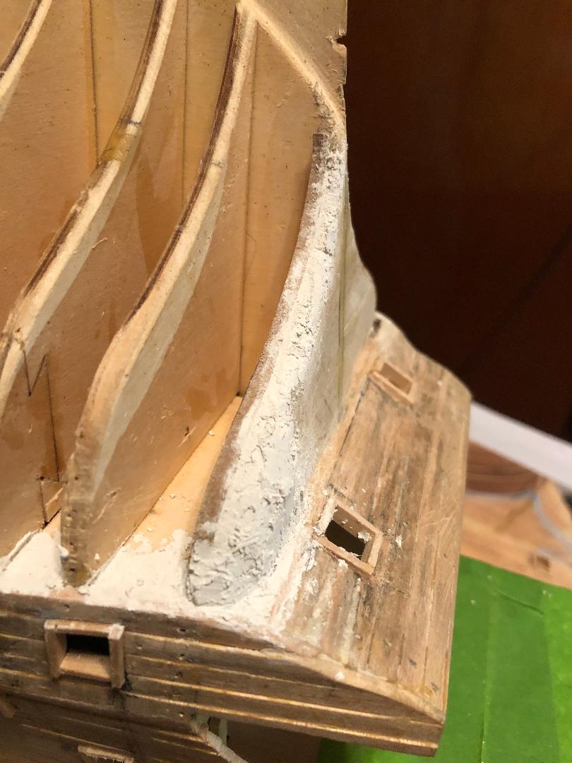

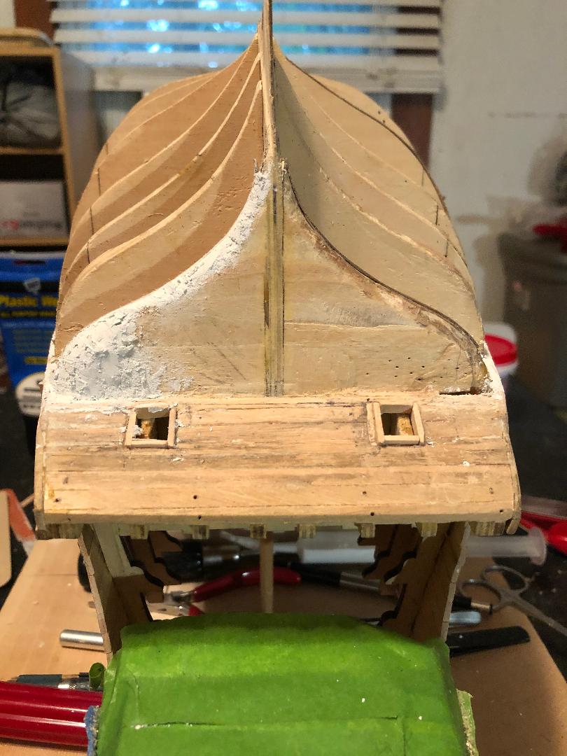

#38 Posted : 21 September 2020 19:43:33
Joined: 08/02/2015
Posts: 426
Points: 1,259
Location: Louisiana
HI Alan
please view these photos of the back and side views of the stern filled with
wood putty if you can see it disregard the tiny strip of card board on the back
side of the rib it can easily be removed once the putty dries it was used to
keep putty off the back as requested, let me know if I did it correctly or if I
need to add more putty or not I only did one side first will do the right side
if the left side is ok thank you
Ronald
ronald305 attached the following image(s):
#39 Posted : 21 September 2020 20:21:22
Good step forward Ronald, do the same to the other side and leave to thoroughly dry.. Post up pics when done.....
