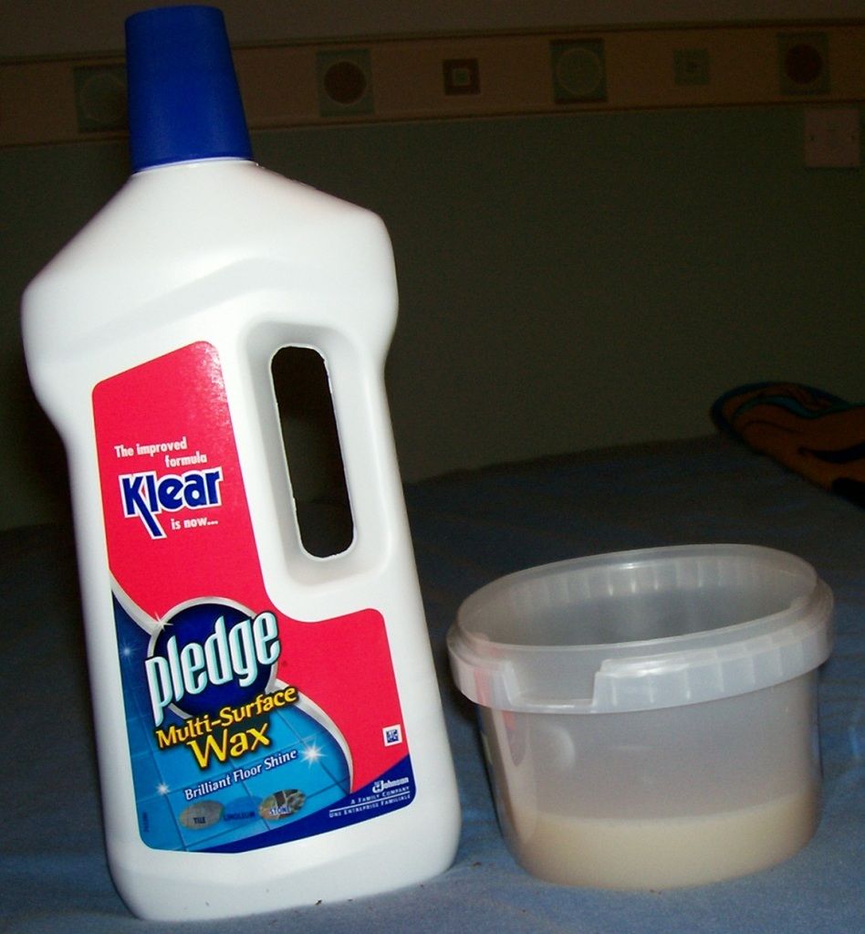

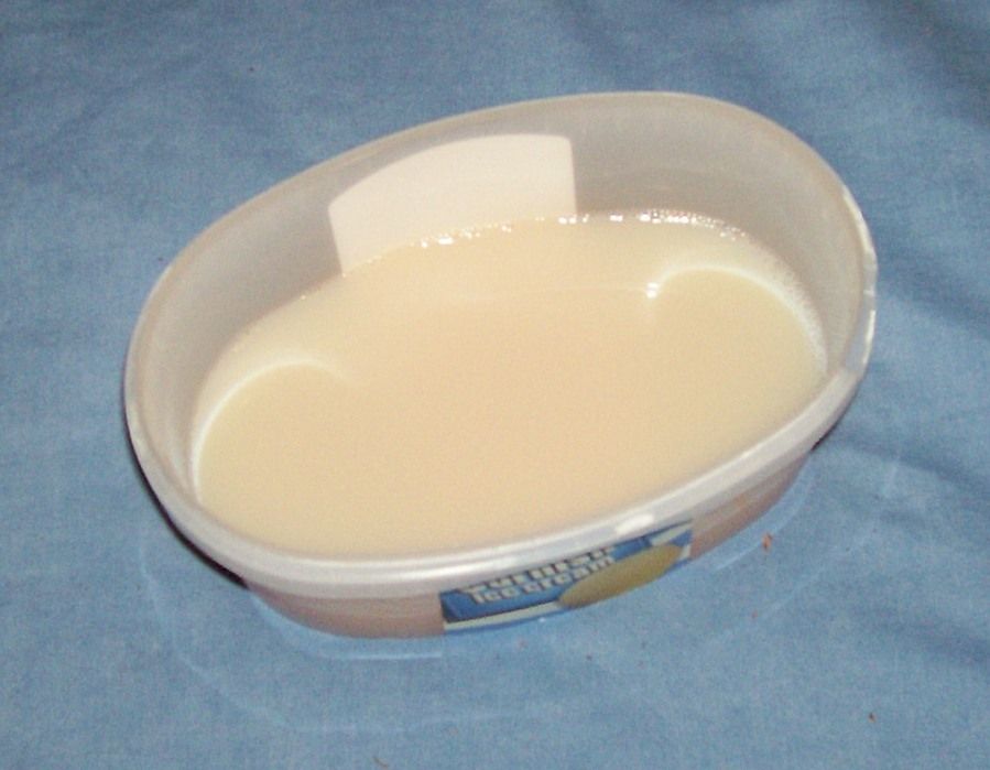

at last....a couple of pictures to try and sort things outBigGrin
have I bought the right one? the colour isnt very Klear to me..Huh any help would be appreciated...againLOL

That is totally wrong!! You have bought the wax! It should be clear!!LOL BigGrin
It should be like this.

It's fine.. it goes "Klear" once applied and left to dry.. just thin coats though. No runs or puddles.. then buff etc
Thats the problem Nem.. can't find it over here anymore. I've been using the wax with no problems

LOL can you tell Im a newbie? well can ya?LOL so youre saying that the stuff I bought is about as much use as an ashtray on a motorbike yeah?LOL what a 'plonker' I am..Blushing oh well, live and learn thanks 'Nemesis' and Spence for putting me right

I bought a case of the stuff!!! I didnt know the other worked though, I thought the wax affected the colour over time?
Then your sitting on a goldmine my friend!!! lol ebay selling original for about £25 a bottle.. Klear was discontinued around 2008 and what we have now is the new Wax.. takes a bit more to master but basically the same.. would definately prefure the Original "Klear" but not for £25 a bottle.. I could strap the missus to a poll and drag her around the floor and get better value lol
Robbie.. what you have is fine.. just follow what we have been saying... unless Nem want's to take early retirement and sell you a bottle lol

mine I tell ya mine!!!!!!LOL BigGrin
I stand corrected Robbie. I have never used it, but I am sure Warthog can tell you how to apply it, and me for that fact, my stash wont last forever!!!!BigGrin
