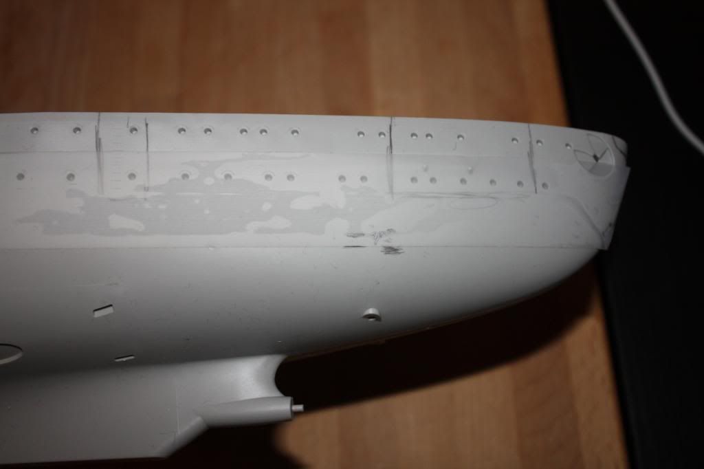

I've done some work on the Hull and added the main pieces, but that's it. The Hull is very thick and can take a lot of sanding, The Bow nose pieces didn't fit that well and needed quite a bit of work. I've been considering the PE for the vents, but I think that the moulding is OK and they will look too obvious with PE. I'm a bit fazed by all the tiny MK1 PE and the Hull painting (ie Boot Top) so I'm kinda waiting for you to lead the way
I agree the hull vents are fine, I will try and do my best to explain all the techniques i use as i go along but you can always ask anything as we go. Boot top will be a challenge as it is not marked. i have a 1:350 tamiya kit though so plant to take measurements and scale up. I think after the hull should be relatively straight forward construction - famous last words.LOL

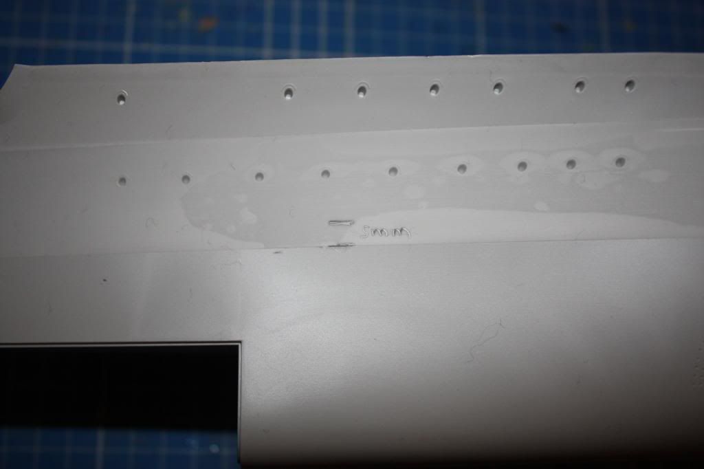

I notice that there's a problem with the Boot Topping/Waterline level at the Stern. If you mark it at a constant level from the Base it looks too low and needs correcting upwards.

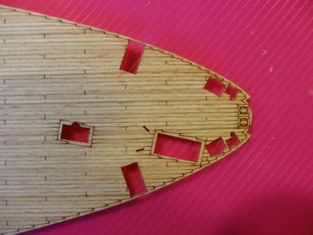

I saw that you were asking about Smoke Generator Canister Hatches on the MK1 Decking, they are there as you can see on the Photo, but no Crew Access Hatch to the Smoke Room as on the Artwox Deck.
Thanks for the deck pic Andy Deck looks ok, I will wait and see for my self befor i decide if I am shelling out for another deck.

Interesting comment on the boot topping. The shape of the bow dictates that the line plunges under the bow also the depth of the line increses. I will post a pic of my 1/350 bis tonight to give you some guidance.

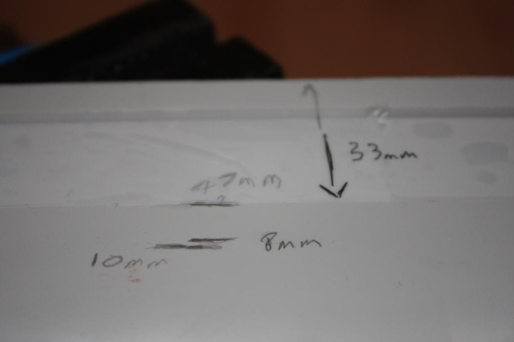

Answer to boot toping question...
The top line should be 47.5mm from the keel at the centre of the ship. Your quite right if you follow that line you will drop at both the stern and bow, 5mm at the bow 3mm at the stern. 47.5 gives you 32.5 from Boot top to deck if you follow that line you should correct the line. the boot to p should be 10mm deep (although i have been toying with doing mine 8mm for aesthetics, but probably wont LOL ). Hope that helps

So the 'boot topping line' is the demarcation line between the red paint & the grey paint on the model. This is 47.5mm from the keel at centre, 42.5 mm at the bow & 44.5mm at the stern. So if I was to draw a line mating up these points I would have have the position to mask & paint the lower hull?

Yes that would give you the top line the bottom line should 10mm bellow. Don't fall into the trap that some Bismarck model builders do and paint the false bow and stern black it should be very dark grey
