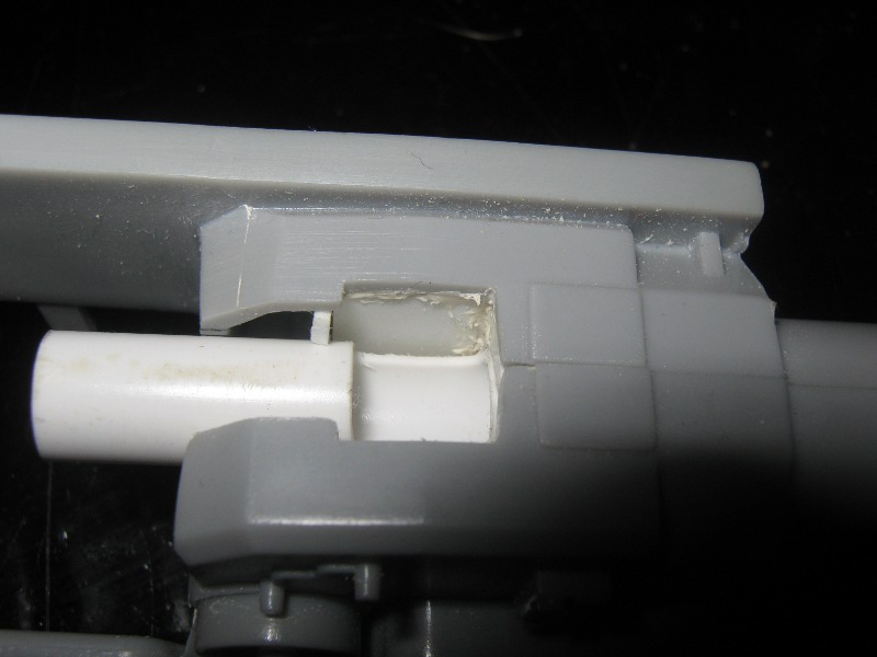

Breech block bashing is now under way!! I have cut in a slot for the recoil slide, and started the mods on the basket cradle. I have leveled the bottom of the breach with plasticard, and started to fill the gaps and add weld seams, a bit scruffy now, but when its all dried overnight I can start sanding and shaping.BigGrin BigGrin

Can I ask where you bought the turned barrel from? Want to get hold of one myself.
The Breech! Crying Couldn't be worse if they had tried!
I'm on my second attempt of sorting it now. Working on the block itself, trying to make it look a little more realistic.
Attached a pic of work in progress, hope you don't mind, still needs triming up & lots of filler but would be greatful of your comments.
Looking forward to following your progress.
Wilfy
