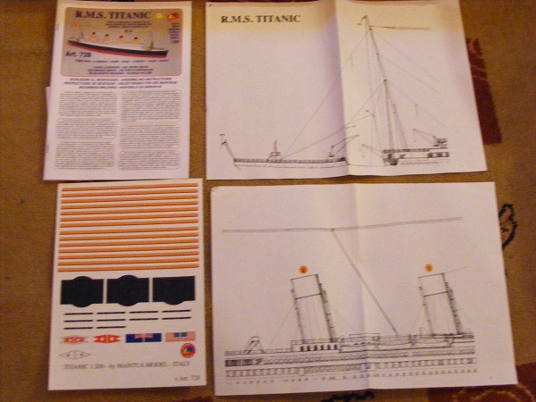

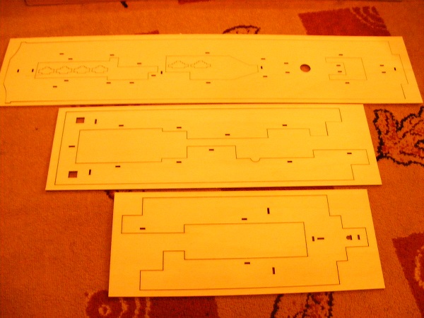

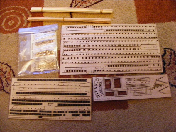

Now that the work on the SOTS is complete until the release of the next issue on Wed, I can now get back to working on the Titanic... First as promised thought I would now show you the contents of boxes 3 and 4....
Box 3 contains nothing but photo etched ply and some wood strips, the etch is very thin and very detailed... Though it looks flimsy it does have a remarkable amount of flexibility.. still needs to be handled with care.. Cool Cool

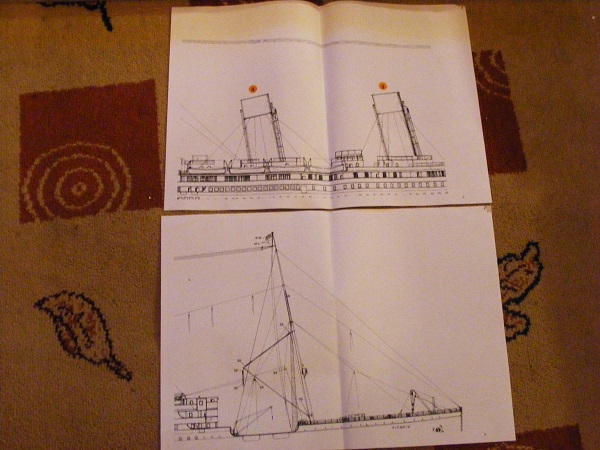

Contents of Box 4 and to think there is still box 5 to come....

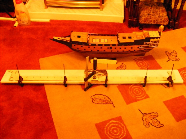

With all the ribs now prepped it was time to turn my attention to the keel, the keel comes in two parts only... Cleaned off all the black ash and again parts were heavily coated.. Drew a line down the centre of the build board and used the build board to clamp the two pieces in place to ensure it was perfectly flat... braced the joint and clamped as instructed..Cool Cool . placed some tin foil under the joint as I didn't want the keel to adhere to the build board... This will be left like this until tomorrow where I will add the bracing piece to the other side and start cleaning up the two lower deck pieces.... Cool Cool .. Decided to photo the keel length next to the SOTS so to give an idea of the size of this baby....Cool Cool

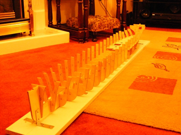

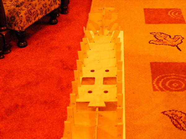

#37 Posted : 19 November 2013 22:44:31
Now feel the build has started in earnest. Have now got the build board finished with the angled brackets set in place... Keel set in place and before continuing ensured it sits exactly at 90 degrees to the board all along the entire length, keel also set along a centre line drawn along the build board.. Blink ... When happy dry fitted all the ribs in place plus the first piece of the lower deck, everything lining up nicely... Next session will be to clean off the second piece of the lower deck and dry fit before starting to glue and pin everything in place.... Cool Cool
