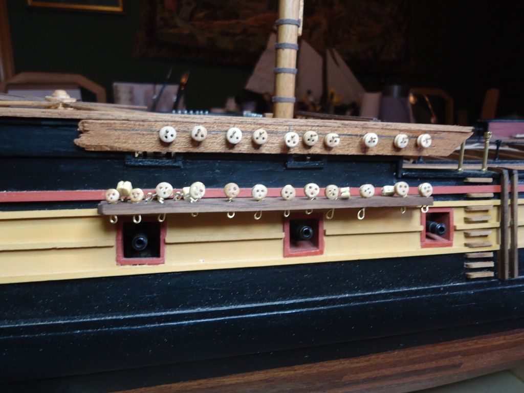

A bit fiddly, the pins held the block quite well, never mind, next time Alan.
Mo
alantait wrote:
similar to what i did mo.... but didnt think about the pins to hold the deadeyes.... pitty i am finished this now. as for the wire a few curses as it broke... if only you posted this a couple of months ago

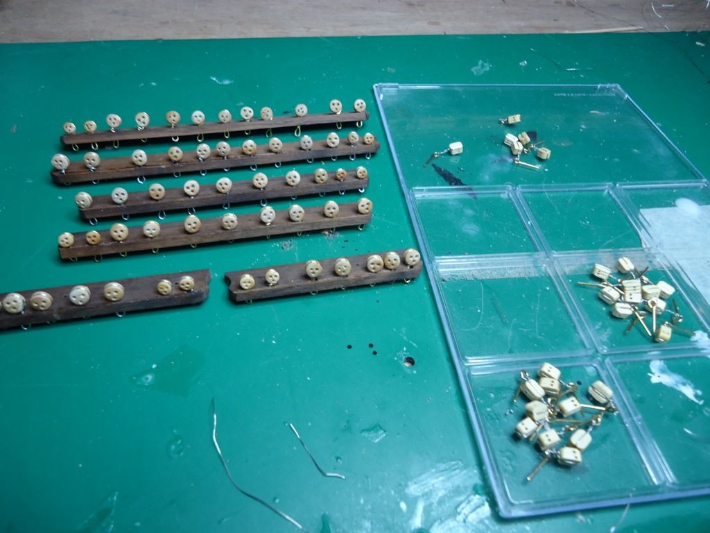

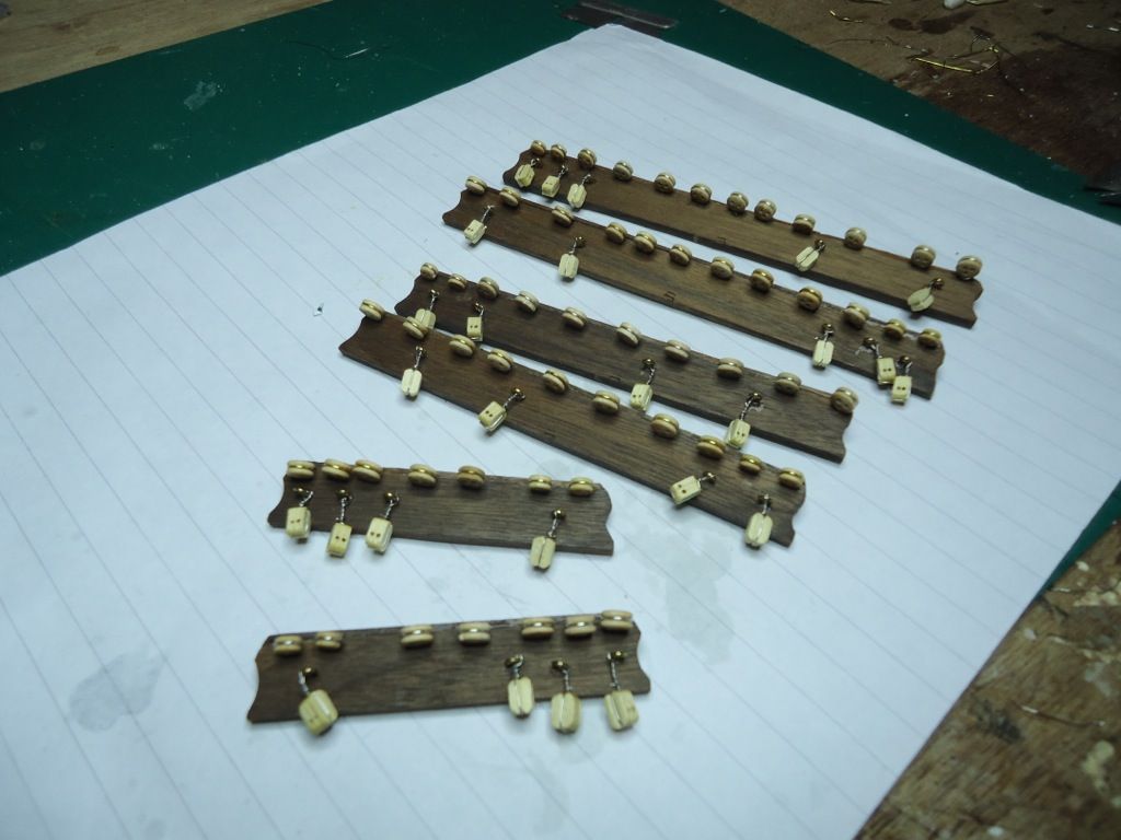

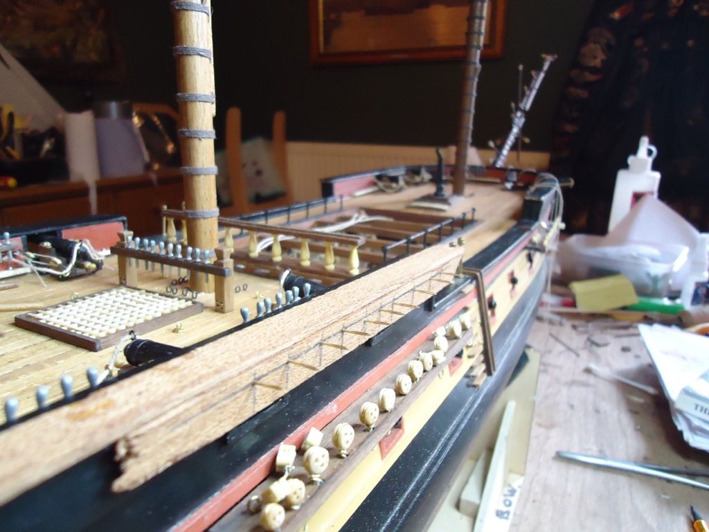

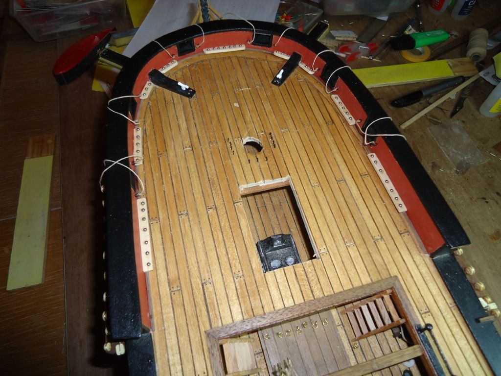

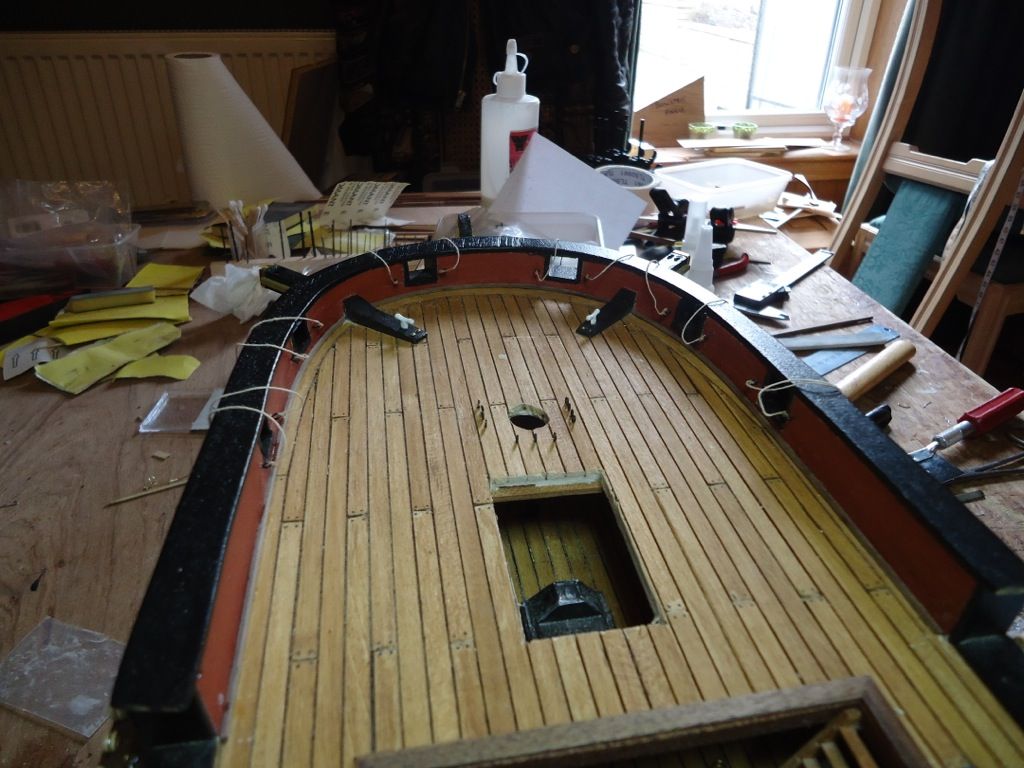

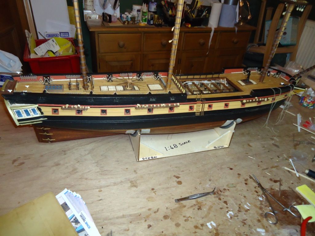

I have finished the chainwales, and coated with Danish Oil, I have not fixed them to,the ship yet, as I am unsure of the exact position. I have also fixed the block's as per the drawing.
I then did the cannon ball racks, and the cannons to the bow of the ship, I am unable to do the last 3 as I am short of brass eyelets, I did but some but they are a bit larger than the one's needed.
All in all, its coming along fine.

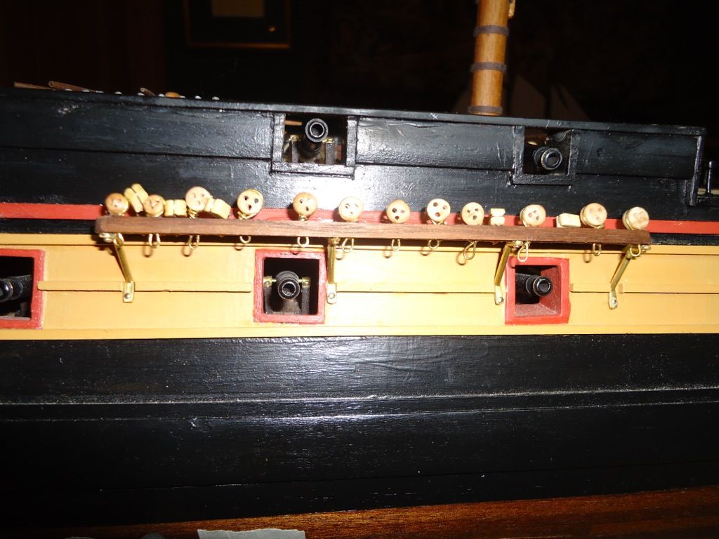

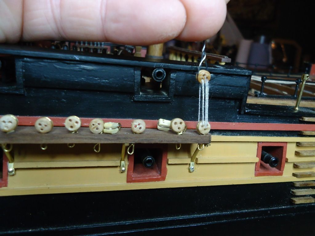

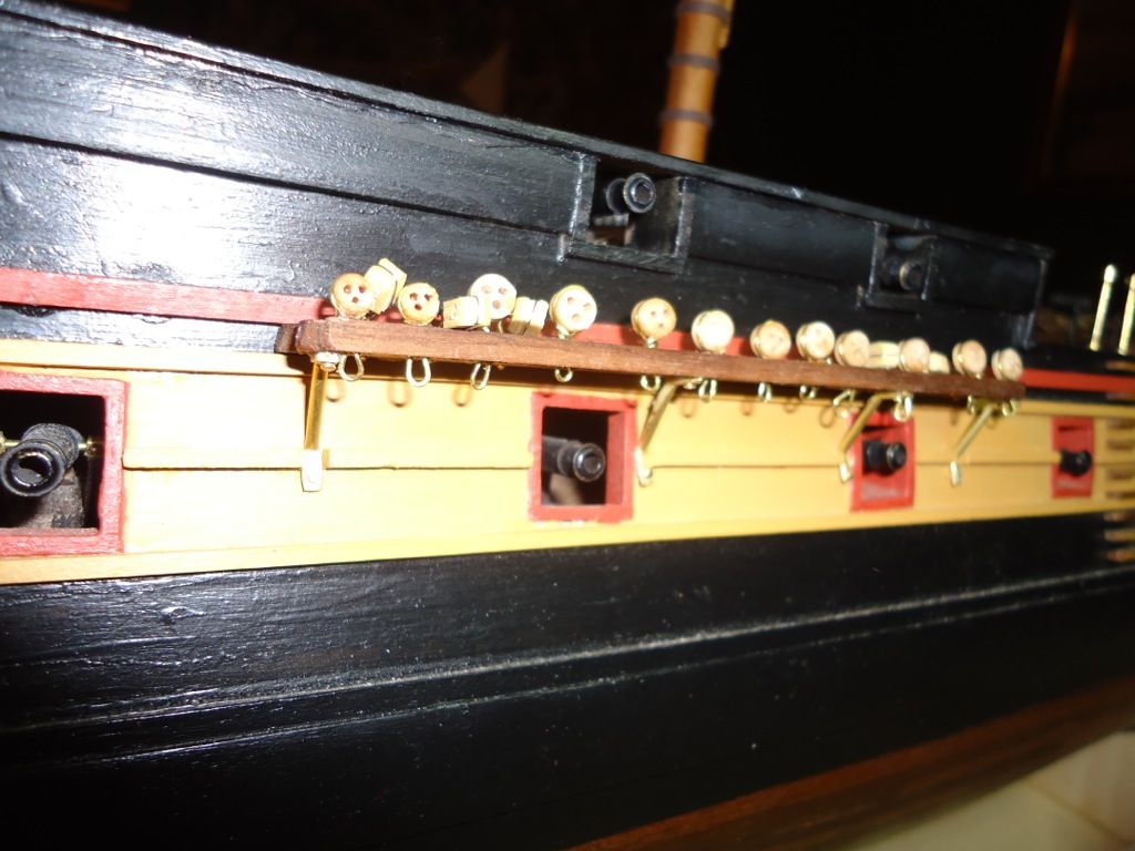

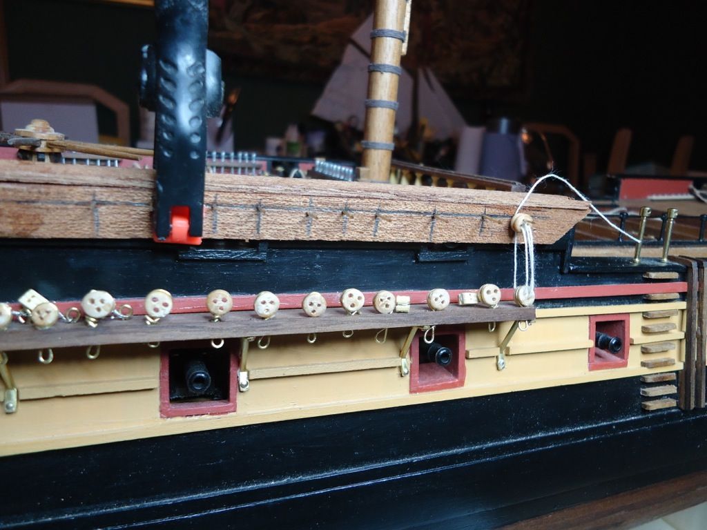

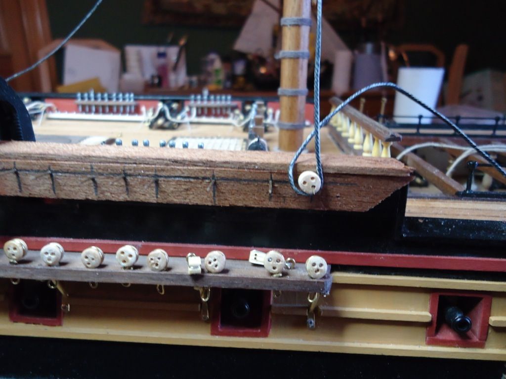

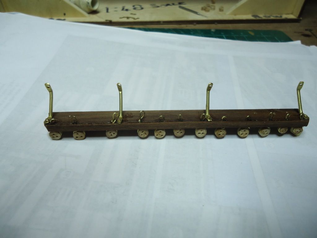

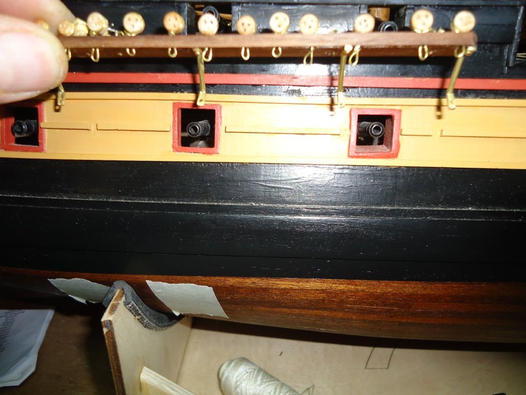

My next step was to fix one of the chainwales, I used the brass brackets supplied, I also had to cut out a section of the 2 x 2 timber, running through the centre of the gun-ports, to allow the brackets to be pinned in place. I first fixed the brackets to the chainwale timbers.
I then positioned the timber to allow me to mark the cut outs for the brackets, I cut the timbers with a small chisel blade in my model knife.
After I cut the slots for the brackets, I had to repaint the ends of the bare wood.
I then wanted to see if I could make one of these, rope loop things, ( sorry but I don't know the term for them. ) So I gave it a go. I made a small jig to keep me right. The following pictures will give you an idea of what I did, and I am happy with the results.

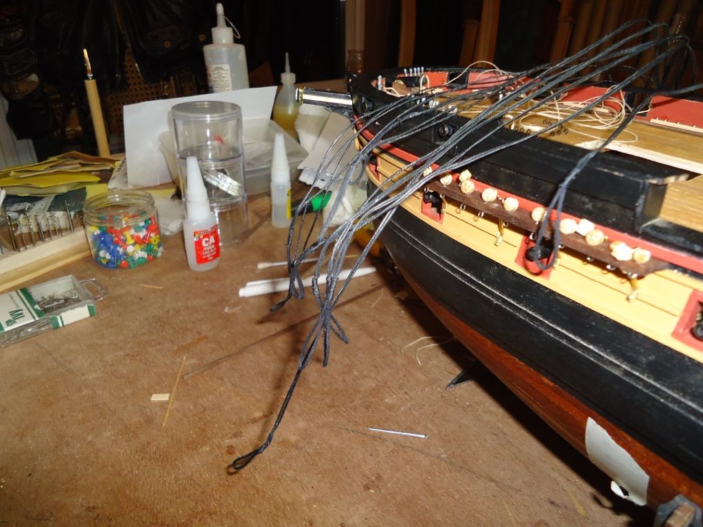

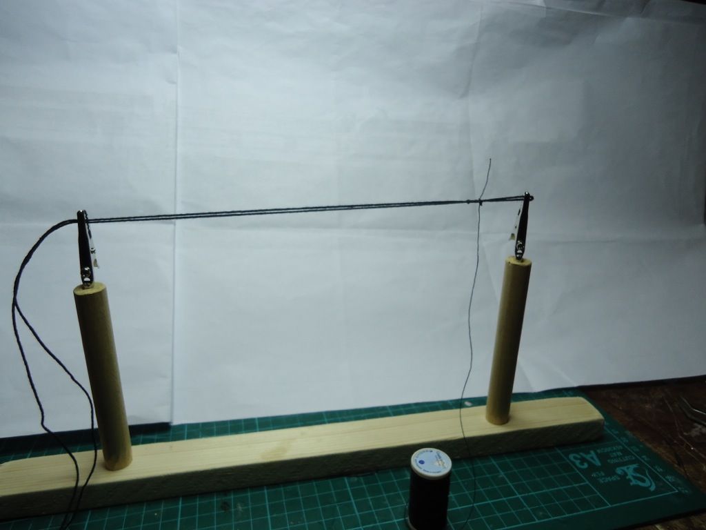

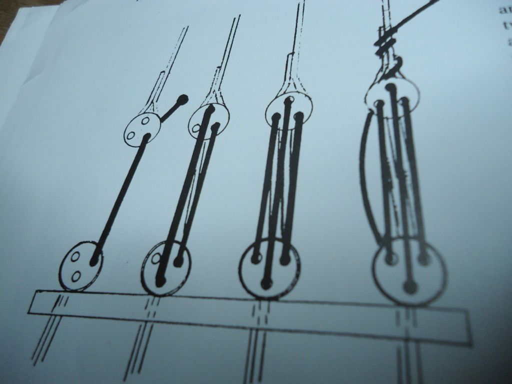

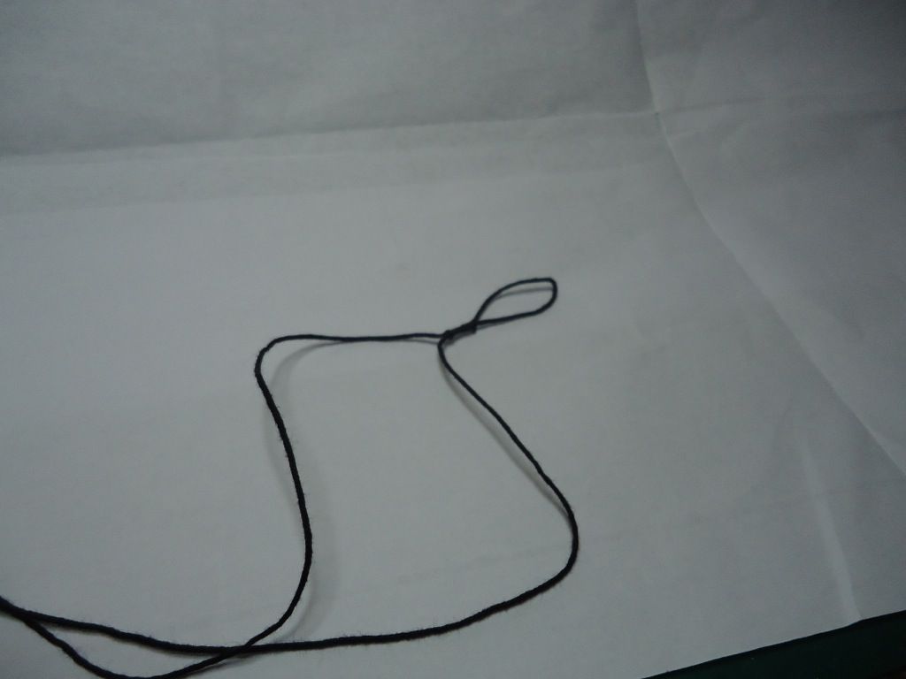

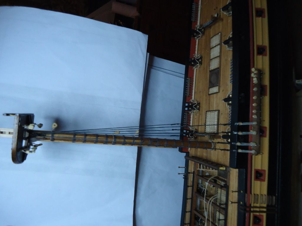

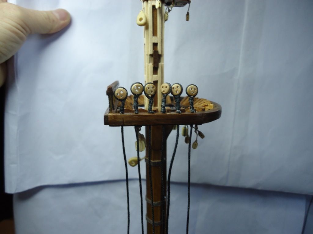

Getting on a bit now, I have had to order some more materials to complete the hull, In the meantime I am trying out some of the rigging, to make sure I have the right kit, and I know what I am doing, I have had some help from Ian, and been doing a bit of reading on the subject, so this is how I am going to proceed. I am going to fix the bottom section of the main mast in place, I am going to glue it in place,( bit of pressure here ) then I am going to do the thick black thread that hold the ratlines, I have pre made these, this is how I did it.
I made the jig above, I marked the amount of space I needed to get the thread over the top of the mast, I marked the thread with a crocodile clip, then did the seizing.
This gives me enough room to get the lines over the mast, apparently they are done in pairs, 2 down one side and then 2 down the other side,

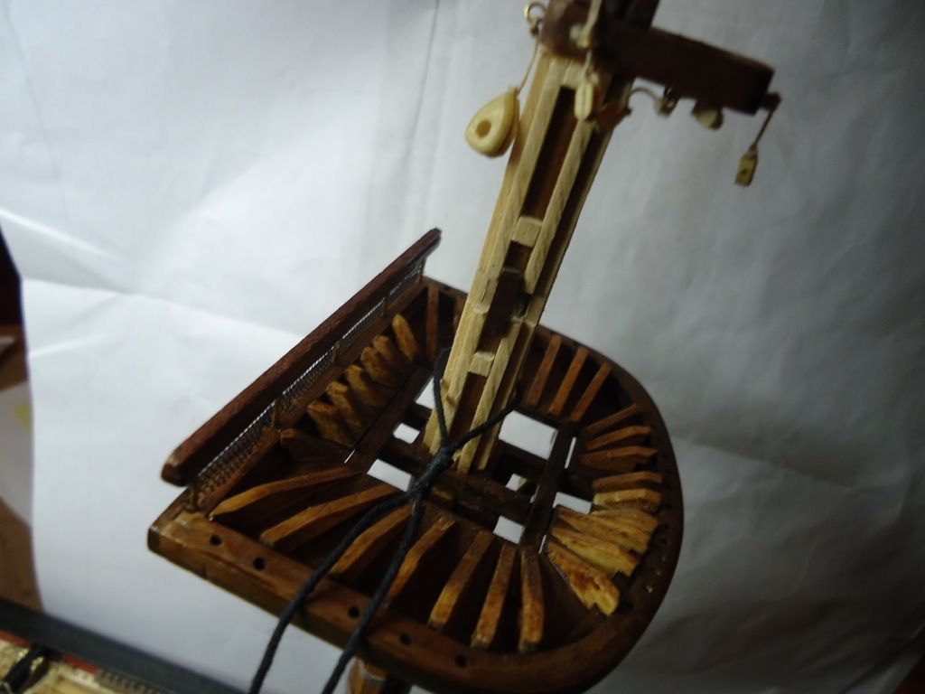

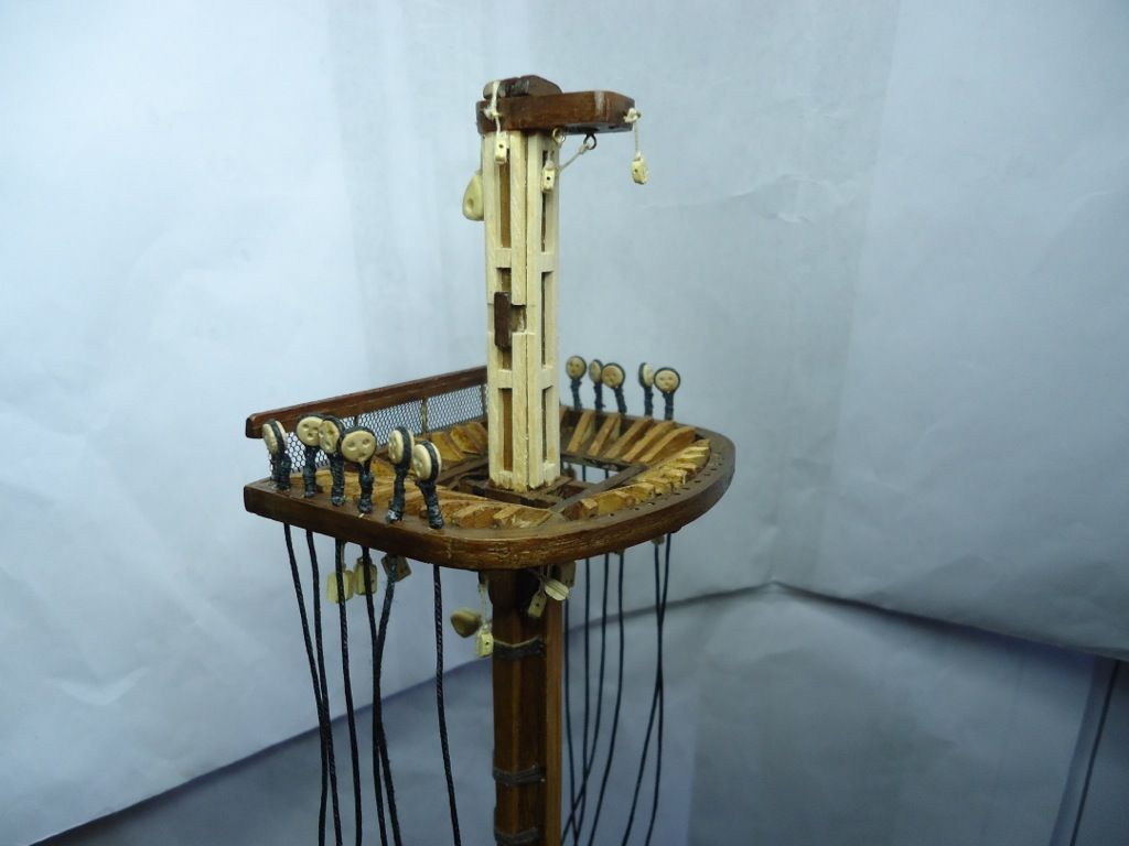

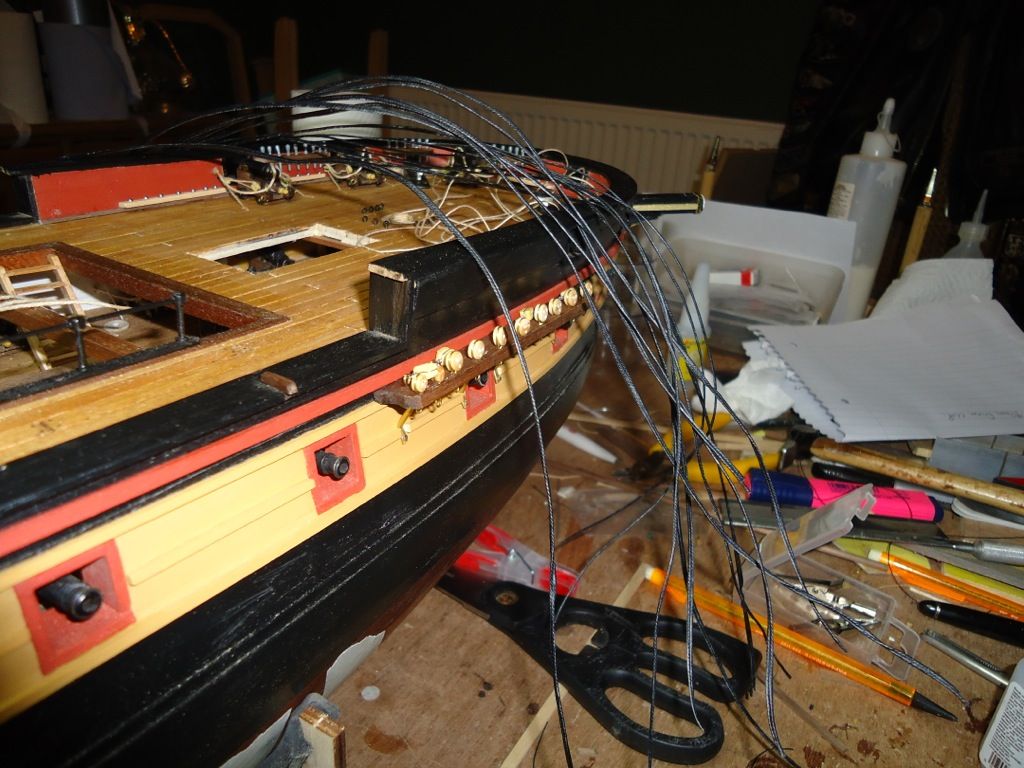

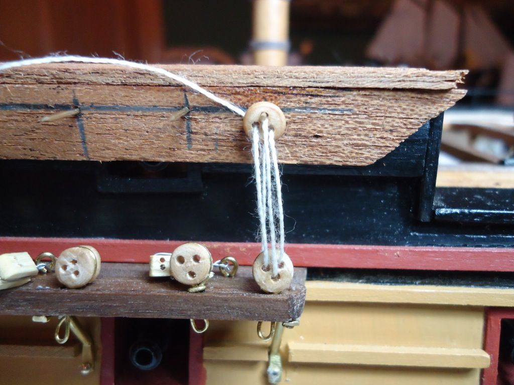

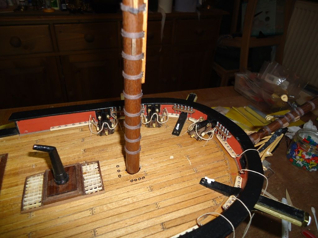

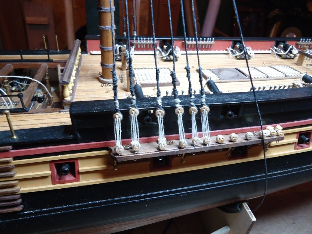

I have been busy on the lanyards, I think that's what they are called, I got a stick of beeswax, I coated the thread with the beeswax and rubbed with my fingers to get the wax rubbed in, As you can see from the pictures below, the thread is now quite stiff.
I have now glued the bottom section of the main mast in place, and put the collar on to the deck. I then made the dead eye's for the crosstrees, at the top of the bottom section of the main mast.
It was then on to the main mast rigging and shrouds.
Really happy with the outcome for a first attempt. It is to complicated to explain how I did this, but I copied it from a tutorial found in the following web site. ships of scale On that site there are a few video tutorials, I found it very useful.
