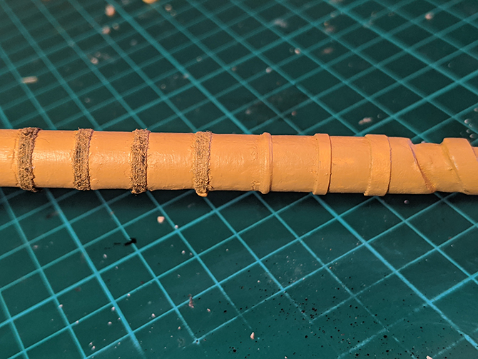

The bowsprit took longer than I was expecting in the end due to painting issues. I wound the 10 strips of thread, and they looked OK, but after I spray-painted them, the finish was awful see pics. So I took them all off and redid them, this time painting with brush thinking it was the spray process causing the problem but no, exactly the same.
I then remembered we did something similar on the main mast but when I checked, I had completed the windings with masking tape and simply painted over that and the finish was good. I have no idea what went wrong here and so if anyone knows, I would be curious to find out how this occurred. I doubled checked the video build, and it looks like thread was used there and painted over, and the finish looks fine.
Anyway, this gave me an opportunity to have a look at the pictures I took when I visited the Great Lady a few years ago, and I noticed that the bands are a lot thinner than on the model. I also checked a couple of books I have that provides plans, and they say the same thing. So, I broke out the mini masking tape and used that instead. All looks good again.

I feel your pain with painting the thread on the bowsprit.

In terms of strange behaviour of bowsprit bindings when painted I found that one layer of shellac seals the thread and everything looks smooth then :) Every day you learn something new by look of it.

Coating the thread was never mentioned in the instructions or on the video, AFAIK, though. That seems a shame.
