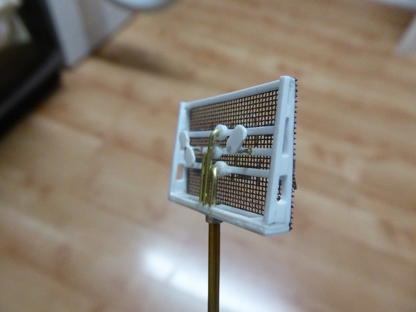

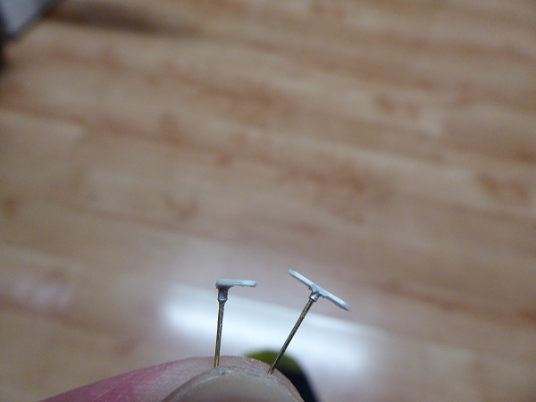

To strengthen i cut two small lengths of 1.0mm diameter aluminium tube, 0.5mm inner diameter and slid these sleeves along the 0.5mm diameter brass rods of each receptor. These aluminium sleeves were then butted up against the paddles and fixed with a little glue.

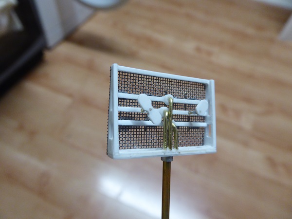

Sticky Wickett
#403 Posted : 25 October 2018 20:37:23
Joined: 20/10/2016
Posts: 4,504
Points: 13,548
From one angle.

Sticky Wickett
#405 Posted: : 25 October 2018 20:39:43
Joined: 20/10/2016
Posts: 4,504
Points: 13,548
The final view of the completed FuMO-30 wire mesh antennae radar. I'm very happy with the end result!BigGrin

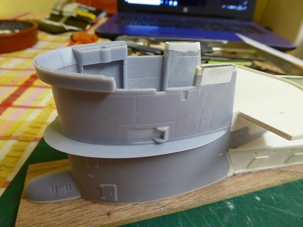

I can't fit the radar mast until I've made some changes to the conning tower itself. So for a change of palette from small, tiny and fiddly, it's time to get heavy, get hardcore and break out the razor saw and mini grinder. At this point my research and ponderings would be put to the test!Blink
The attached photo shows the cowling; cut up and ready for fitting!
Sticky Wickett
#407 Posted : 25 October 2018 20:45:25
Joined: 20/10/2016
Posts: 4,504
Points: 13,548
The cut up cowling fitted to the conning tower.

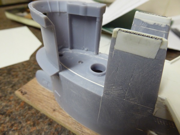

Sticky Wickett
#408 Posted : 25 October 2018 20:47:14
Joined: 20/10/2016
Posts: 4,504
Points: 13,548
Time to get stuck in with the razor saw and mini grinder! I have to remove these sections to then rebuild them with a different profile to suit the radar housing and the armoured boxes which I will explain more about next week.

Sticky Wickett
#411 Posted : 25 October 2018 20:52:30
Joined: 20/10/2016
Posts: 4,504
Points: 13,548
Back to the port side of the conning tower; all edges have been filed smooth and surfaces filed flush. This side is now ready for some interesting modifications.
