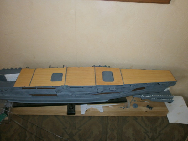

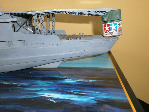

all the supplied decks have now been made up and some more platforms added plus the rear hangar doors were added this concludes all that was supplied in issue 21. As always all comments/questions are welcome

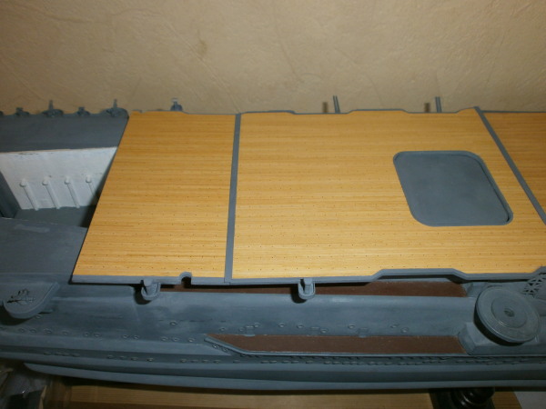

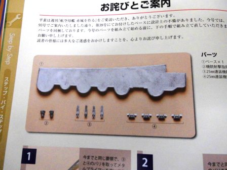

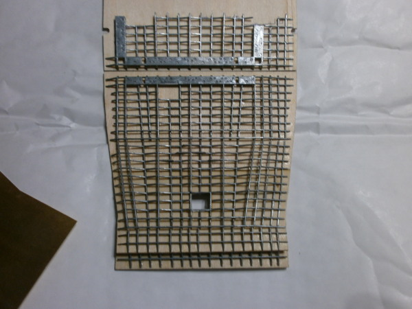

By the way, there is something that is bothering me in your last picture (pic #1).Confused

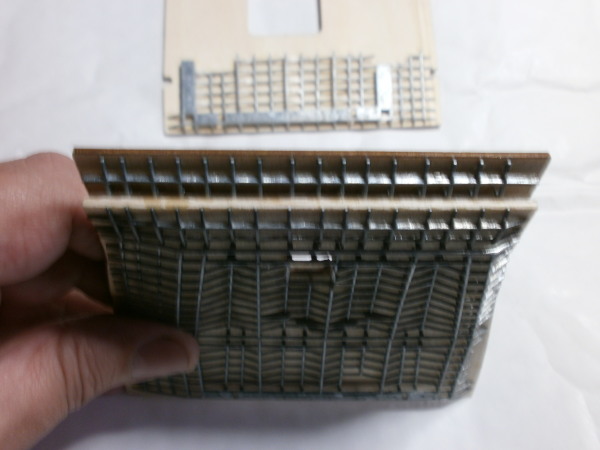

DeAGOSTINI Japan announced that they had provided a wrong metal part(pic #2) in the parts set of issue 39 when they provided issue 93. A lot of Japanese builders had to remove the wrong part and re-attach a new metal part in the last stage.Cursing
They showed us the picture of a wrong part(pic #2) then. The part on your Akagi is marked in the pic #1.

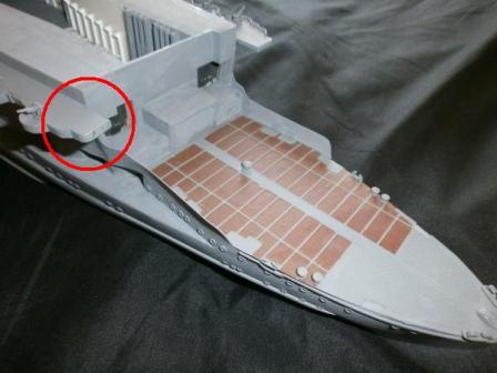

The right part(pic #3) was provided in the parts set of the issue 100 that was a last issue.
I am worried if your part is more resemble to the wrong part than the right one.Confused

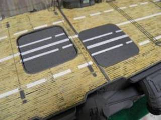

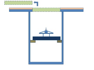

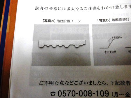

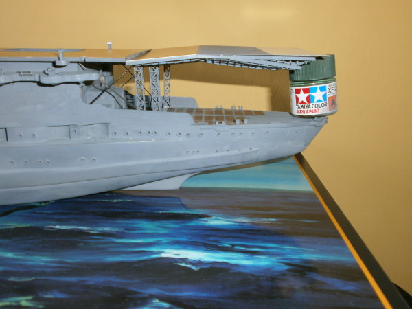

I guess you are close to the stage where antenna masts are attached. Although a mast is never located above the gun (pic#4), a right bow side mast is located on the gun in this model(pic#5).
Be careful.Cool

Yes I was aware about the missing projection at the end of the platform, im not sure if that part is to be reissued here though. As for the masts I had already noted that from one of your previous posts

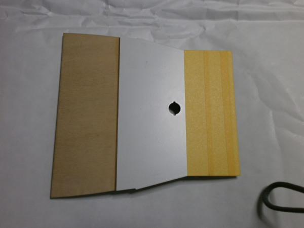

Posts: 747
Points: 2,233
Location: Tokyo, Japan
Hi Andy!

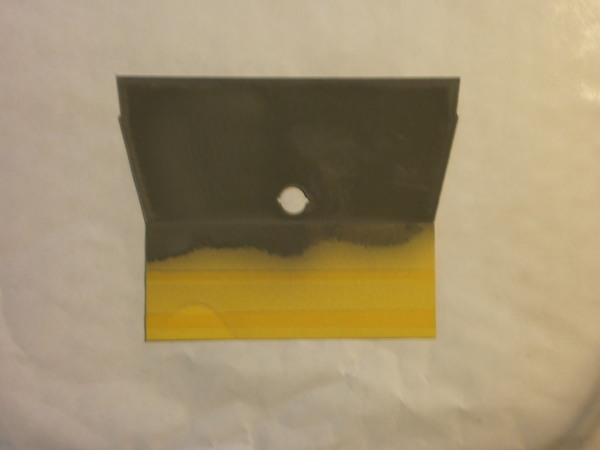

I think there may be The Third Way for this issue. I made the central lift be a double floor structure. (pic #1) Although the reason I did it was different from a measure against the warped flight deck panels, this method might be applicable.
Making a removable lift floor, even if the panels were fixed, we can easily see the inside of the Akagi when it's necessary. (pic #2)
Best Regards,
Yutaro
