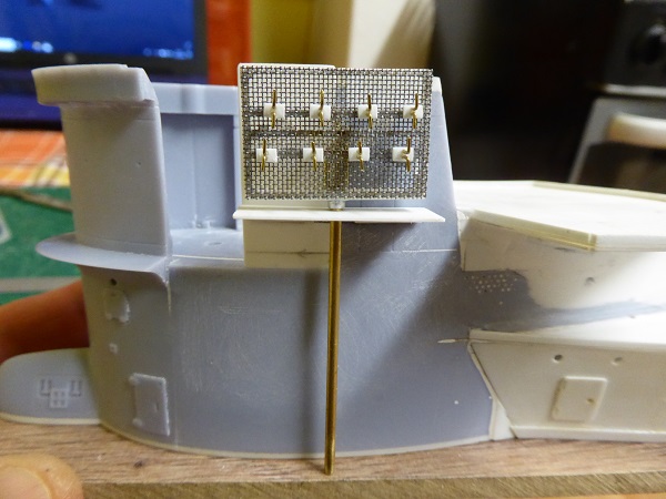

From this point on i proceeded to build up the box section that houses the radar antennae. As before, plenty of measuring to ensure all aligned and when completed, the addition of 1.0mm square strip, fitted internally to support the corners.

Radar antennae being checked for fit and alignment.

Further checking of alignment. On the real U-boats this mast was raised and rotated manually by the radar operator in the Control Room, via leadscrew and handwheel.

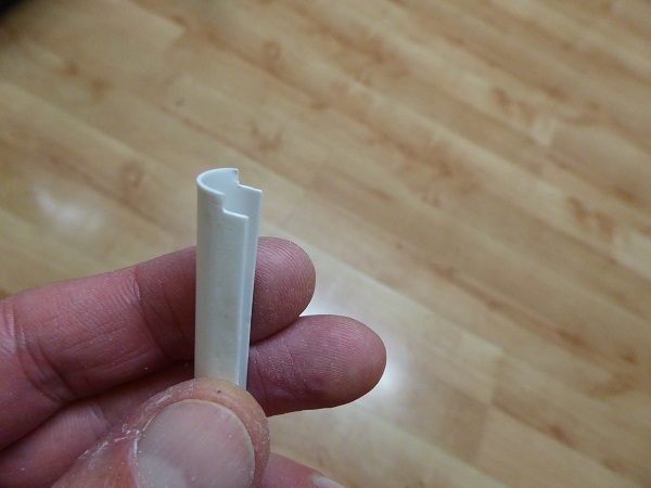

I then inserted the brass rod of the radar mast through the holes and at the same time cut lengths of aluminium tube that slid over the rod and acted as supports for the profiled pieces.
The second profile piece [from top down], split, but fortunately it split in such a way that it still supports the aluminium tube.Blushing Blink

Now that everything was fitted and fully supported i fabricated the actual housing from 0.5mm thick plastic sheet. After cutting to size, then bending it around a marker pen and holding in place with bulldog clips, i left it in a mug of boiling water for 5mins for the plastic to form a natural curve. The attached photo shows the housing prior to fitting.
