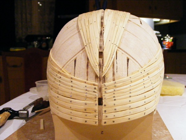

Today I continud with the planking described in issue 23 but as previously mentioned I did have to deviate from the written instructions and Mr T's build. On the bow, completed laying two rows, the first row as shown in the mag but the second row has been laid exactly where the plank wants to go, tapered and fitted accordingly. If I had continued to the centre of the bow, forcing it into place then a clinkering affact would have been the result.... Also fitted one row either side of the top of the hull...

Tapered the last two rows for the stern as instructed. A little fiddly but got there in the end... Have one more strake to add on the other side.... that's a task for tomorrow I think...

Also made a start of tapering and shaping some off cuts and filling the gaps between the strakes at the stern, again hoping to continue with this tomorrow..... Thanks to all for looking in and for any comments....BigGrin BigGrin

Looking really good there, the sterns always look funny until the filler planks are added in but you're making a darned good job of it!Cool
I had to look hard at the last photo, I thought you were doing a Graf Zeppelin at the same time!!BigGrin
