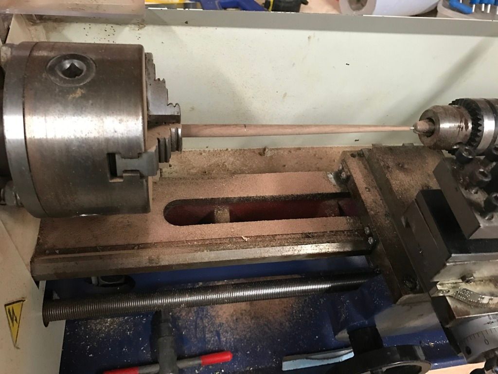

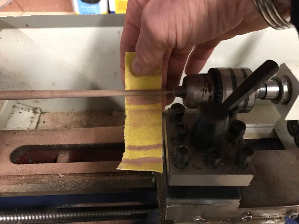

I am using a lathe to reduce and taper the yards, I am only using sandpaper to shape the timber, moving the sandpaper left and right to get the correct size, I have rings to fit on to the yards, so i have to ensure that i get the right diameter at the correct points, so as they slip on to the correct position.

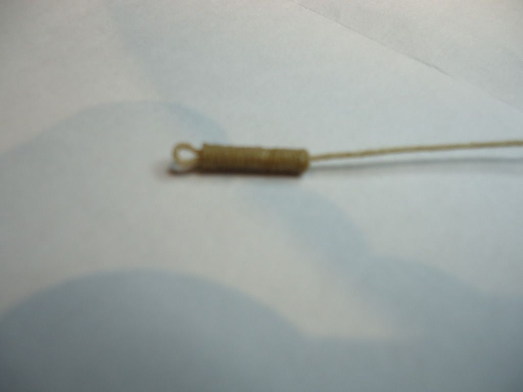

Thanks Grandale & Sticky Wickett for your comments, Its been so long since I have done any serious building, that I have forgotten some of the skills involved, Anyway I have now finished my first Yard.
I am just starting to remember some of the things I learnt early in my build, A lot of which I learnt on this blog,
The hardest part of this task for me, was the brass wire for the foot holds on the underside of the yards,

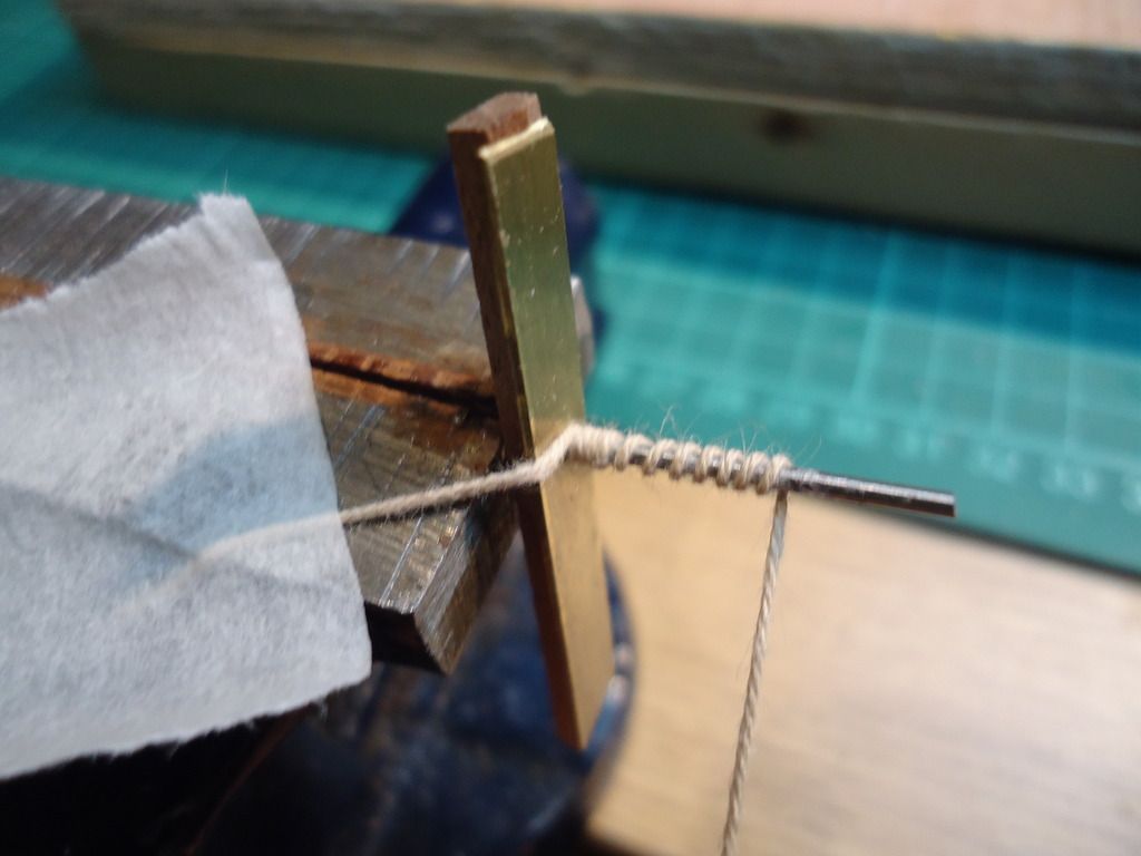

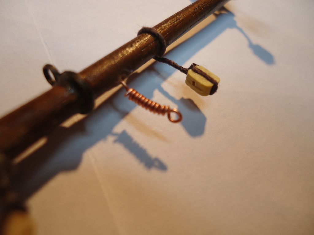

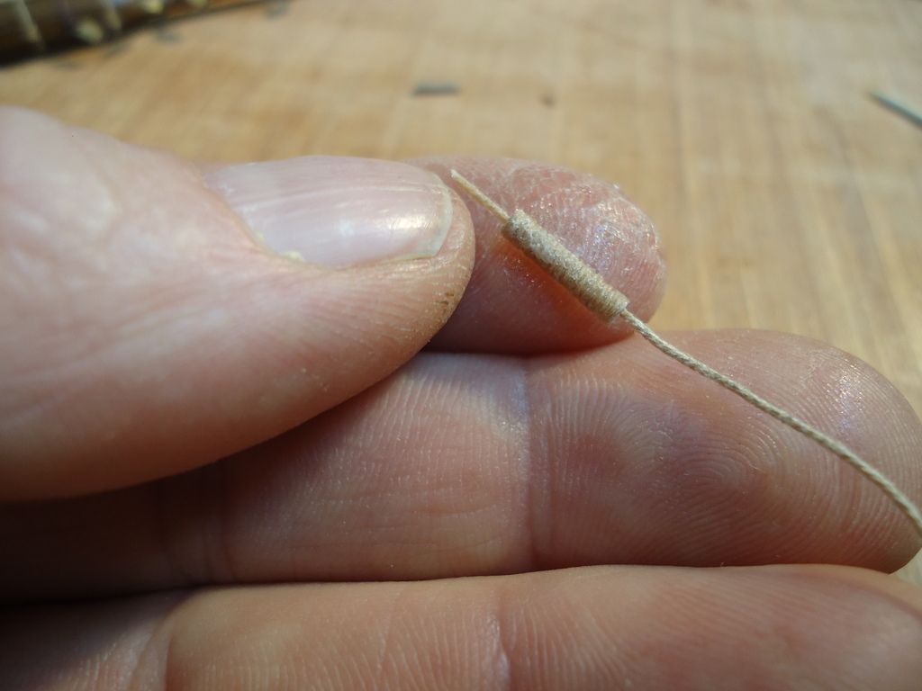

Can anyone help with the correct name for the rope the Sailors stand on when they are up on the yards. Anyway I tried the Brass wire supplied but I felt it was to stiff, to hard to work with, I then tried the copper wire, it was easier to work with, but I was still was not happy with the results, so I stripped them of and did them in White thread.
This is the copper wire effort, quite hard to work with.
[/URL]
I found this a lot easier to do, and I think its a better finish.
[/URL]

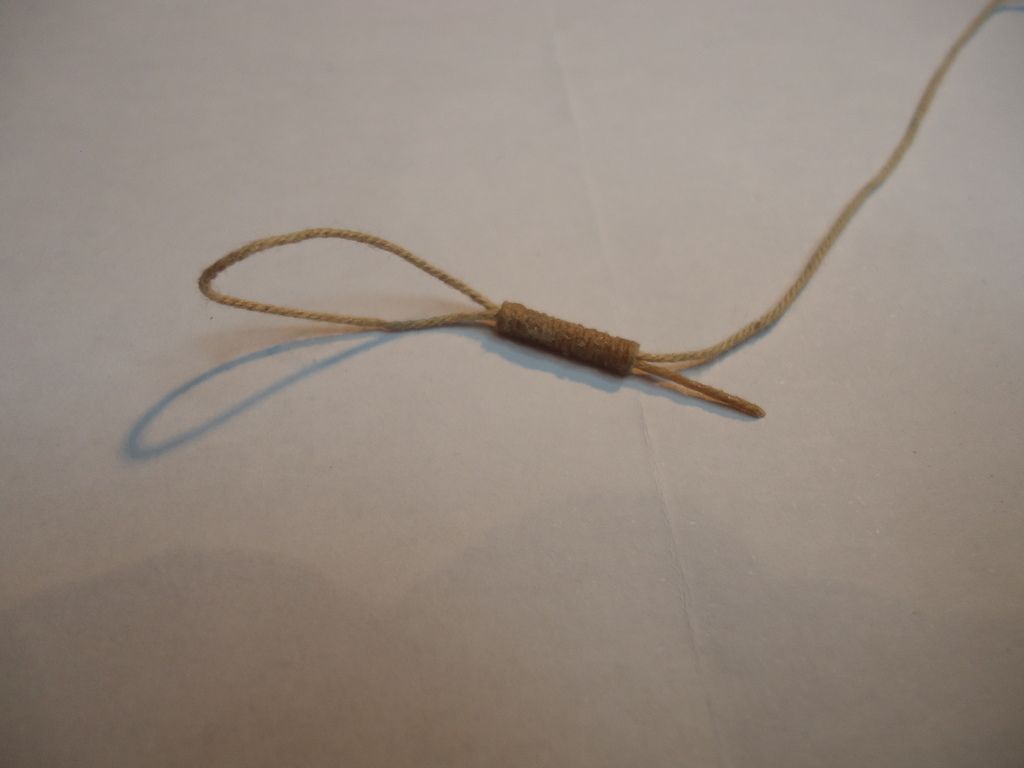

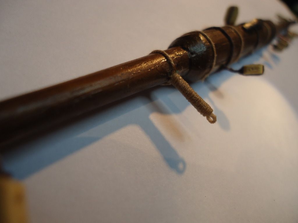

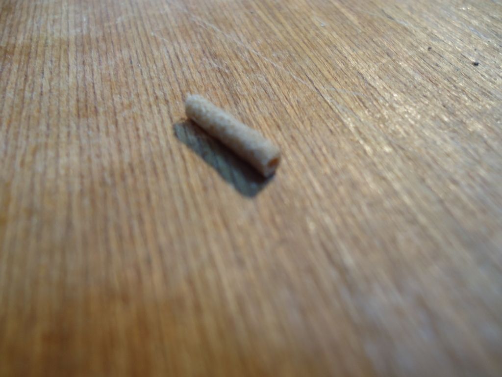

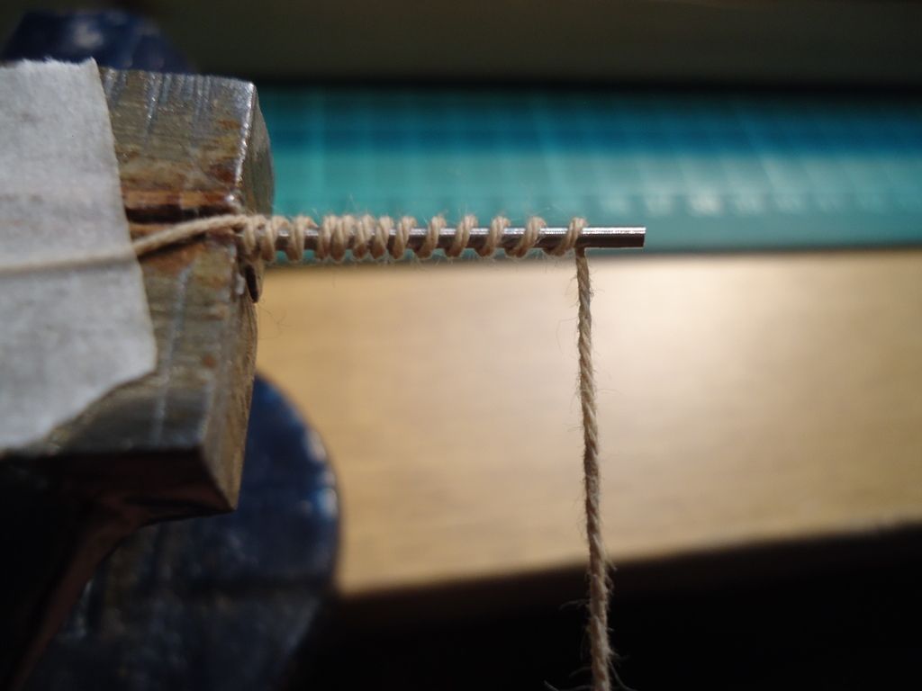

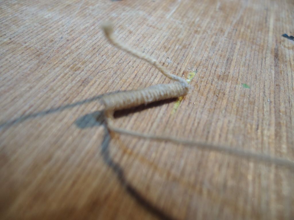

I wound the thread around a 1mm drill,
[/URL]

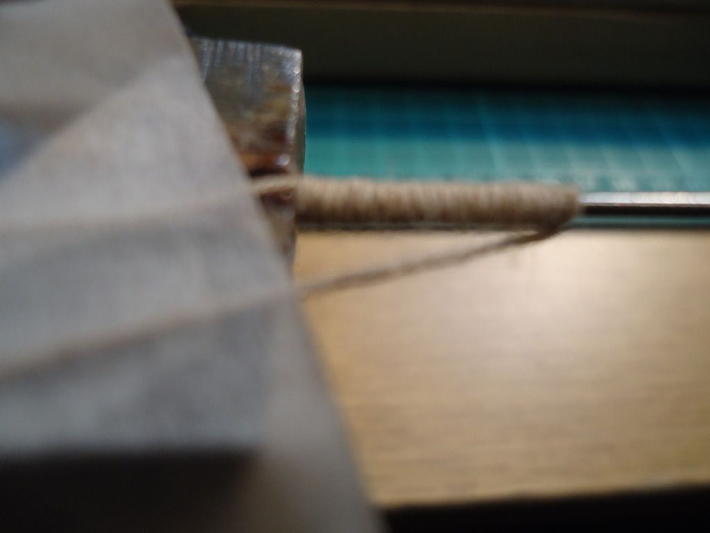

I then pushed it all up tight,
[/URL]
I then put super glue on to the thread, quite thin, the thread absorbed the glue and the thread solidify, You then have to try and remove the thread from the drill. It wasn't till I had done a couple, that I remembered how I did it before. I used to put a little jig behind the thread to enable me to get the thread of.
[/URL]
You then pull the jig and it removes the thread, leaving a small tube of thread.
[/URL]
I then cut the tube to length.
[/URL]
I then got some more of the thread, and hardened the tip of the thread with thin superglue, and when hard cut the end at a 45 degree angle, this enabled me to slide the thread in to the tube,
[/URL]
I then pushed it back through the tube
[/URL]
trapped a 1mm drill to form the hole,
[/URL]
Removed the drill, super glued the loop, just to harden it, removed the drill.
[/URL]
And cut of the spare leg of thread.
[/URL]
Thats how i did it, and stuck it on to the yard.
Mo

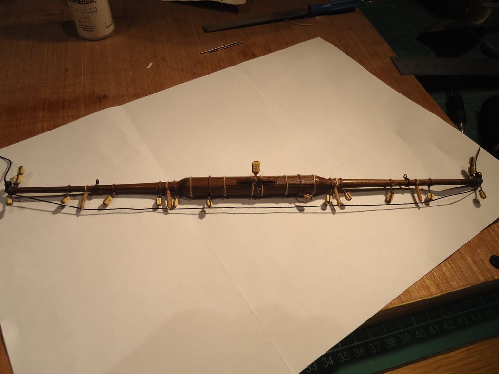

#498 Posted : 06 January 2017 23:57:09
Joined: 09/02/2012
Posts: 569
Points: 1,675
My first completed Yard, hopefully the next ones will be better, as I get back into the rhythm, The black foot hold thread, is only in for effect, and will be done properly as and when I get to that part of the build.

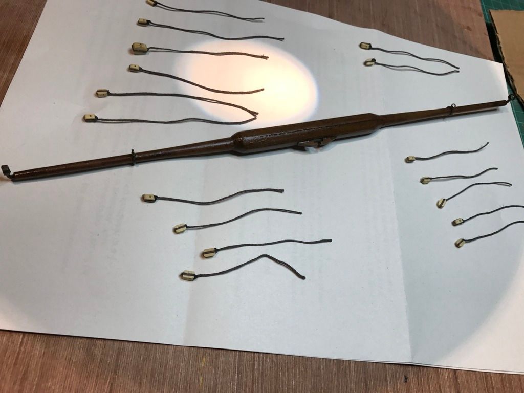

#500 Posted : 07 January 2017 10:04:11
Joined: 09/02/2012
Posts: 569
Points: 1,675
Oooophs, One last thing I have to do, drill out all the blocks on the yard, to ensure that none of the holes got blocked up with glue or crap, I am now putting a label on it, and putting it away. on to the next one.
