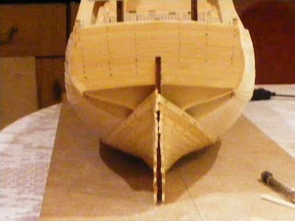

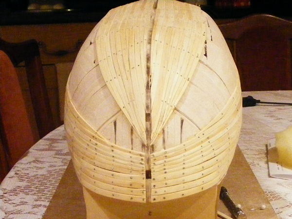

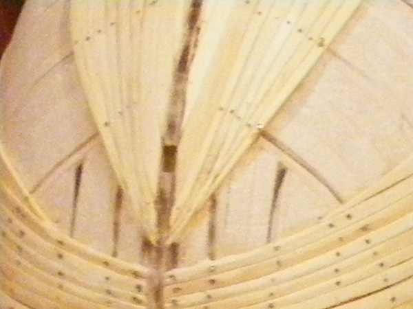

#509 Posted : 16 February 2013 23:05:38
Progress on issue 24 planking. Have completed the next 3 rows on the bow and made some adjustments to ensure the planks lay where they wanted to lay and tapered accordingly... have to say am a lot happier with how it is going now... The marks you see are actually pencil marks but can assure all it is smooth....
#510 Posted : 16 February 2013 23:09:25
Not quite finished the stern, still have the wedge piece to fit on one side followed by the final plank on each side... found the best method of shaping the planks to follow the last part of the curve to the keel was steam from the kettle... again am very pleased with how it is going... fiddly but very enjoyable....

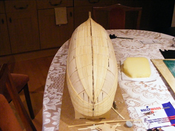

#511 Posted : 16 February 2013 23:12:09
Thought I'd post a couple of pics with the old girl the right way up... must say I love the pic of the stern, showing some nice flowing curves....BigGrin BigGrin
budgie
#512 Posted : 16 February 2013 23:23:22
Joined: 20/03/2010
Posts: 1,199
Points: 3,473
Location: Glenrothes
BigGrin Coming along beautifully Gandale Drool well done
as you seem to have a "grip" of this planking malarky
Cool Have you thought abought introducing "stealers" for the second planking layer
Crying Only asking so i can copy once i start my buildBlushing
