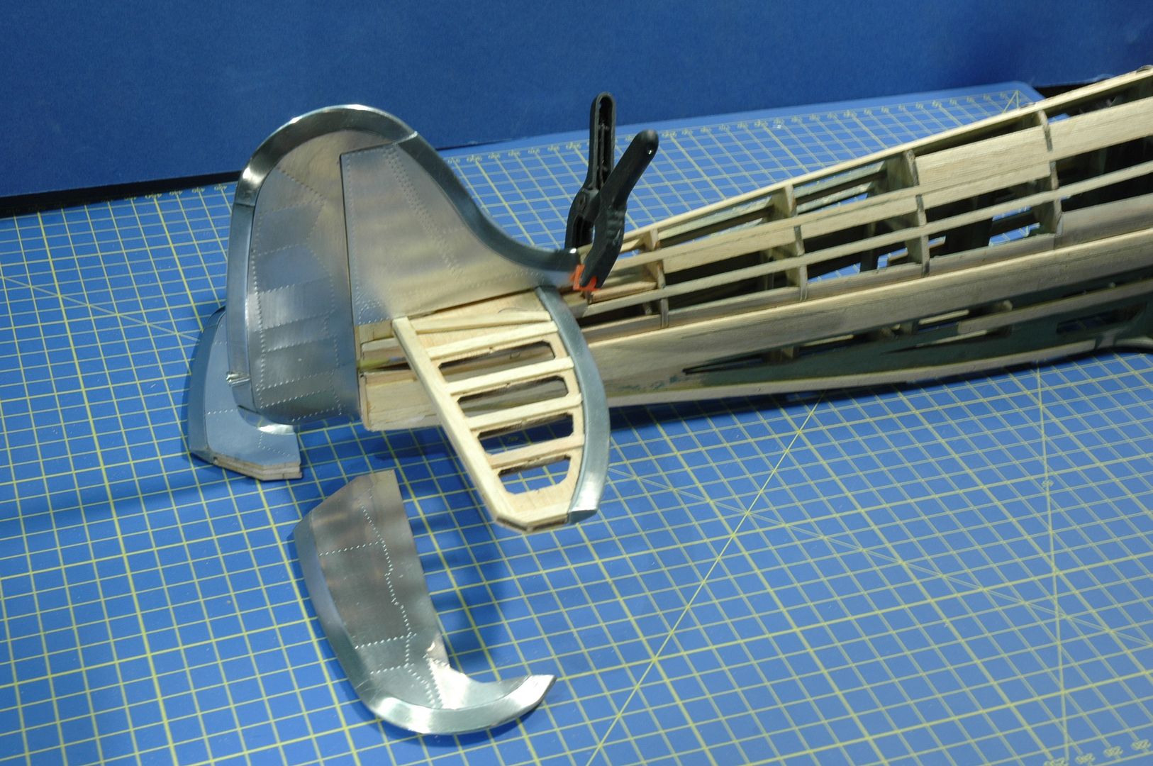

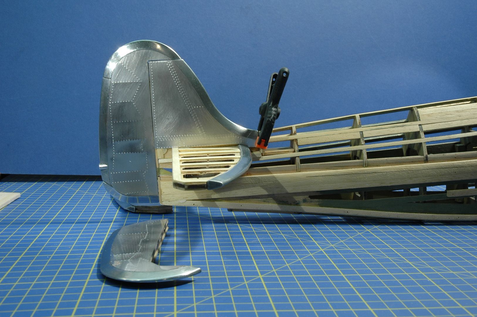

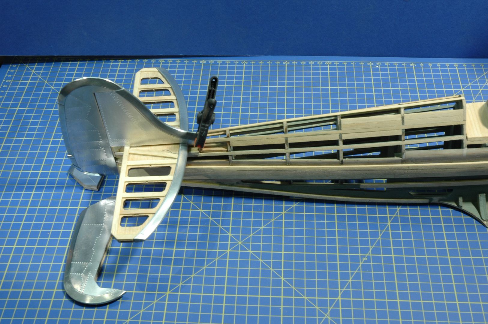

UPDATE:SPTIFIRE.
060316.
TAIL RUDDER SECTION.
REAR LIGHTING WIRE.

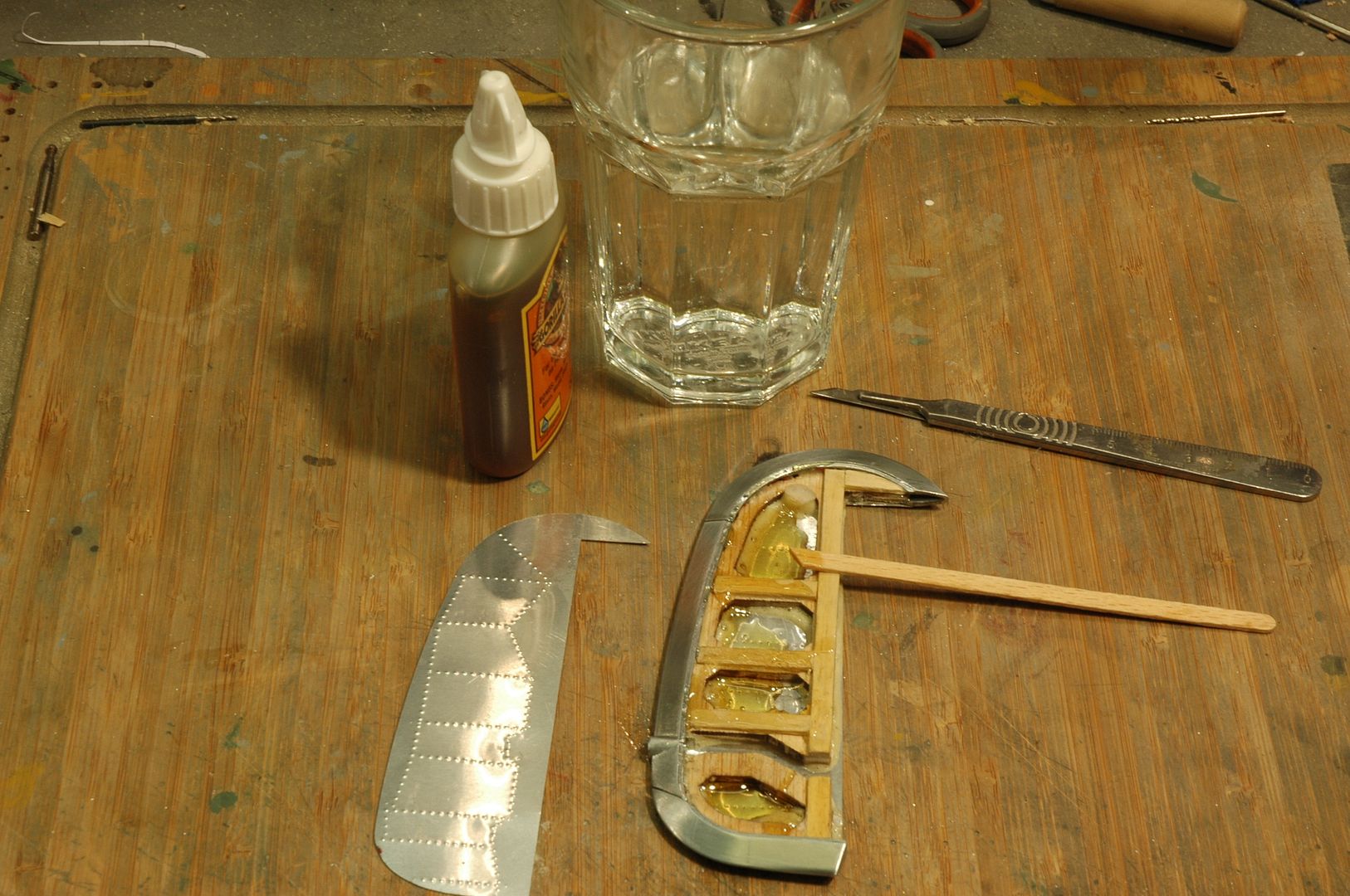

TIP: Metal Plates: Make adjustments to fit before riveting this is very important or you can lose them if you adjust afterwards.

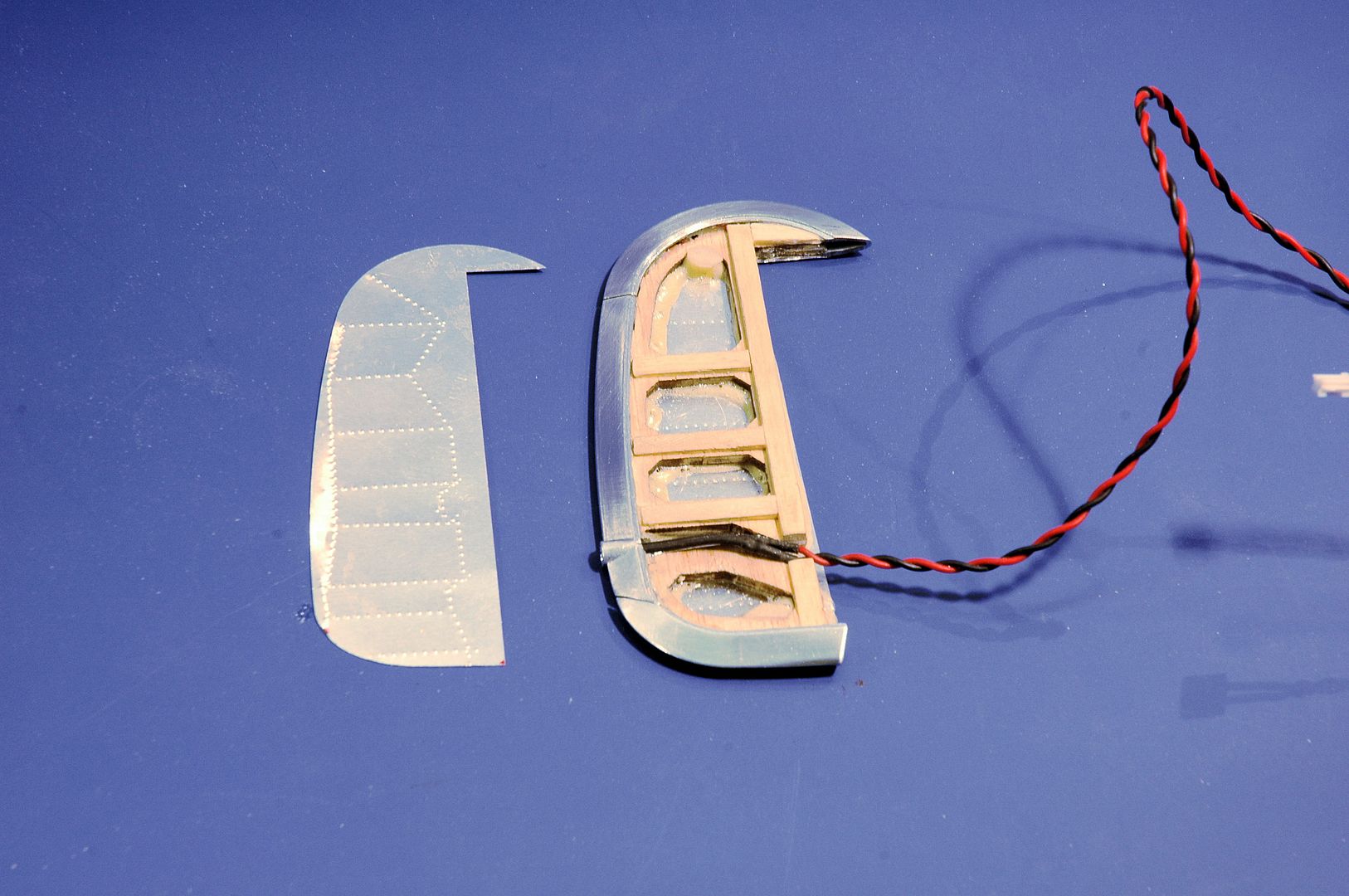

Rudder section after making adjustments to the metal plate to fit, also shows where I have cut out a small section of wood to allow lighting cable to fit.

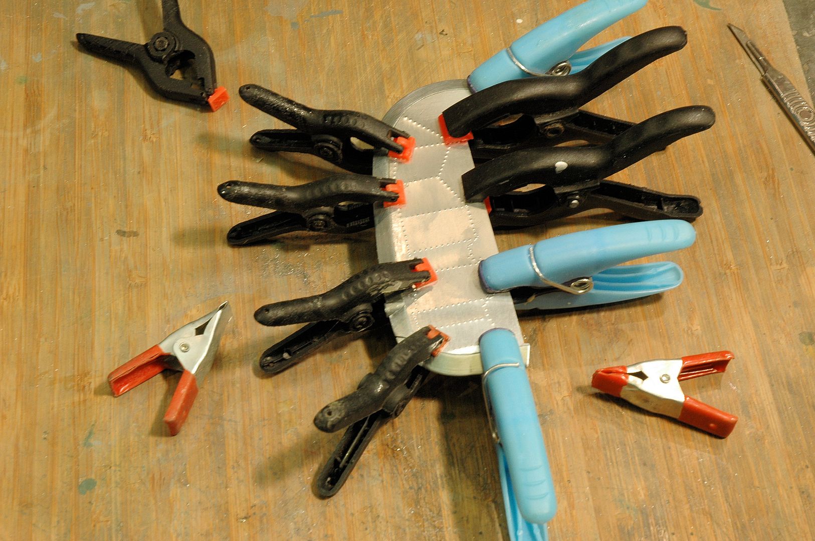

Metal plate rivet marked and ready to be glued in place, also shows a check fit to cable.

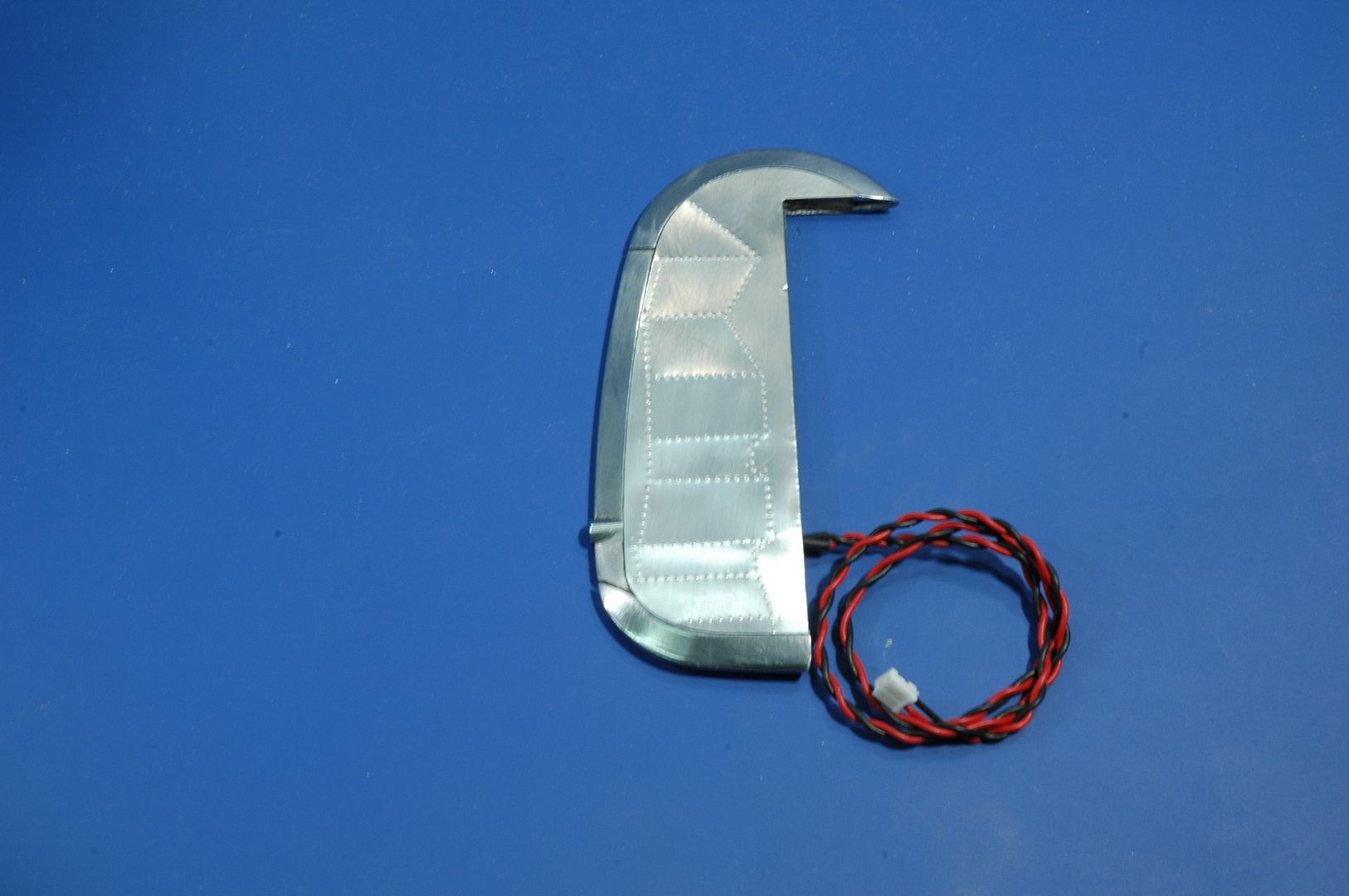

Remove cable and clamp plate to set 24 hours.
Final picture with metal plate and rear lighting in place.
Next will be Tailfin and Stabilisers.
Thanks for looking.
Trev.

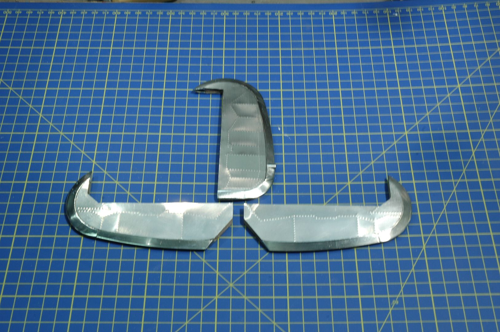

#512 Posted : 10 March 2016 09:52:36
UPDATE:SPITFIRE.
100316.
METAL PLATES TO ELEVATORS.
This shows the Rudder and Elevators complete with metal plates, fitted top and bottom with rivet markings.
This shows Tailfin/Elevators/Rudder with metal plates fitted.
The next part will be to make slits to fit hinges into the tail rudder and stabilisers.
Trev.
