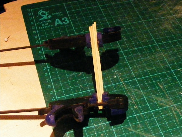

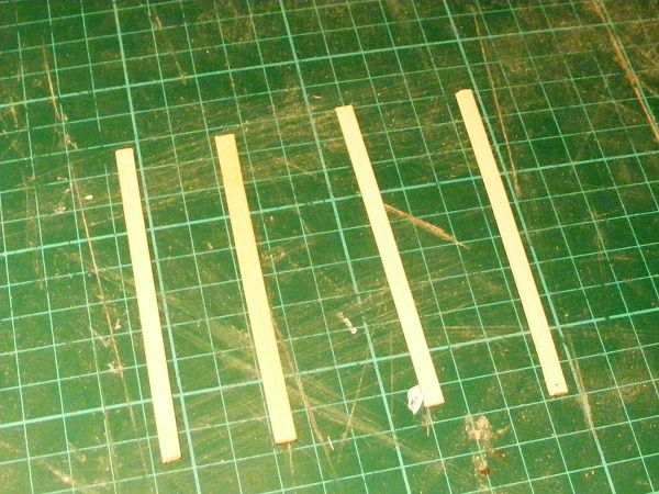

A little more progress tonight. Decided to get to work on fitting the brace pieces at the base of the transom.... Started by using 4 off cuts of bamboo roughly the same length... Kept the length deliberately long, this way it gave me something to grip when it came to shaping.... Glued two strips together using PVA and clamped the whole lot together and left to set..

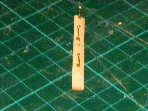

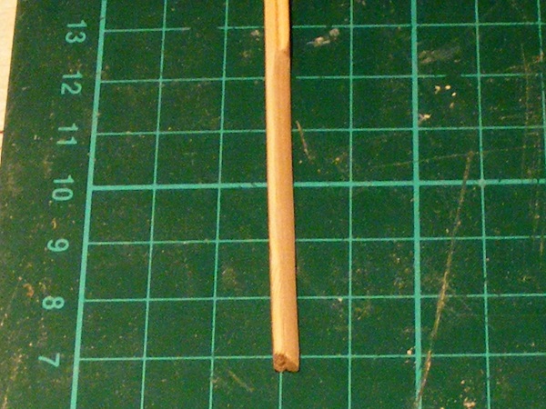

Took one of the strips and roughly marked the length required. Shaped the strip using a small sanding block with medium grade sandpaper to get the rough shape, then gave it a fine sand.... Once complete then cut to length and filed to ensure a good fit...
#524 Posted : 18 February 2013 23:48:06

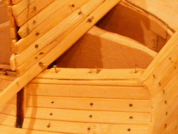

Marked and predrilled .5mm holes for the pins. Set the pins in place and finally glued and pinned in place. Will now leave to set prior to final shaping with a fine sanding block... That's tomorrows task together with fitting the other side..... Happy building fellow builders....

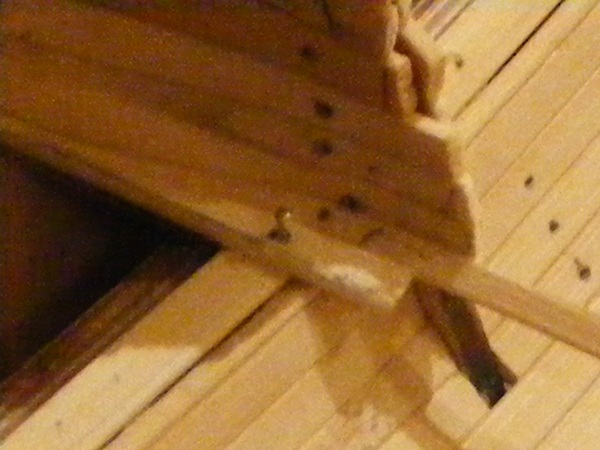

Started on issue 25 tonight by working on fitting the two small wedge pieces to one side of the stern.. This took a fair amount of time not only using steam to get the correct profile but after shaping I found it still wouldn't sit right Cursing Cursing , not until i chamfered the joining edge of the planks... Perserverance got me there in the end and have to say I am pleased with the final results, well worth taking my time over.....BigGrin BigGrin Should sand nicely...

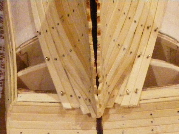

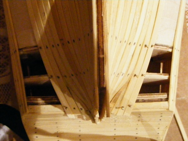

More of issue 25 planking done today.. Got the two small wedge pieces fitted to the other side of the stern, again fiddly but worth the time spent. Also managed to fit two complete rows of planks to either side of the hull. Found I got a much better fit between the planks when I chamfered the joining edge of the new plank.... Happy with the results so far. Tomorrow hopefully will get the last row fitted on either side just leaving the work on the lauch for the rest of this week.... Happy building all and thanks for looking in....

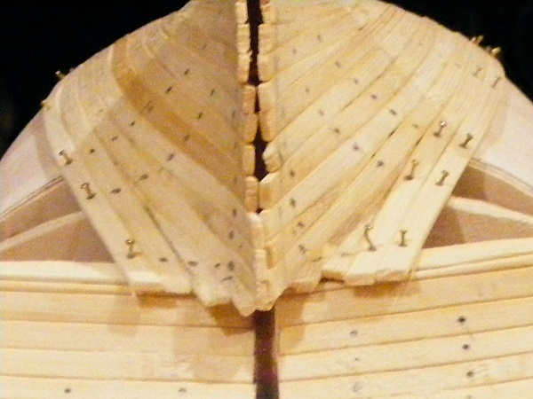

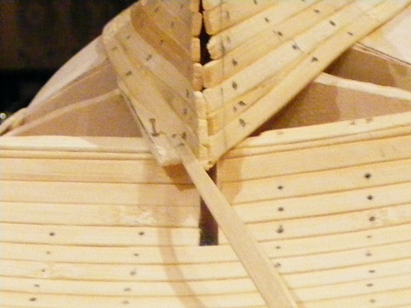

#539 Posted : 23 February 2013 22:58:44
And of course the bow and a complete image ....
