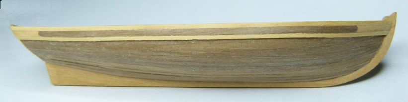

Started the second planking and decided to put in a stripe at the top, I`ve seen an old painting with this and also some models have it, after researching small boats looking for details on this build think we have pretty much a free for all on the colours, as you can see by the photo I use the same method, I glue the plank on the bow, leave to dry then glue the remainder down

Cheers lads appreciated, as for the state of the bits in the box stevie-o I`m sure plenty of us have had something similar, anyhow on with the build, as I continue with the second planking I file the planks to get as near parallel to the keel as possible, on my other two scratch boats always had to put in funny short bits at the end or in the middle, getting closer not there yet, the photo shows where I am, its the last plank that will be tricky

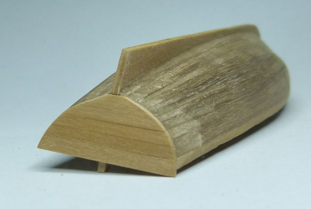

Thank you all for your kind comments appreciated, finished the second planking on the launch, at this point we can safely remove the internal ribs because the second planking has laminated the boats shape, as you can see by the photos I dont put in too many ribs, only enough to hold the shape, more at the front to form the curve, the boat is very strong with the ribs removed, this allows us the freedom to work on the internal details, etc.
