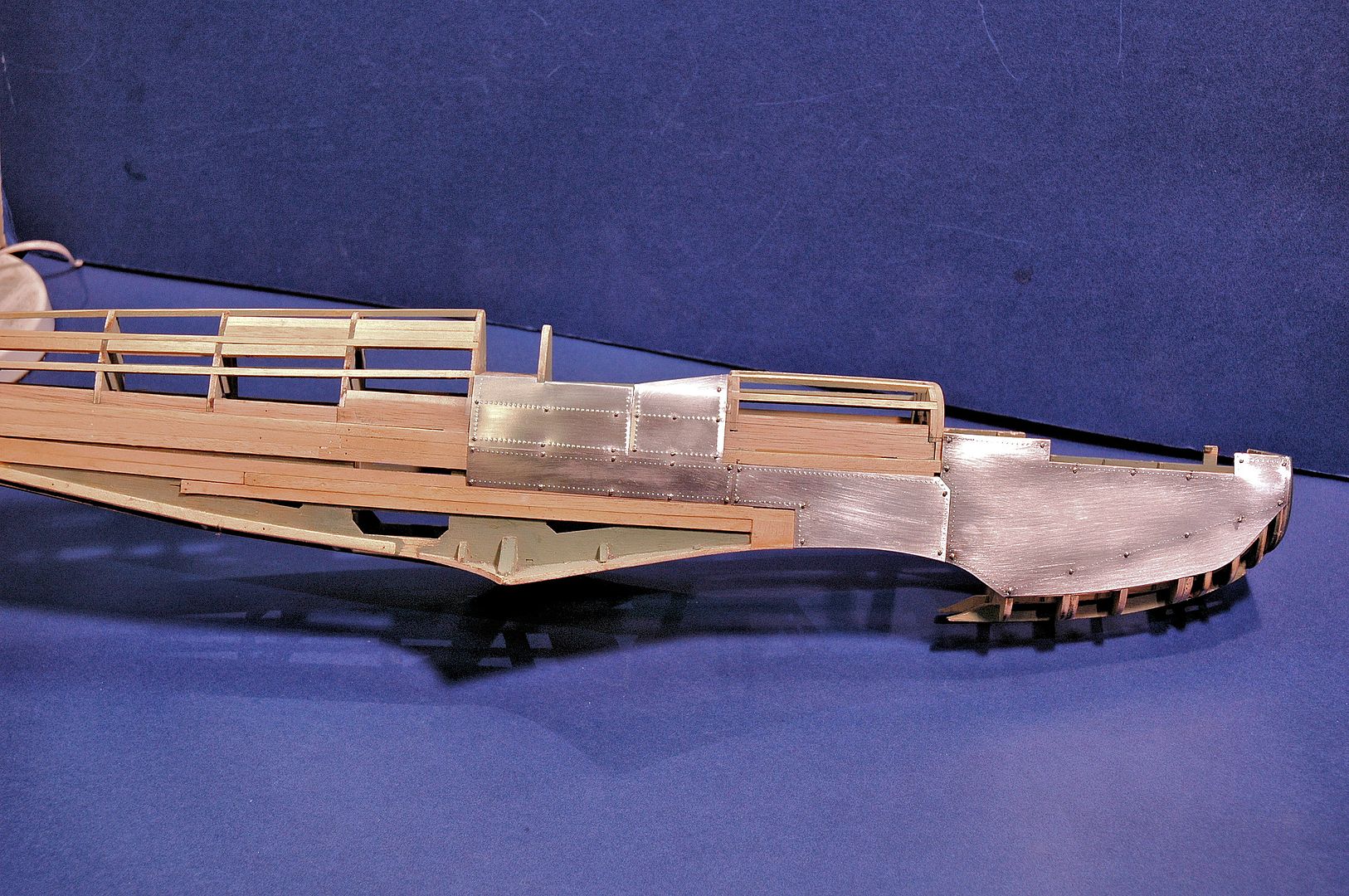

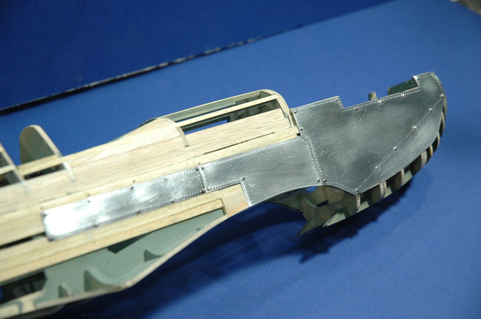

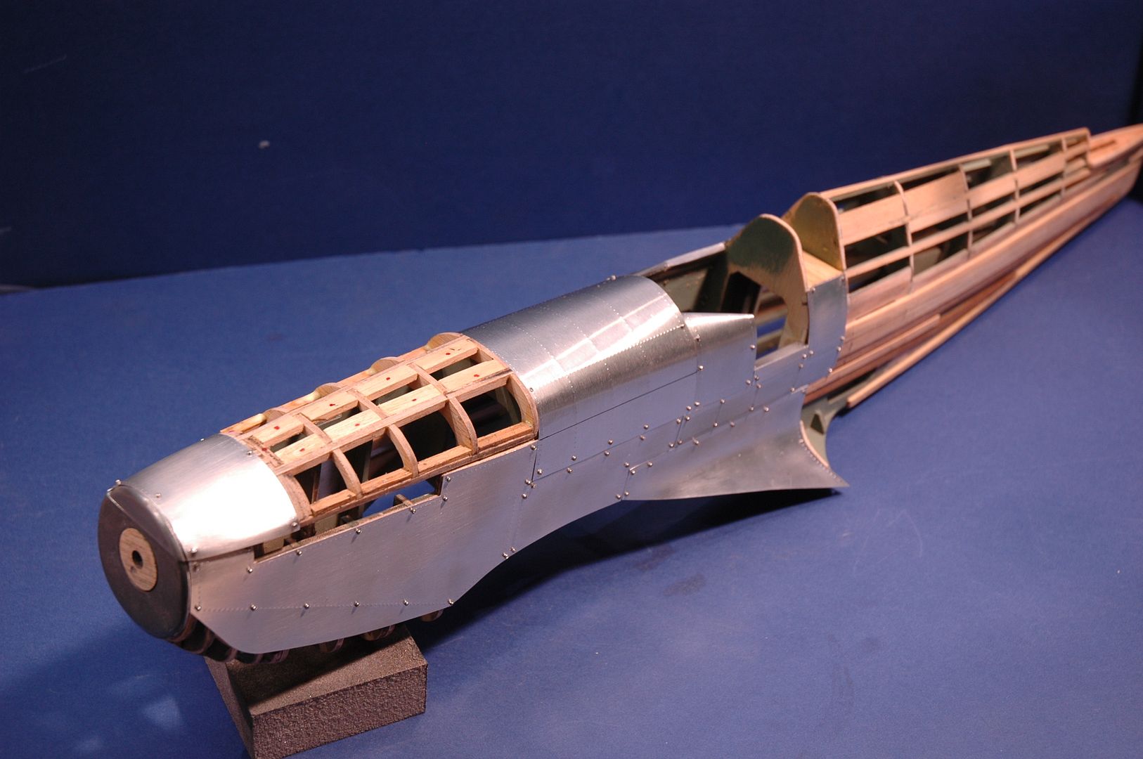

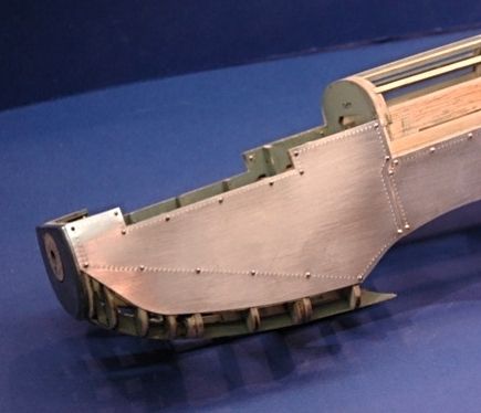

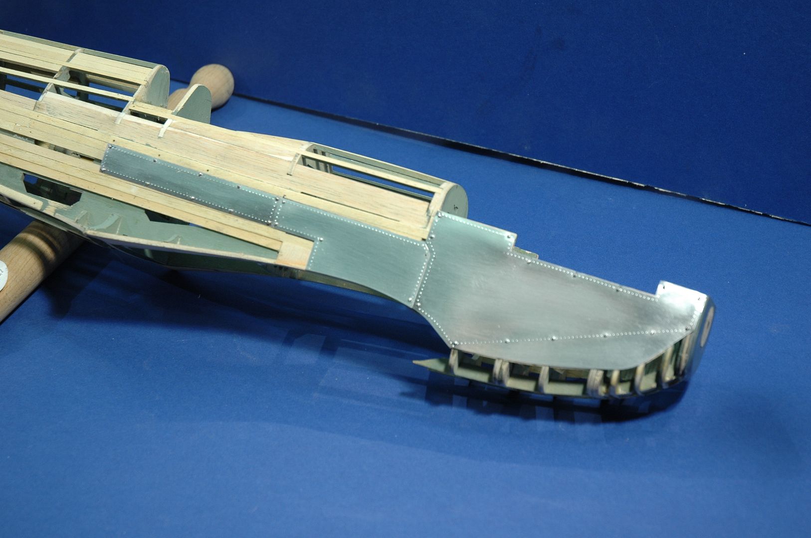

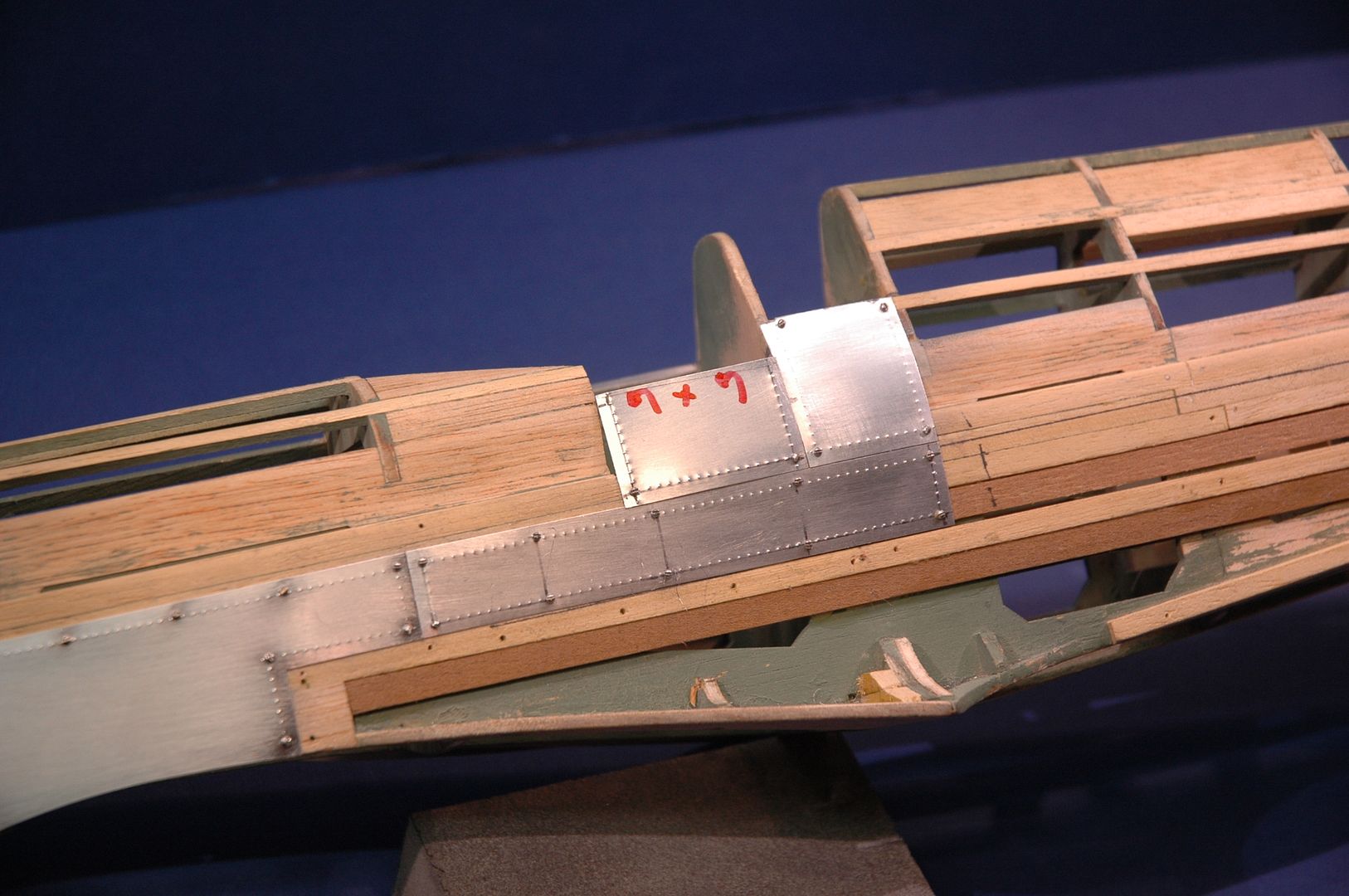

UPDATE:SPITFIRE.
130316.
NOSE AND FUSELAGE PLATES.
Today I have rivet marked and fitted 6 metal plates to the Nose and along the Fuselage. Two plates had to be rounded to fit correctly plate 19 which has to be levelled off within the cockpit area. The second plate 14 has to be shaped to match the fuselage and then checked with the wing to see that it is in line, all the rest were straight forward.
This shows the first three plates Nose plate this is the starting point make sure you have set it straight and run a pencil line all the way to the end of the fuselage as a guide.

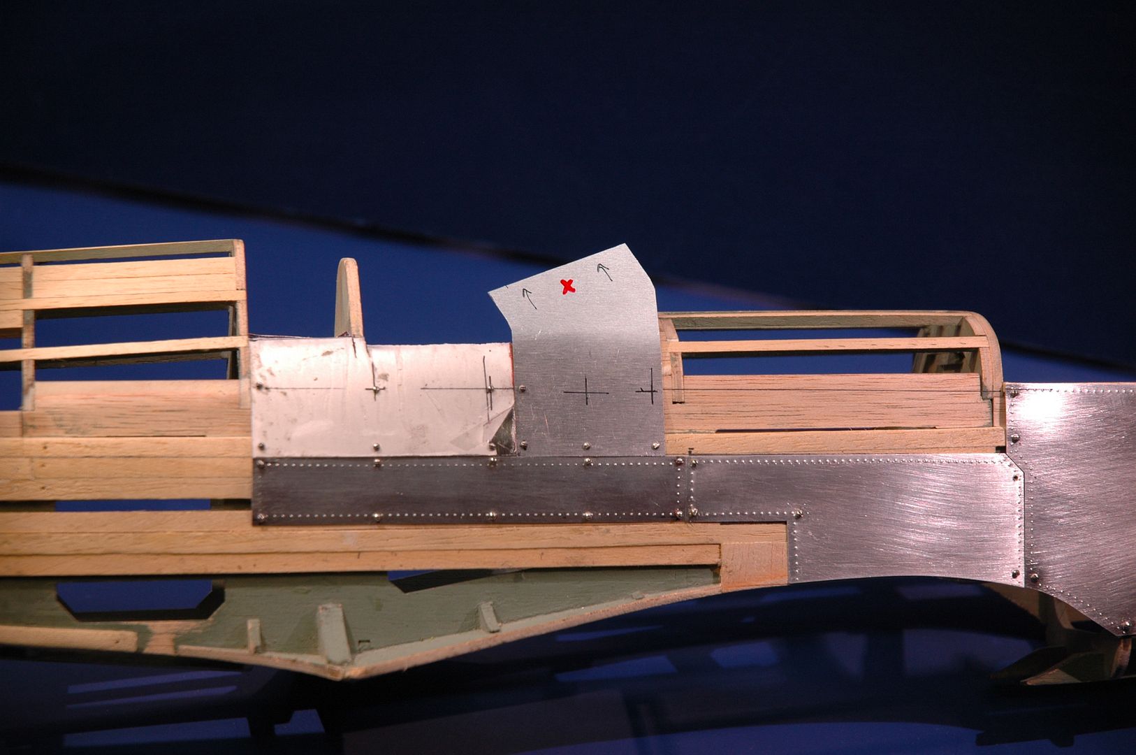

This shows the cockpit plates, first part I levelled at the wood edge, and the next part I folded forward over the side of the cockpit edge. Tip mark the back and scribe then fold.

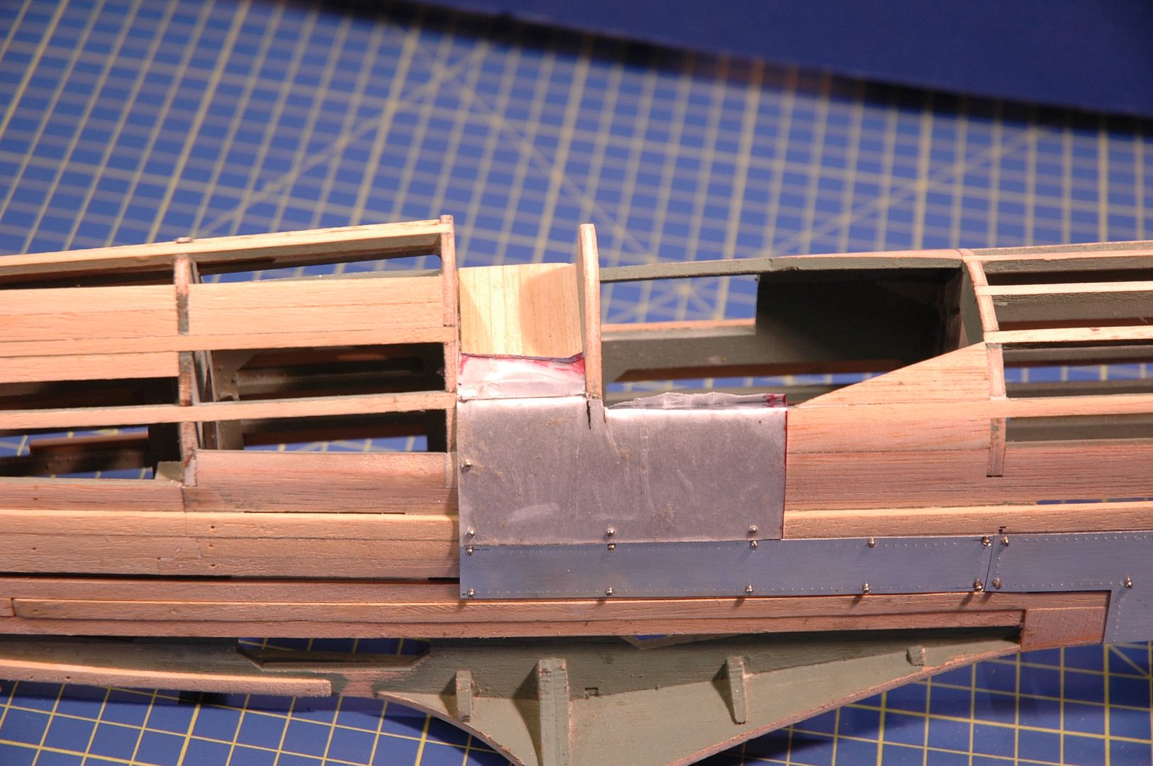

Take your time with this part just fold forward and over, try and pre-bend and then fit in this picture I have fitted more pins to my build help hold it down.
This shows P14 shaped to match the fuselage when fitted check to make sure it lines up with the wing.
Thank for your time.
Trev.

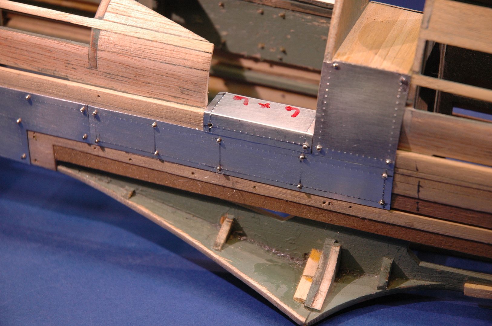

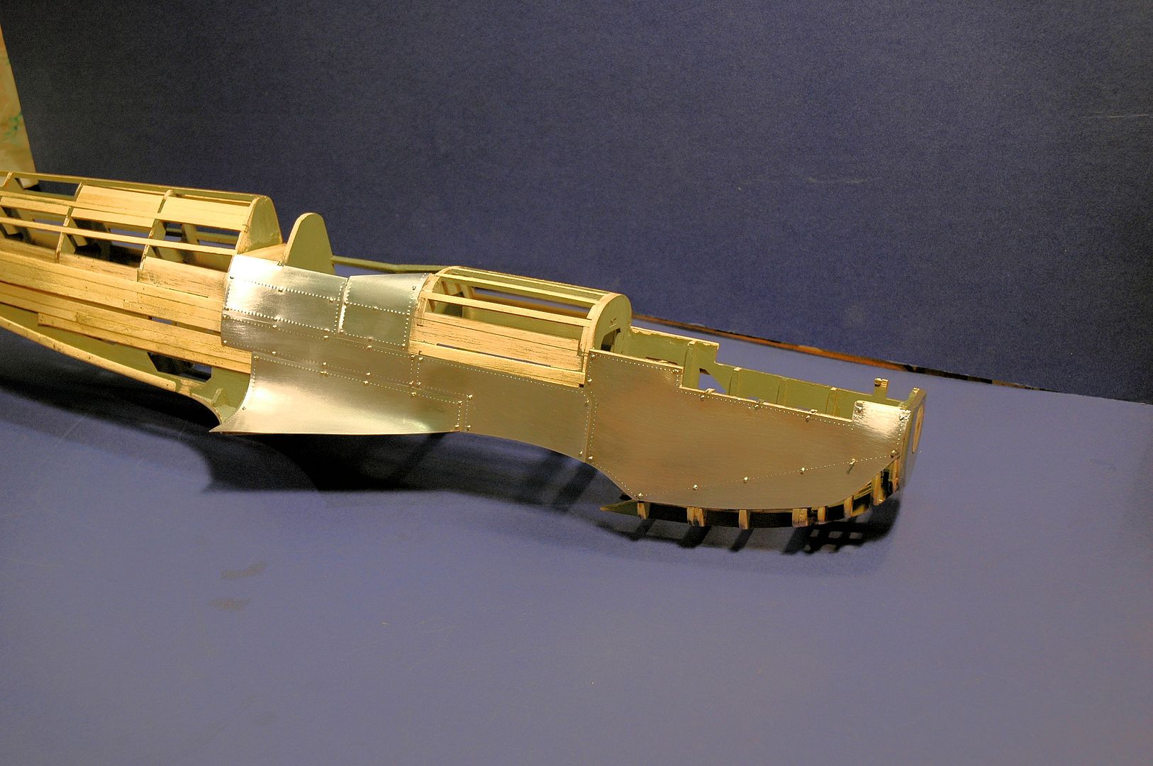

#538 Posted : 04 April 2016 21:14:36

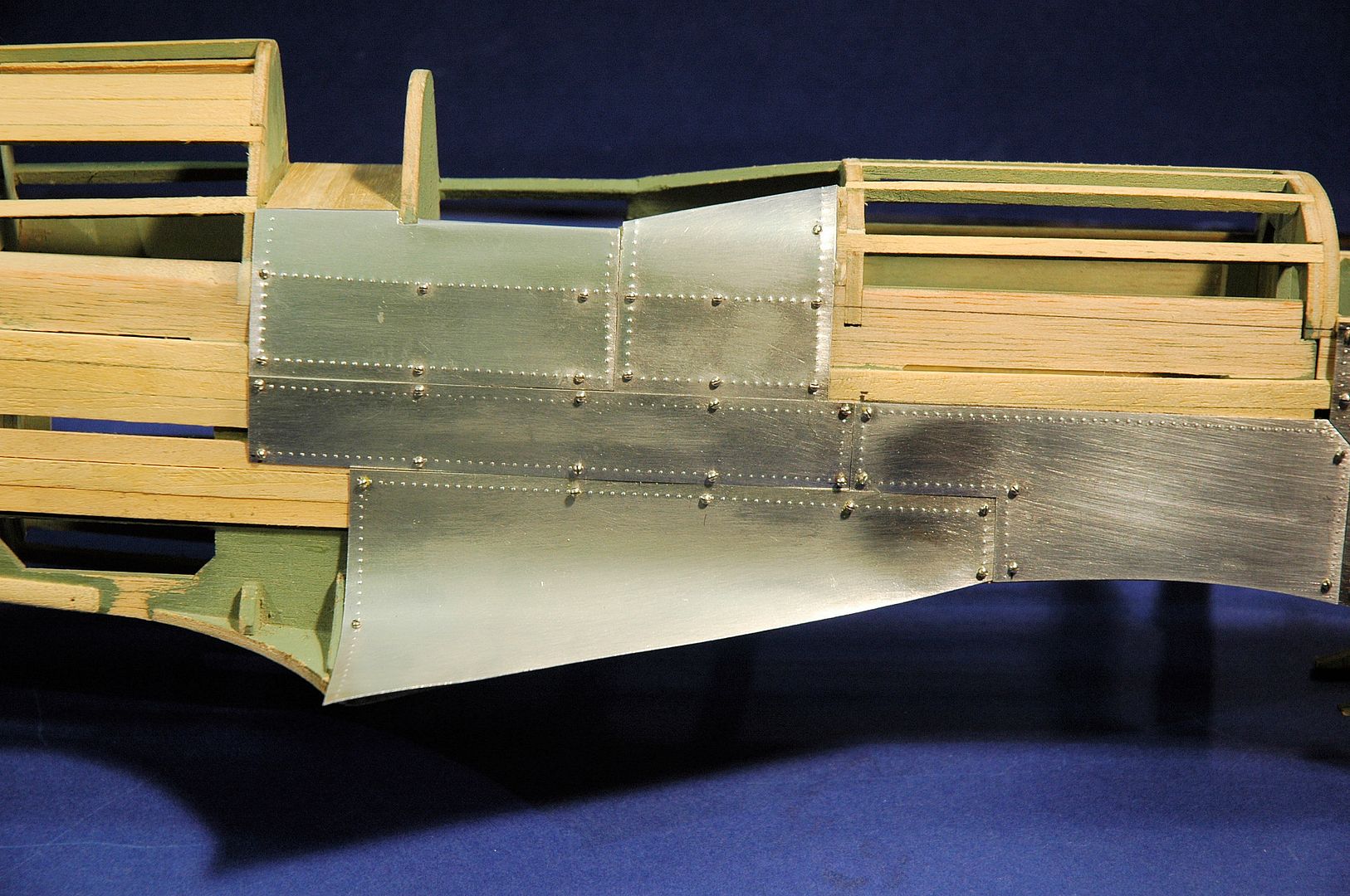

UPDATE:SPITFIRE.
040416.
FITTING METAL PLATES TO PORT SIDE.
First picture shows the large plate No 2 fitted to correspond with Starboard side marked and riveted.
Next check that plates 12/13 fit the same as the Starboard side these are the two plates that follow along from No 2 under the Door plate.

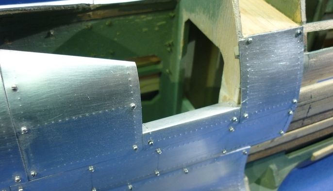

This shows plate 6/7 in position, mark the back with a pen or scriber remove the plate and cut of excess.
Also on this picture you can see the I have fitted plate No 17 which forms part of the door way.
This shows metal plate to be mark were the bottom of the door frame meets the metal mark with a pen. (Remove scribe snap off then sand).
Needs a tidy up but all ok.
More soon
