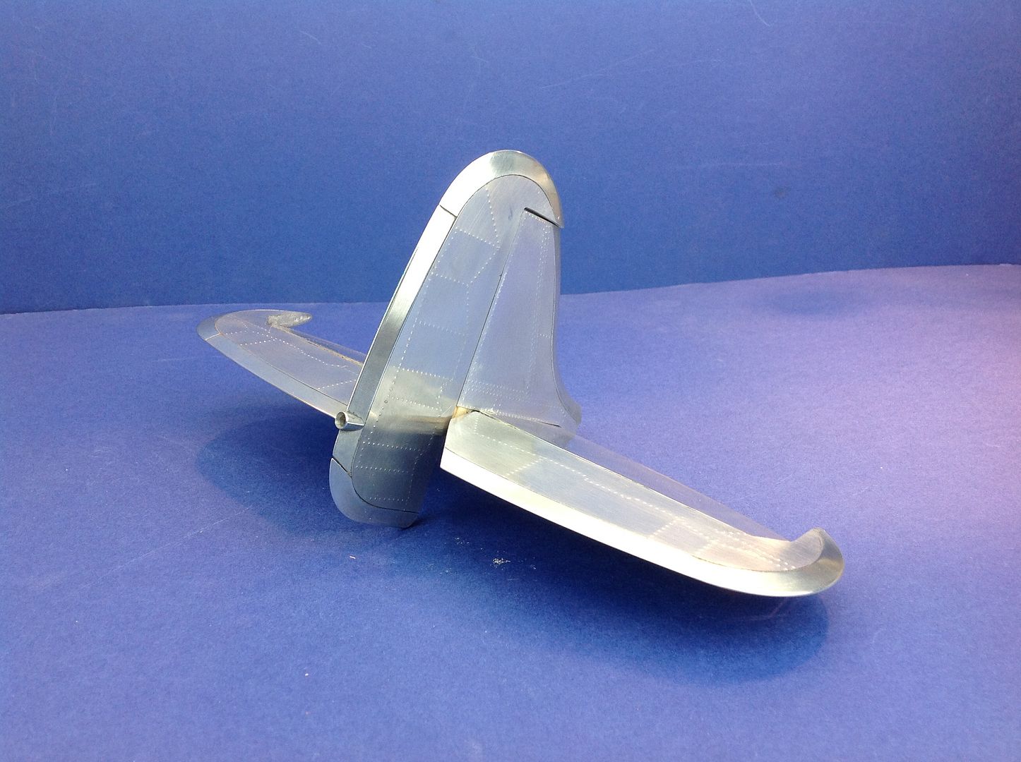

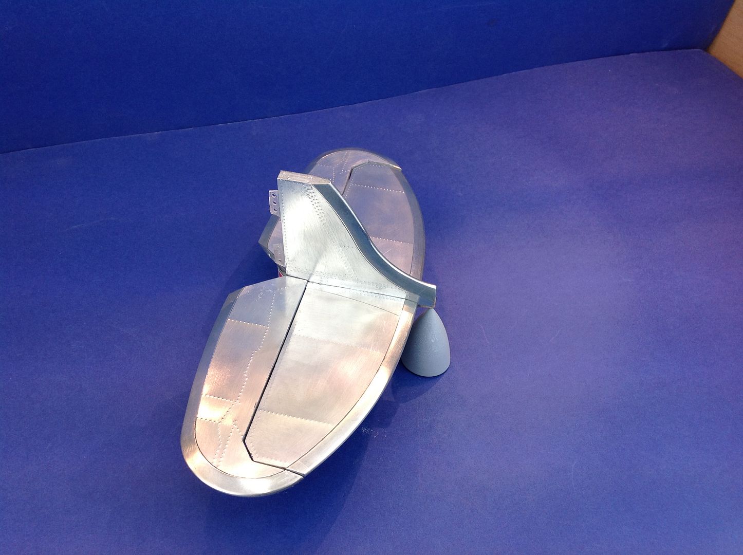

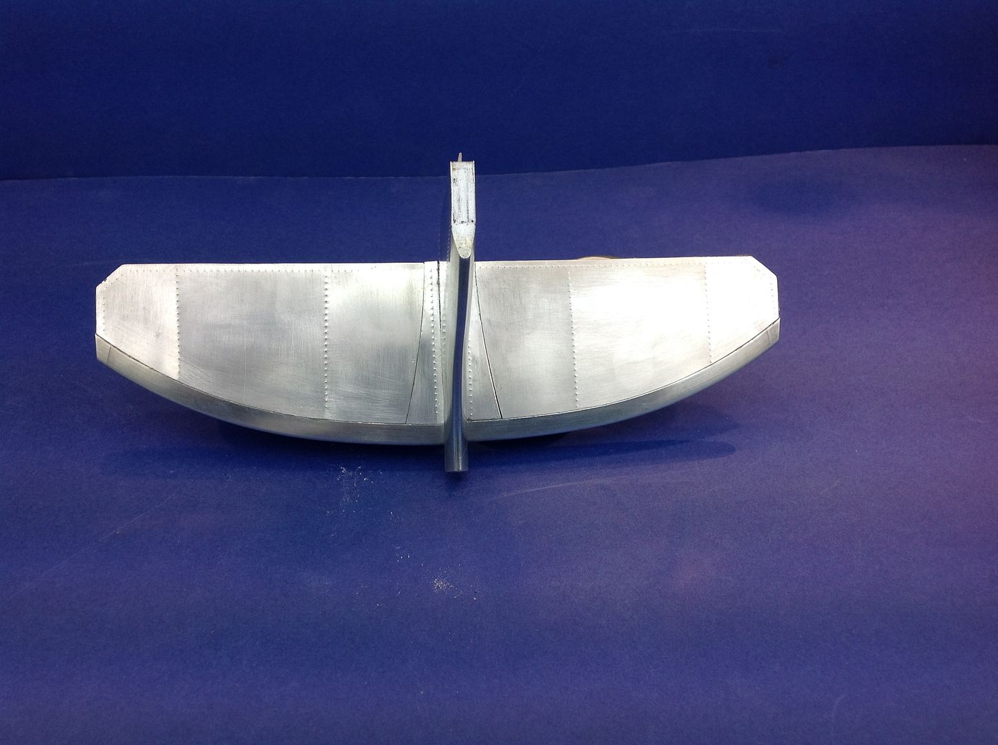

UPDATE:SPITFIRE.
300516.
STABILIZER TAIL PLATES.
Today I have fitted 4 tail plates, they fit on the upper and lower sides of the tailplane. First I test fitted all the plates to make sure of a good fit then the next part was to roll the rivet marker I set 2mm from the edge.
Next the smaller plates I think you will have to adjust these 4 plates there the ones that fit next to the tail fin and stabilizer top and bottom, on these I found that it was a lot quicker to adjust by filing the straight edge not the curve edge.
This shows the top stabilizers fitted.
This shows the under side fitted.
These pictures show the tailplane ready to be fitted to the fuselage.
Thank you for your time.
Trev.
