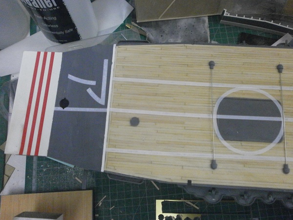

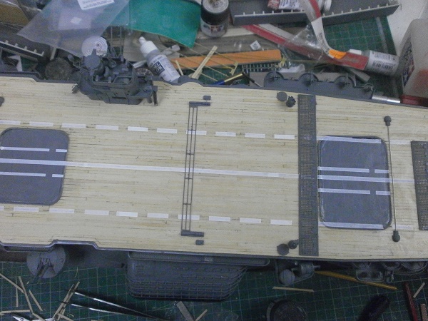

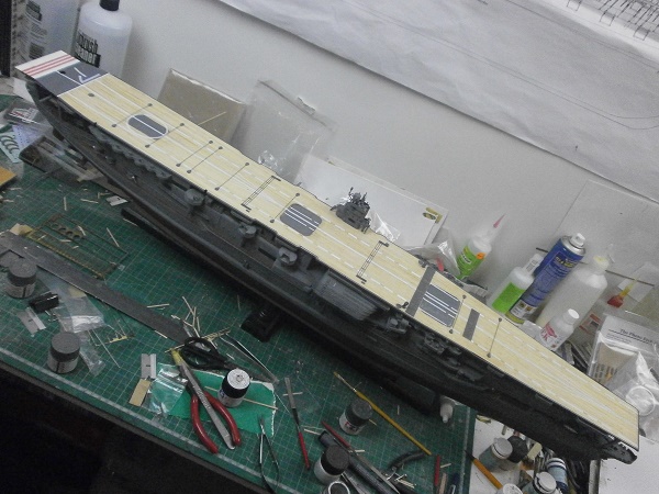

#568 Posted : 06 December 2015 20:08:54
After finishing the planking and sanding it back three coats of gloss varnish was added then sanded back before the last coat was put on. Using gloss varnish enables the decals to be placed without leaving the silvery edge you can get with matt finishes. Once the lifts were fixed and the decals were placed two coats of matt varnish were applied over the top to seal it all in. A word of warning on the decals there fragile so be careful when you apply them to the model. After the varnish dried the central deck furniture was added such as the arrestor wires/cages and the two forward wind breaks. Next the four search light covers were added along with two search lights midships and lastly the bridge was fixed to the deck. Still lots to add and more soon.

Nice work on the deck Andy and well done on getting those decals to sit down properly on a wooden deck. They do seem to be a little transparent in places though, but I think that maybe helps with creating a scale appearance, as being too opaque and bright may have looked a bit too bold and contrasting against the mainly grey superstructure?

That's a beautiful finish you've achieved with the deck! I must admit I was a bit sceptical that such a good finish good,be achieved with decals over wood but you've certainly put my scepticism in its place! ThumpUp ThumpUp

@ Dave its no big secret with the wood deck 4 coats of gloss varnish will seal the wood and allow the decals to go on without any problems all thats needed after is a couple of coats of matt varnish to get it back to the scale type look.

Hi Andy do we get all the arrestor wire`s etc in the build or are they your enhancements ? also are you putting a rising sun on the deck? cheer`s phil
#577 Posted : 09 December 2015 20:21:58
BigGrin Hi Phil
All the deck furniture is provided in the kit as shown so far along with the side nets and supports I have yet to fit.
