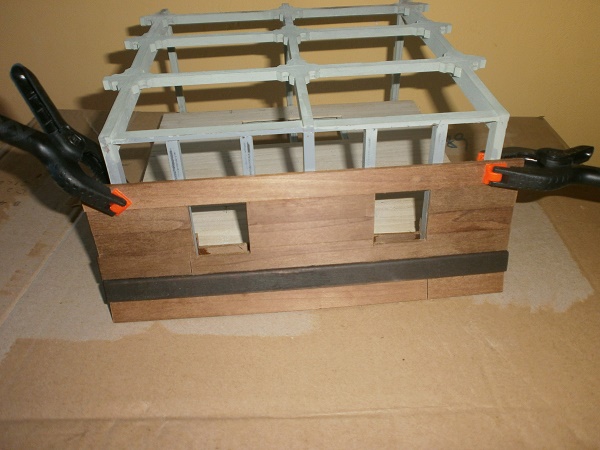

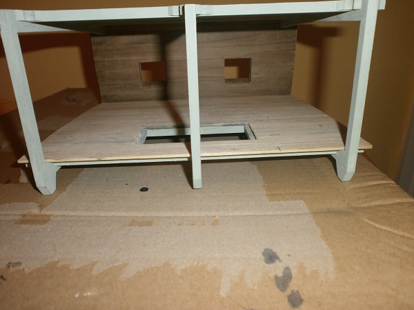

A small amount of progress has been made the lower planking has been sanded back but need to redefine the trenails/joints. Finally the outer and inner hull planking has been started.
More soon

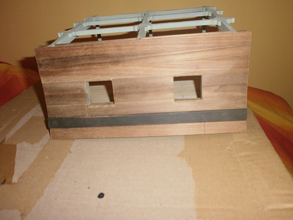

The inner and outer hull planking is now fixed and the upper and lower gun linings attached still needs some finishing here and there but starting to look the part I think. I obtained some krick blackener for the brass parts and it didn't turn out to well until I had the idea of zapping it in the microwave for 2 minute blasts then cooling and doing again worked a treat

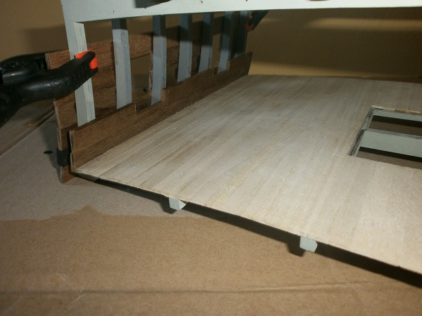

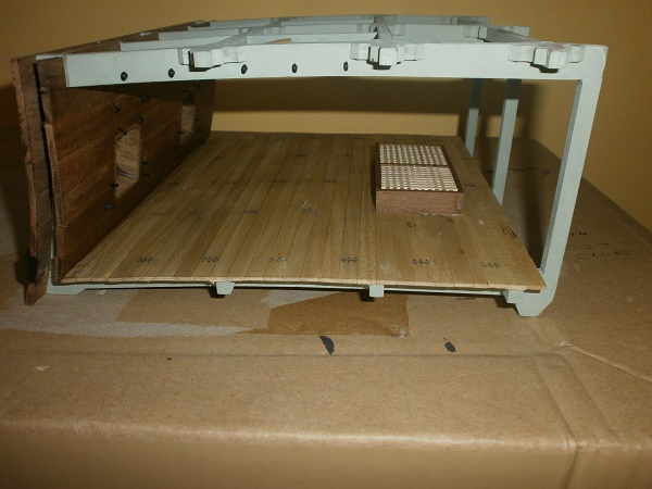

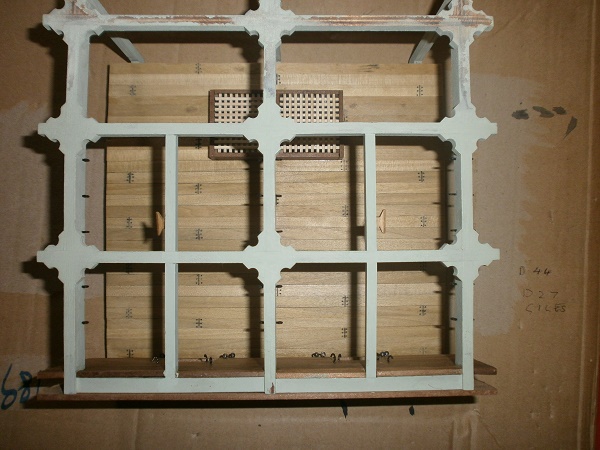

Small update on progress.
The cannon ports have now been fully lined and the central upper cross beams added as have the blackened upper eye bolts.
What took up most of my day was the measuring and correct location of the eye bolts and rope holes around the gun ports as the measurements provided are dubious at best and somewhat enigmatic at times. It looks about right to the eye now though so im happy with it, Finally the inner and outer has had a single coat of matt varnish to seal everything and give an idea of colour.
