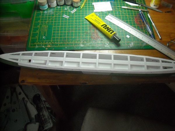

This model has the hull in three parts, fore, middle and aft and we start with the aft section. After that the fore section and the middle will be added last because we will need to cut that to size again.
I will do the port side first, which you can do because unlike with a wooden model, the planking won't warp the hull if you do one side only. Smile
I cut out the side, and used my fingers to bend the back slightly so it will more easily 'roll' around the rounded stern former. I then used a pair of tweezers to slightly curve the back edge to het a smooth flowing line from the stern former forwards.
The whole idea of this bending is to 'loosen' the fibres in the cardboard so that it can be more easily formed in the right shape, not to give it a pre-shape.

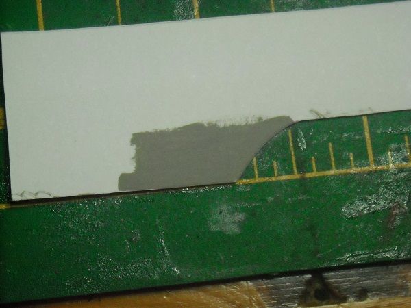

Then I painted the edges with mid grey paint as well as a section on the back where it will be visible from the inside when glued.
After letting it dry, which doesn't take that long with this acrylic paint, I UHU-ed the sternformer and the first section until the hull former 4 and on the bottom and top tabs. After letting it dry for half a minute I put the side in place, starting from the stern, making sure that the top of the side was flush with the deck. I thin pushed down the bottom of the strip against the waterline former tabs and the former tabs. Because of the UHU I was able to make small adjustments whilst the glue dried further. When I was happy with the position I used a toothpick to put glue on the next section (from hull former 5 to hull former 4, including the bottom and top tabs) and keeping flush with the deck I glued the side to that section.

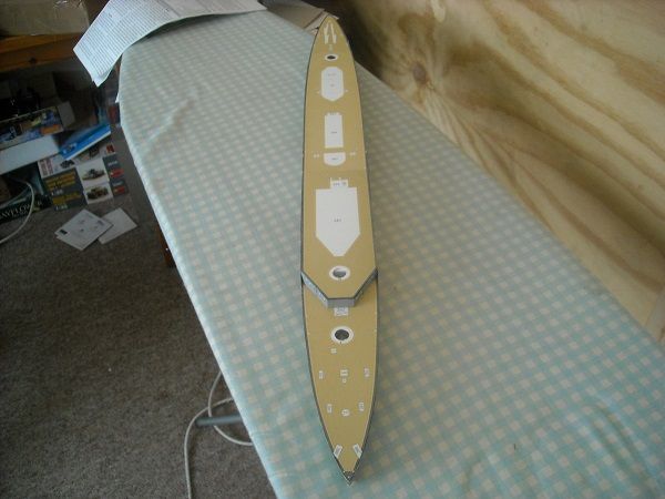

I continued to do the same for each section (from hull former to hull former until it nearly reached former 8.
And the result?
Not bad.
But my eyes are hurting now, so the bow section will have to wait till tomorrow.

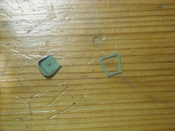

Hole for the hawse pipe,
the components,
and intermediate step (the collar has been edge-painted),
the two combined,
and finally glued in place .

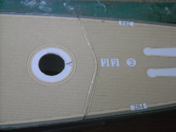

Just like yesterday, I started at the bow former and added glue to the former, bottom and top tabs and first former tabs. Then with the tip of the hull side formed I lay the side against the bow former and once happy with the shape and the position pushed it down then working from former to former until I reached the end of the side.

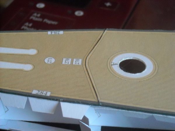

I'll need some black paint to cover the section in the first picture that can be seen at the bottom. This discrepency was probably due to the fact that the sides were meant for unstrengthened deck so are slightly too small for my model. But not a big problem.
Not bad. I put it aside to dry thoroughly and went back to the colour chart. Using a cut off piece of the deck, I think we have a match!!
I'll try the repair job on the bow joint, most likely, if for no other reason that that will be hidden so if it went wrong it wouldn't matter too much.

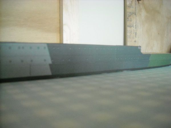

Still looking good so far but will need to blacken the bottom. but not nearly as much as I feared it to need..

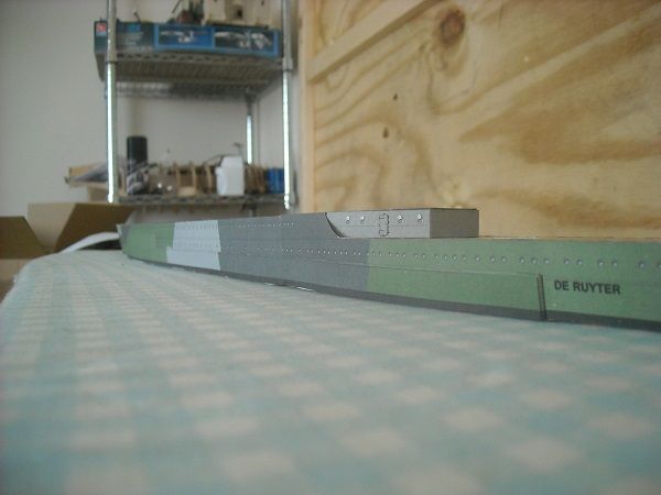

So, the armour belt.

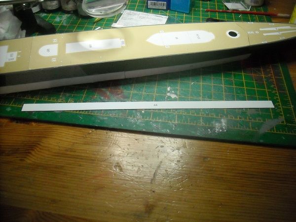

The first task will be to cut the first layers of armour. Don't get your hopes up, mind you. It's just white pieces of cardboard for no other reason than to make up the thickness.
So, a simple cut out
and glueing it in place after making sure I didn't glue it upside down and then did the second base armour layer for the starboard size. And, as per usual it was too long so needed to be cut to size.
But once that was done ...
(Did you see the already attached piece? No? White on white is hard to spot. But luckily the next layer will be coloured. Wink)
But it helps that you can get in from the inside, so to speak, when attaching parts on the outside, especially if you, like me, have a little bit of a strop and not use parts that the designer has decided that they need to be used, like the connecting strips that I did not use after being told too late to use them. The connecting strip has a function to keep the sides together and not having them did make this step a little trickier than it needed to be.
Anyway, the designer made sure that the inside would still be accessible
so you could say that he knows his trade where as I am ...... well, shall we keep it civil? An amateur, at best. Wink
So you ARE better off if you follow the designer of your model rather than me.
But my jokes are better, so it's really a toss-up. LOL
AND it turned out that those base armour pieces work just like the connecting strip but from the outside. That was nice, wasn't it? Unless this was another design-feature that the designer came up with to make sure that the model would still look good even if made by a .... what did we say?.... oh, yes, an amateur at best. Now that would be Sneaky, wouldn't it?
You know, my problem is that I sometimes think too much. Wink.

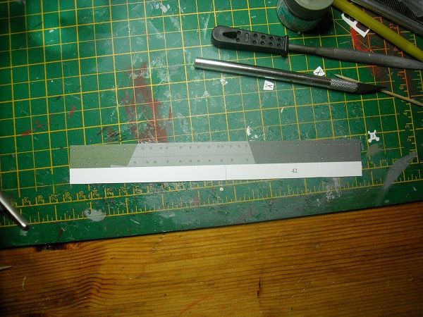

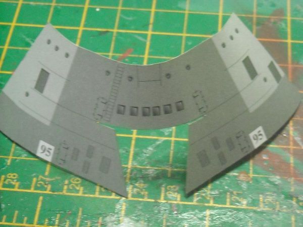

Anywayzzzzz, here is the next step, namely the outer armour belt pieces, this time coloured. Which means that they will need edge-painting. But not only that, the top of the armour belt has to be angled back and the angled top is about half a mm to a mm.
The best thing to do is like before to score the part before cutting out and then after cutting to use your fingernail to push down the scoreline, whilst keeping the belt at approximately 45° and to continue doing this along the whole length of the belt.
It won't look perfect
but very effective never the less.
Too bad that the good looks will be spoilt by the fact that the colour fields on the armour belt won't match up with the colour fields on the hull side in the back.
That is design, unfortunately and very little (well, nothing really) can be done about it.
The front part fits pretty well
and overall the effect is just wonderful as could be seen in the picture before.

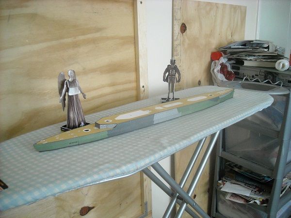

Too bad that this ship is so long that it is impossible to get everything in the shot and at the same time show all that wonderful detail. Mind you, that could very well be me and my cameratic skills (is that a word? Probably not.)
But you get the drift. Laugh

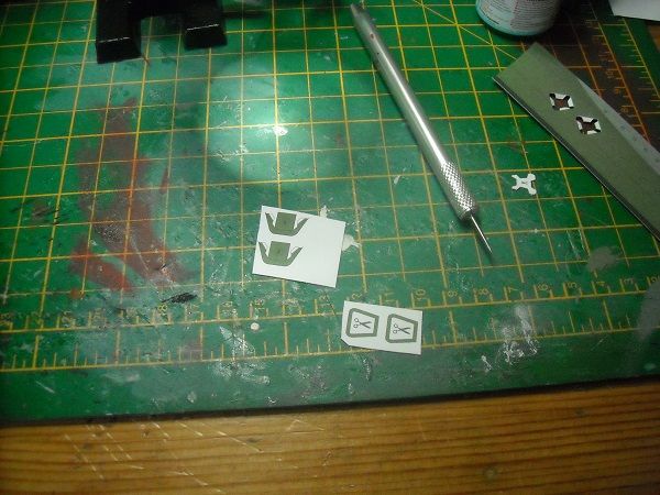

So now we have two more things to do in this hull-build, the previously mentioned 'thigamabob' and the anchors. (Apart from some repair steps to cover previous ... mishaps)
Anyway, I give you the 'thingamabob'

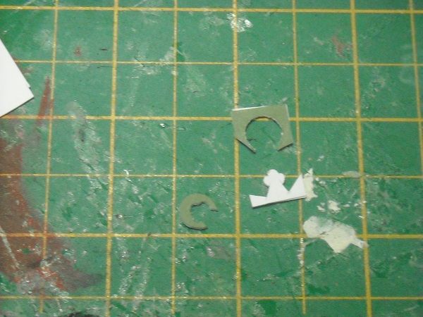

According to the instructions it is a half-ring, which I am sure is not a nautical term, so I will keep calling it the 'thingamabob' and because it is going to end up at the bow, it will be (for me) the 'bow-thingamabob' from now on.
Notice that the part consists of a half ring (with holes for whatever function) and a square of coloured cardboard. This means that the squares have to be cut out and glued back to back to thicken the part. But because the part will be double thickness and the curvature it will be best to 'stab' out the part after glueing and drying.
So, I took my best knife and started stabbing away.
The part was then edge-painted on the in- and outside and put aside to dry.

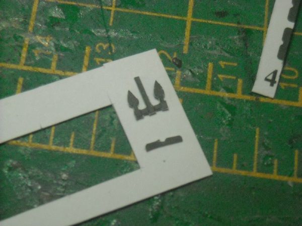

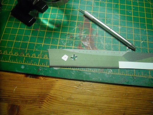

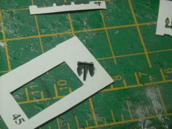

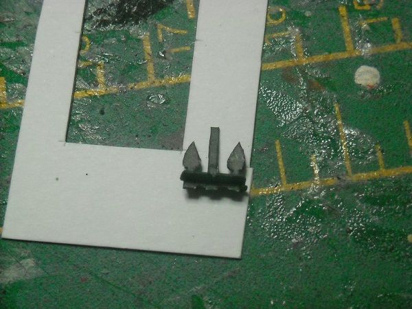

Which leaves us with the anchors, of which there are three, even though I have seen a number of pictures online where the aft port anchor was missing. I wonder if someone managed to nab it to sell for scrap when the Captain wasn't looking for a moment. But I will follow the instructions for once.

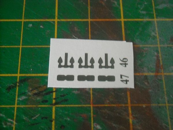

So, there be anchor parts.
Having decided to follow the instructions, I immediately had to scratch my head.
Confused Confused Confused Confused Confused Confused Confused
The instructions said: Glue anchors 46,47 to the hawsepipes.
Ok, but how? Where does 47 go with respect to 46? Confused Confused
It looks like a 'standard' stockless anchor, so I assume that 47 is the baseplate for the anchorblades. Having checked this on the internet I found that in all cases the baseplate is kept away from the 'ground' so I can't simple glue the base to the anchor.
Instead I'll have to cut the base in two and glue the pieces to either side of the anchors.
And because I am 'lifting' the base it would be best to make sure that the back of the anchor and baseplate is painted. I did that with a thick, acrylic grey paint. Not black because that would look all wrong even if the anchor was printed with black ink.
If you look closely at the print under a good magnifying glass then you will see that instead of a continuous field of colour, the printer actually put down a large number of dots. And even if the dot is black, because of the area around the dots, it will look less dark. So dark grey should fit better than a black paint.
But as I used a waterbaased paint the following occurred.
The cardboard started bowing whilst drying because the back got wet from the paint and the front stayed dry.
So a weight placed on it should keep the bow in check.

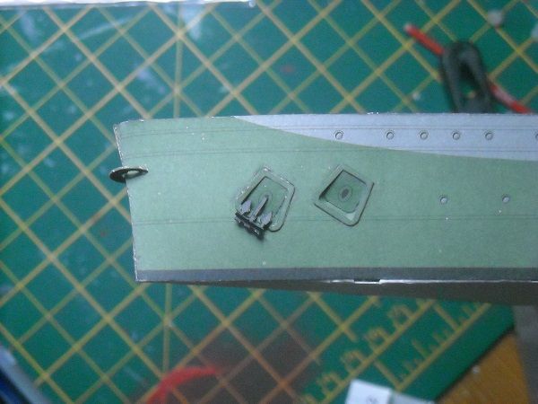

After drying I cut out the 'back'base and the anchor by stabbing again. It would be impossible to actually cut out those parts correctly.
I glued the base to the back of the anchor and stabbed the front out.
Note that I did not edgepaint the pieces because I was afraid that that would weaken the glue bond. As it turned out, when I tried to glue the front that the back came off anyway. Which was a blessing in disguise because I had glued it skewered so I could rectify that at the same time.
The end result
What difference edgepainting makes, eh?

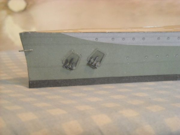

So that was then placed aside for prolonged drying. In the meantime I attached the 'bow-thingamabob'
And finally after 45 minutes sweating over it, the anchor could finally be placed.
Now 'only' two more anchors to do! RollEyes RollEyes RollEyes RollEyes Wish me luck, I might need it this time!!

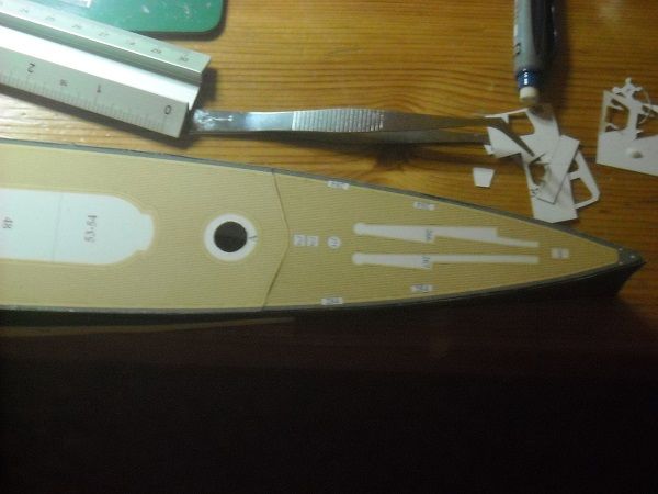

But it's time to show a bit more.
As I said yesterday, this is the last work to be done on the hull barring a bit of repair work.
But with all this effort that I put into the little lady, I decided I needed to hire some guards to keep her safe.
Here's guard No 1, standing guard over the ship with both port anchors attached.
LOL LOL LOL LOL LOL LOL
And here's the pair after the second came back from her tea break.

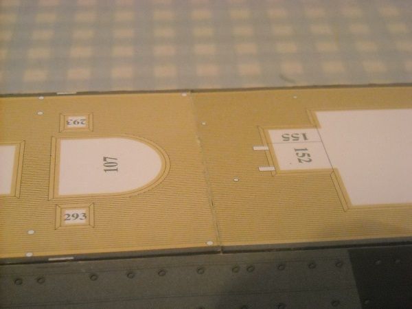

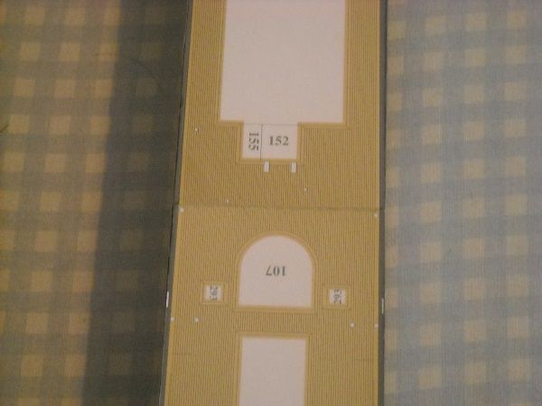

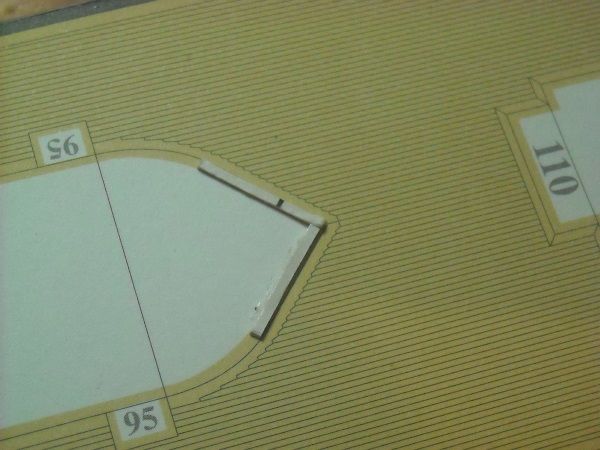

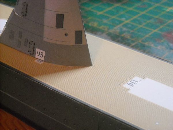

Remember the gaping .... uhhhh ..... gap that was visible when I put the decks together?
Now, at the end of the hull section I decided that it was time to try and tackle it. As I said I would attemp to rectify it in the front first.
This was the before situation.

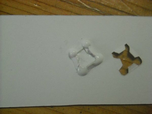

Here I started filling in the gap with PVA glue, of which I put a drop onto a piece of scrap card and using a cocktail stick I added little drips of glue, pushing them down them with my finger when they had dried a bit.
Then, using the paint I found previously (Games Workshop Bleached Bone), I touched up the glue.
The white spots are just a trick of the light, where the dried up glue reflects it.
But this is looking so much better that I will use it one the other gap as well.

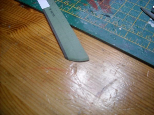

As I said yesterday, I needed some dark paper to lift her up.
Here's the paper (90 g printer paper) that I painted on one side
I then cut 6 4 mm strips off the sheet and put UHU on the back of one strip and put in on the waterline stripe of the ship.
The next picture showed the last strip in place and also shows the extend of the 'lift' which was less than one mm.
The strip was cut off and job done!
And here is a view of how it is supposed to work.
And just like yesterday I repaired the aft connection between the two decks.
Here's the before,
and here's the after ..
Looks good so another job done!

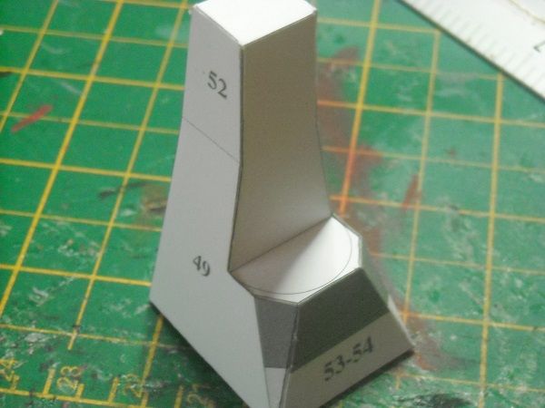

That we start with the frame for the bridge/conning tower.
After cutting it out, the part was scored and bent.
When glueing a box-structure like that it is best to work downwards from the top and to finish one side before goint to the next. I also decided to cut some more triangles as before to use on the first side to keep it at right angles and true. I did this because the frame is the beginning part of the fore superstructure so any failures in it will make progress later on a lot harder.
I then put glue on the back tabs and used a pen to push down the tabs against the side. Again I am using UHU here because if gives me a longer time to rectify any misplacements. But once the first tabs were done I went to the tabs below them and with a toothpick I put the glue on them and used my fingers to push down the tabs and when I was happy with the shape I finished with the last tabs. It was a biot of an awkward sahpe but nothing too difficult if you glue it step by step.

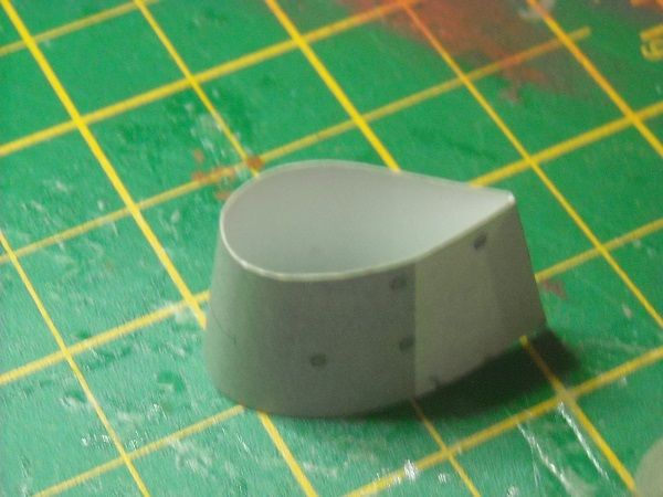

This session we are starting with the assembly of the platform of the 'B'-position. This platform is placed in front of the superstructure and sports a turret with a single 5.9" (150 mm) gun.
The turrets will be made later but here are the bits for this section.
The wall, a former and, oh yeah ... doors and portholes. Oh goodie! Glare
The wall was curved with the fingers as we did before to loosen the fibres so that when forming it around a shape it will get a nice curve.
I edge-painted the wall and then it was scored and bent.
Note that I didn't put the doors down yet because that would create problems when curving the wall so they will be put in after the forming and glueing of former and wall is complete.
I checked the fit of the wall around the former, grabbed the glue and with a toothpick I put glue on the former tabs and glued the wall in place.

Uhhhhhhhhhhhhhhhhhhhhhhhhhhhhhhhhhhhhhhhhhhhhhhhhhhhhhhhhhhhhhhhh
Not lovely!

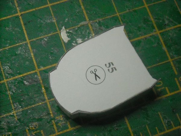

I THEN saw that the top of the former sported a scissor ...........
which means to cut this out BEFORE cutting out the part.
Which I didn't and now the part was glued ......
OOPS!!!!
(Note to any ADMIN people reading this, I REALLY need a OOPS smiley, please. I am going to require it plenty of times!)
Cursing Cursing Cursing Cursing Cursing Cursing Cursing Cursing Blushing Blushing Blushing Blushing Blushing Blushing Blushing Blushing
I'll use the above for the moment but it doesn't really express the depths of despair and feeling of utter 'dorkdom' I was suddenly experiencing.
The problem is that you can't just take a knife to it because by the time you make an incision into the top you will have bent it. And the only way to not get a bend is to support the wall from the bottom whilst cutting. Which needs fingers. My fingers! If you are not EXTREMELY careful there is every chance of embedding the knife into my flesh or worse slicing off a tip of a finger. (It happened to me before, a LONG time ago.)
Not only will that be extremely painful, the blood that will be spurting out will leave a very nasty stain on the model!!! And we can't have that, now can we??
No, and thrice no!
So, with a silent prayer on my lips I inserted the blade, then gigngerly felt below the platform to feel where the blade was pushing down the card and positioned the finger where it would counteract the bend but also should be out of harm's way.
I will not describe events any further for there might be people reading this with a nervous disposition.
I'll just show the picture.
A crude cut but more importantly NO BLOOD!!!!

You know, I have a love and hate-relationship with these doors. I hate to do them but I love it when the work is done and they are snugly glued against the wall.
Why do I hate them?
Well, apart from the fact that it takes me 10 minutes to stab one out with extreme caution, which tires my eyes no end, no real reason I guess.
But take a look for yourself.
And yes, that is a penny it is lying on!
But you HAVE to agree with me, that is one BLEEPer to stab out. Sorry, no option here, you either do or you do.
But with a little edge-painting is DOES look better.

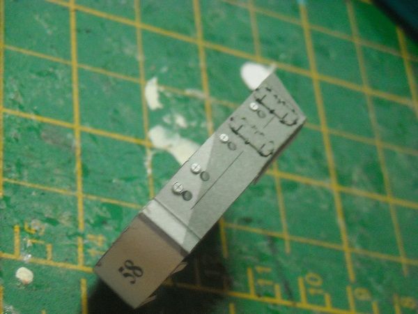

Anway, having finished the small stuff for today I continued with the next two parts which are the platform floor parts. They are coloured differently and need to be glued back to back.
(Pssst, just so you know, I DID remember to cut out the holes first this time)
The bottom ...
And the top ...
You can see in both pictures that there is some white showing around the edges. This is where one part is sticking out. Once the glue is properly dry, I will take my trusty knife and remove the white bits.
