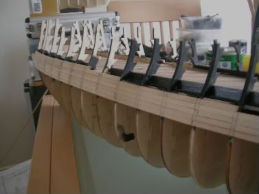

I hate to say this, but you might find that the planks don't glue to the painted ribs and blocks very well. Glue often doesn't give a strong bond to paint. If wood needs sealing before glueing, I would only use watered down PVA. PVA will bond to bare balsa very well. I used to use it when making RC aircraft (many years ago !)
However, You've done a superb job of filling in with balsa and it looks like it will make planking a lot easier.

cheers mark..i know what you mean.the paint is very thin and soaked right into the balsa, before planking i will go over it with fine wet and dry and use super glue to fix the planking.. hopefully will be ok

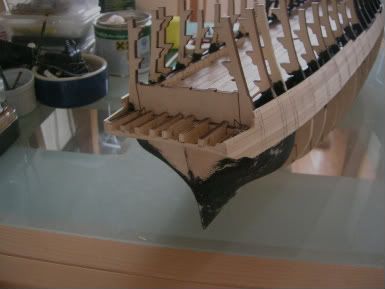

i have decided to do away with the small out of scale anchor ring and replaced it with a bigger one
cheers benny

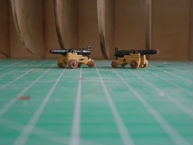

and yet another change i suppose if your not happy dont be lazy and change it..i have re-done the wheels on the cannons
cheers benny

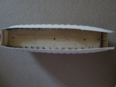

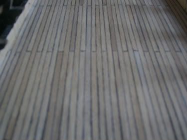

just thought i would plank the second deck for practice and also practise the caulking
cheers benny
#48 Posted : 08 September 2010 23:08:41
benny nice job on the flooring,why not try the 3 stagger that victory employed.?
what size floorboards,3x1mm.?or .05x3mm.?i'm going to use 3x1mm. x 80mm.roughly scale length of 21ft.

#49 Posted : 09 September 2010 07:46:54
Joined: 25/04/2010
Posts: 748
Points: 2,285
Location: bognor regis

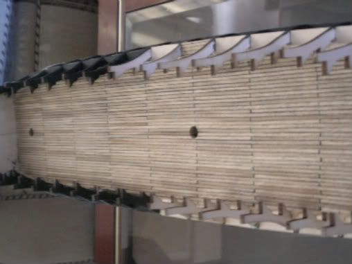

thanks karl there 3x1.this deck cant be seen i was just testing my decking and caulking.. in that picture i have only decked a third of the deck so i may try to stagger the last two thirds again for practice ..paul
cheers benny

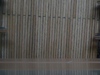

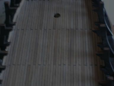

have now planked all the 2nd deck just as practise for the caulking but when it comes to the decks that will be seen i will plank using the 3 stagger that karl informed me about..i have applied 2 coats of danish oil and the caulking was done by using a black marker pen on the edges
cheers benny

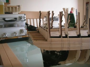

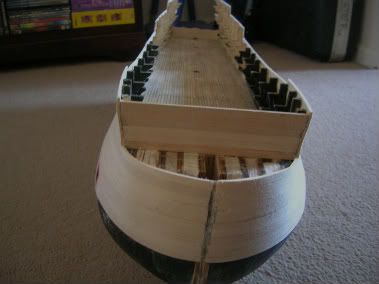

well the planking is under way(at last)the gallery supports are planked and shaped and have started the first part of the upper planking

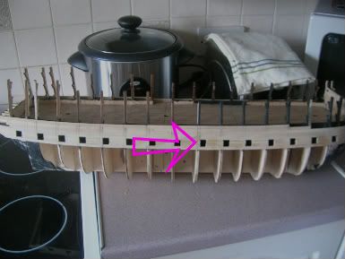

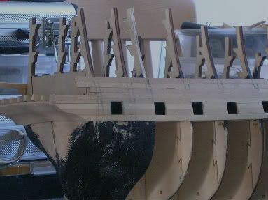

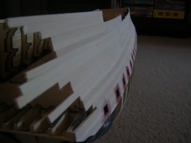

the first deck gun ports are cut out,tricky job i only made one mistake (see arrow) i cut it a mil to high,its only a mil but it stands out nothing a bit of filler wont sort out after framing

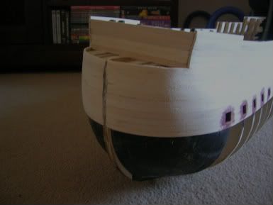

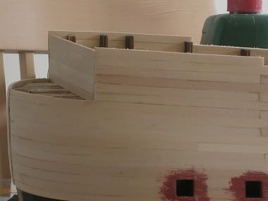

i have now planked the entire top half of the build(couldnt help my self)i have left plank overhangs in the right places ready to be cut back as instructed later..the planking has been checked and is the same both sides all the curves in the right places and is completely sanded down and ready to go.. (it is worth taking time over the fairing and packing out of the ribs)..the gun ports are framed and i have applied 1 coat of red ochre..the gap between the planks at the bow needs to be filed out and straightened up
cheers benny

#58 Posted : 26 September 2010 21:17:01
Hate to be the one to tell you, but there are some very important measurements coming up for the bulwark planking heights, and where some of the tops of the bulwarks are going to be marked and reduced in height, might be a little awkward for you, but with a little luck you'll manage it okay.

#59 Posted : 26 September 2010 21:20:49
Joined: 25/04/2010
Posts: 748
Points: 2,285
thanks tomick i knew it was a gamble but could not help my self..but i am painting the build so if there is a bit of planking to add or take away hopefully it will be fine..cheers anyway
