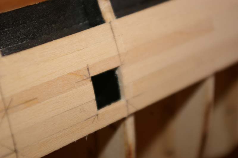

Gave in and just did one gun port, I think it took me about an hour? Blink
Very pleased with it - will look even better when framed and veneered the rest of the hull!
Tom

well done tom, gotta picture?
And I thought planking was time consuming!
Tom

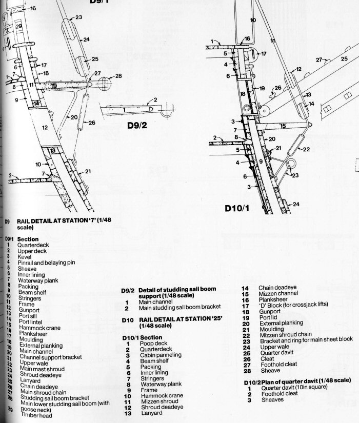

Hi shipmates! BigGrin
A picture paint a thousand words so here are 2, the plans are at 1/48 scale the gunport linings are 9mm, making the gunport linings around 5mm deep at a scale of 1/84.

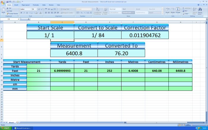

How do you work this out?Blushing

#59 Posted : 06 September 2010 22:37:41
Hi Colin! BigGrin
Zeptrader wrote:
Simply really made a spreadsheet on execl 2007 entered 48 in the 'Start Scale' so it showed 1/48, then entered 84 in the 'Convert To Scale' so it showed 1/84 and that gave my a 'Correction Factor' of 0.571428571. Next measured on the plan 9mm so entered 9 in the 'Measurement' section and got 5.14 in the 'Converted To' section, so rounded 5.14mm down to 5mm.
Below that I setup a section to convert measurement from yards down to millimetres so I can use reference measurements from all sources real and from scale plans. As you enter the scale your can go from 1/1 scaled down to 1/99999999 or the other way from 1/99999999 scale up to 1/1 scale.
Example you have the real deck plank measurement 21 foot so you want the scale measurement for a scale 1/84. Enter 1/1 for 'Start Scale', 1/84 for 'Convert To Scale', 21 in the 'Start Measurement' section on the row for 'Feet'. This give you all the converted measurements from yards down to millimetres, Enter 6400.8 in the 'Measurement' section and you get 76.20 in the 'Converted To' section that's 76.2mm.
ThumpUp Darron
