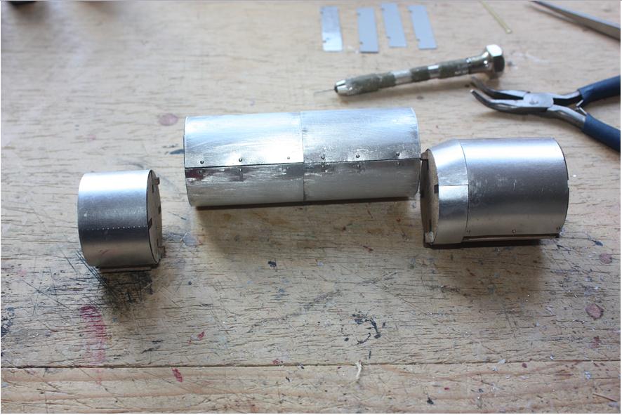

Have now added the skins to the timber frame of the boiler
Used Evo stik express on one part but found this too thick and the part almost ended up becoming a part of me.
Reverted to the good old super glue gel with more success
Used some pins to hold the skin in place whist the glue went off. They will not show on the final model so will leave them in situ
Next step is to glue the parts of the boiler together and fill in where necessary, sand and then paint
Will use some Perfect Plastic Putty as recommended by my local model store. according the the blurb on the box it "Fills fine gaps, Creates invisible seams"
We shall see

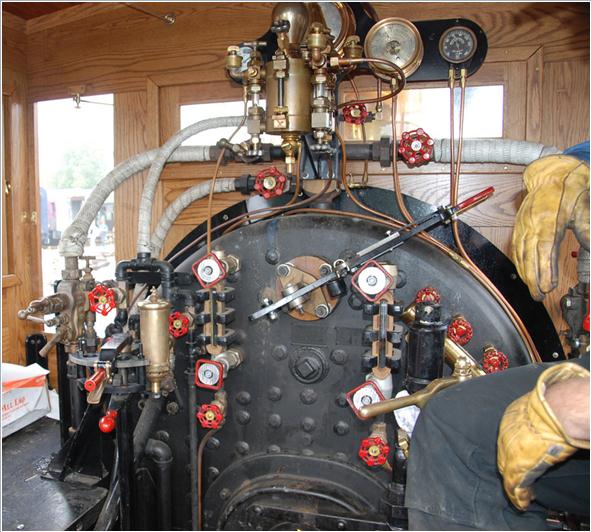

I found this video on youtube of the Jupiter replica.The front door is open and you can see the interior cab color is a dark green.
I think I will try to match that for my Jupiter

The video by O`Connor said the cab was left unfinished because it was so beautifully made, but then in the video I found from promenatory point the same train? has a green painted interior.
I did find out that originally at the Golden spike re-enactment the Jupiter train was actually a gas powered replica.THis was replaced by the one that O Connor built in the late 70s so I am not sure which train I am looking at on youtube.
I think I am going to paint rather than use wood.

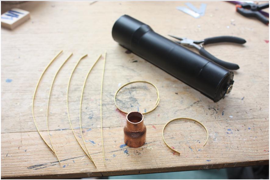

The next step for the boiler construction is to add the brass bands that go around the boiler
Provided are a number of brass strips which need to be bent to fit around the cylinder of the boiler
My first attempt using long round nose pliers was poor resulting in too many kinks in the brass.
Thinking cap on ????, My son is a plumber and had numerous copper fittings which he uses in the course of his work.
A quick look at what is in the shed I found a fitting used to reduce 22mm pipe to 15mm. Putting this on the end on my finger (bit like a thimble) I worked the brass strip around the large end first then the smaller end resulting in a length of brass the required shape to fit the boiler and no kinks
Jobs a goodun

love the color on the boiler Gil.I replaced those brass pieces because they were really tough to bend.The wheelguards will also be good to use your bending pipe on GIl.The ones for the main wheels are tough to bend.It took me ages to get them even vaguely round.

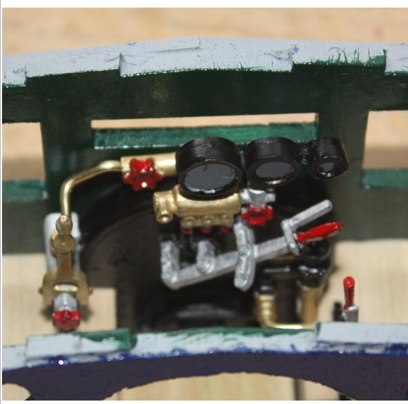

Moved on to the interior of the Cab. Lots of small parts and some delicate painting required.
Parts not glued in place yet as am bending brass rods to make the pipework. Decided not to use the supplied copper wire as it was too much of a faff to try to straighten it out. So this is by way of a dry fit
Also decided to add a wooden top to the seats to match the flooring (Used some planking left over from my Victory Build)
My next job is the funnel covering and the Tender covering. Have delayed this part of the build as it will require me acquiring new skills in so far as the addition of false rivet lines for which I have purchased a ponce wheel. not used one before so this should be interesting/challenging
