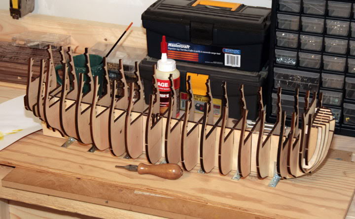

Have a look through my posts I posted one way back in march which use just a piece of wood and 2in angle brackets (about £1 for 10 @ Wilco) with pictues, subject is Building a Jig as well!!
LOL
RussG attached the following image(s):
Happy Building, Russ

The keel must be straight, so I shall assemble mine flat on a verified flat surface. The jig can be used, and is by many, but I have had many model aircraft that flew true and testify to the flat surface method. Nobody wants a deformed Victory that resembles a fish with TB that will be impossible to cure later.Cursing
Next the frames must be square to the keel in both planes. The only way to do this is to hold the keel vertical to a surface like a jig, so that the frames may be verified square to the keel and the surface when positioning for gluing. One out of square frame will result in 2 depressions in the planking, larboard and starboard, and 1 on the modeller.Crying Only 2 can be filled. The modeller cannot as, he or she will always know it is there, so cannot be repaired with a cover-up.Blushing
And finally, it will be useful to have a means to hold the model while it is worked on.
I hereby rest the case and justification for the jig.LOL
When the planking is complete a cradle will be needed. I like polystyrene (from discarded packing) for this as it is easily shaped, with a serrated knife, (if messy) to hold the hull firmly in any position, and will not damage those lovingly prepared surfaces.Cool

Be carefull when buying the brackets from Wilkos . I just bought six packs (2 in a pack)this giving me twelve in all , 6 for each side . When I checked for squareness, only six were any good. the other six were out by 2mm. So if I used these,I would be along way out at the top of the keel. That why thay are cheap. John.

I just bought 20 brackets from B&Q. They will all need persuading to a right angle.Cursing I recon a judicious clout with a persuader (hammer) will do it.Cool Thanks for the warning but not the timing.LOL
By the way I also got a meter of 2x15 mm ali. as a straight edge for aligning the brackets. When cut in half it will be my clamp for tapering the planks.BigGrin

It wont be any use, it does not allow the Keel of this model to sit into it, the frames are level with the bottom of the keel, so there is nothing to clamp to, the L bracket method noted in this topic is simple route.
