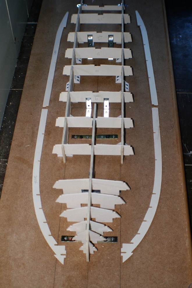

So, to planning the next stage:
To Do
Fit and glue the forward centre keel with six ribs keeping everything square while it sets.
I`ve already fixed brackets to set the forward keel in place and will be using the pieces called shears to hold the ribs in their correct position.

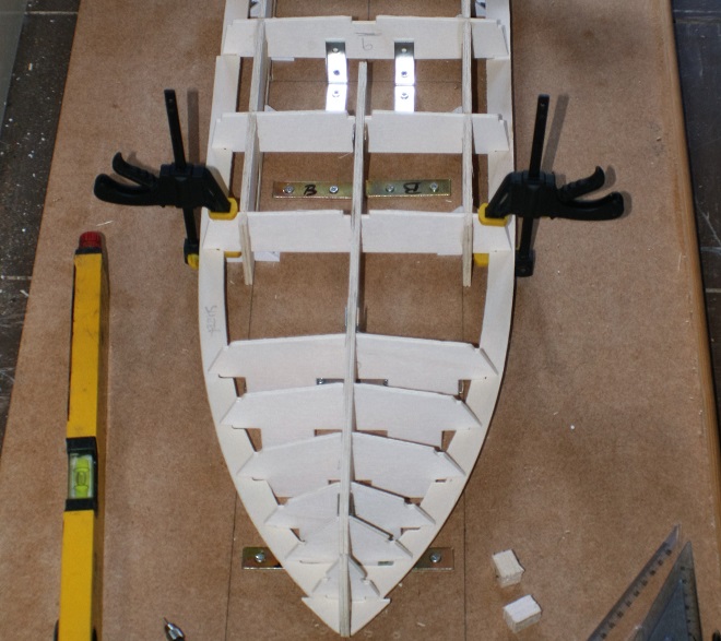

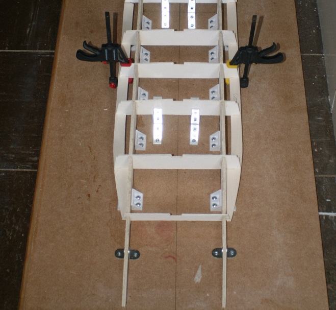

The first picture shows the four shears laid on the build board close to their relevant positions.
The next picture shows the forward shears held in place to check it all fits together Ok. (No glue at this stage)
The last picture is just to show the fit of the rear shears. These will need very minor adjustment in length after the front shears are set in place.
Now happy with the way this section all fits together and with a total of twelve quick clamps in hand it`s time to get glueing. A job for tomorrow, dinner and work beckon.Crying
