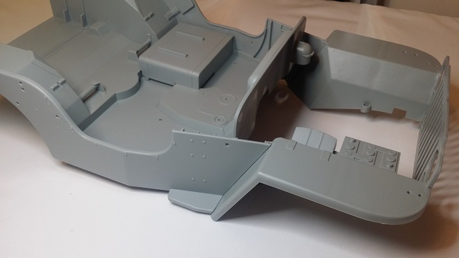

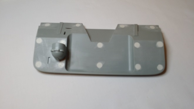

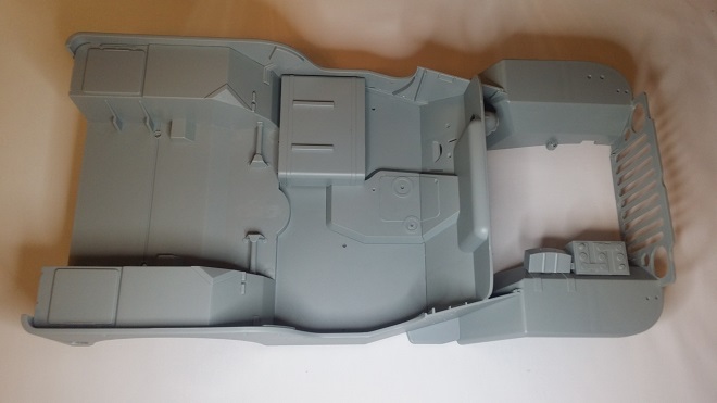

On with the build! I have started work on the tub and the first thing is the sink holes in the bulkhead need dealing with. No problem you say, but in 1:6 scale they are like moon craters!!

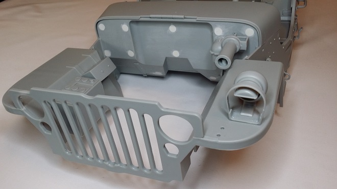

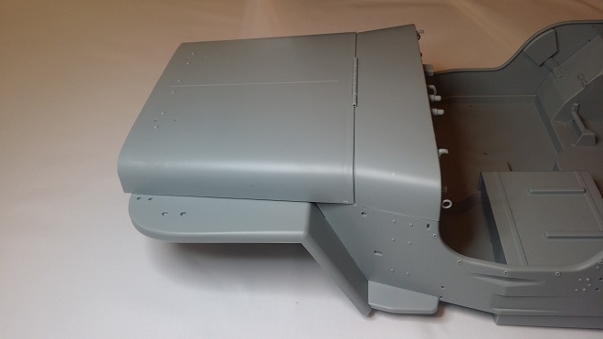

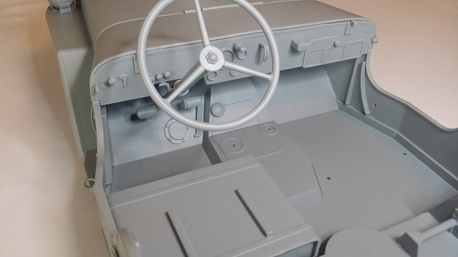

Next up was the dash board and bonnet, hood. Big plastic hinges and a metal rod so that it opens and there are some decals for the gauges when the dash has been painted.

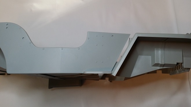

Then on to the tub. Battery and fuel tank were fitted and then we hit a problem. Your meant to fit the bulk head then the dash and slam panel. They were not a good fit so I offered up a side panel to find the tub is warped length way and side to side. So I will be deviating from the plans. Side panels will be fitted first then the bulk head and then the dash and slam panel. I have done a dry run with clamps and it should all pull straight.
#44 Posted : 24 June 2016 20:39:35
P38 Heaven with those craters, with the correct jigging the body will straighten out no probs, nice work

Well I managed it! Lots of clamps, copious amounts of glue, hair dryer, alot of patience and some choice vocabulary, the tub is square and everything fits nicely!

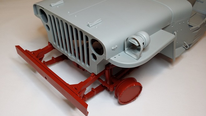

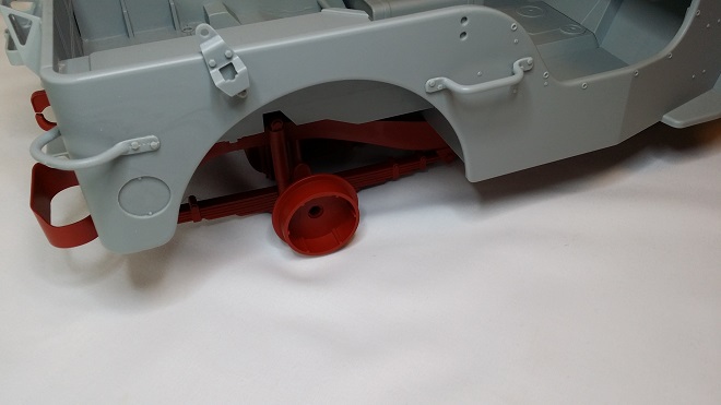

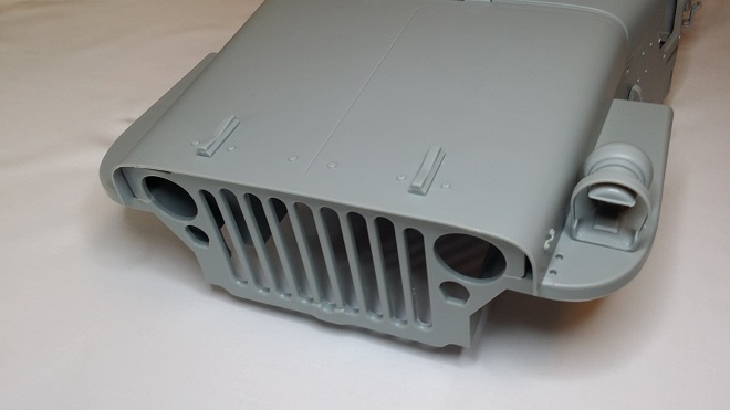

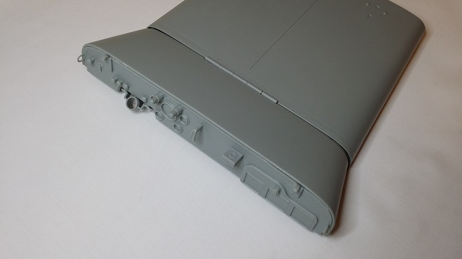

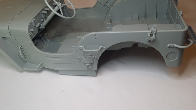

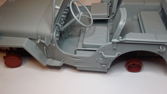

After getting the tub square and the bulk head, I have started adding tool holders, handles and other external parts. The drivers pedals are in also. The seats and frames will be added later in the build as they need painting separately. I did a dry run with the chassis. It is going to be quite big!

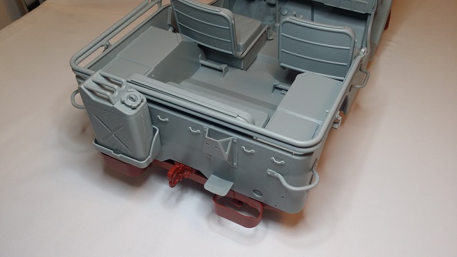

#58 Posted : 02 July 2016 21:18:02
Hi Kev, no rifle on this kit, Dragon could have done so much more with it in this scale.

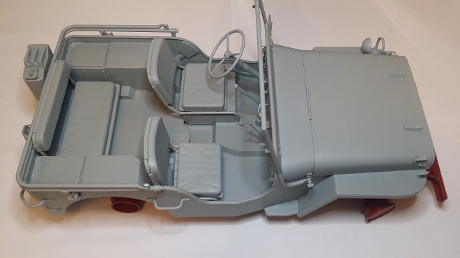

The basic build is done now, all the lights and tools will be added later, also the straps for the tool holders. The seats are dry assembled and fit, they will be painted separately. The jerry can still needs a little work. Now its time for some primer and pre-shading. The body will be done in grey with black and dark brown shades as will the wheels, chassis will have black shading.
