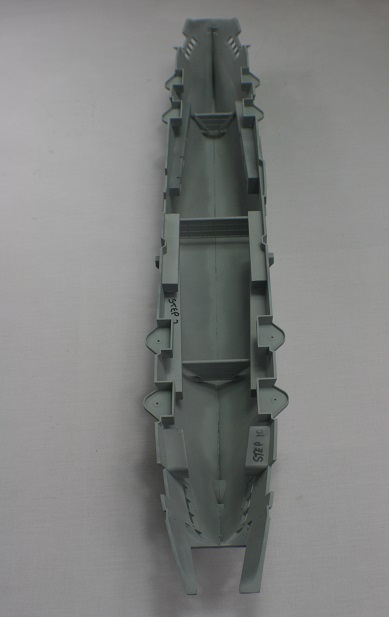

First pic is of the inside of the hull showing some very sturdy bracing pieces that keep the hull sides nice and straight.

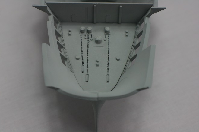

Fitting of the forward and aft lower decks.
First had to fit a few small parts like bollards, paint and then try and paint in the minute anchor chains.once the decks are installed there are two inner bulk heads to paint and fit, more fidley railings and some partitions.
