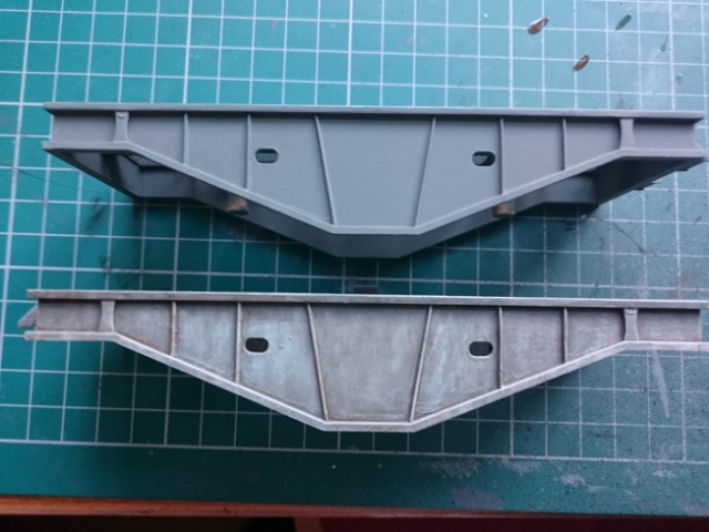

Hi thought I'd put pic up of difference between weathered section an plain section.weathering is not my strong point, just tend to go with the flow of it.cheers mick.
#49 Posted : 13 September 2016 18:10:40
I think that part is very nicely weathered Cool
What steps did you do to get it to that stage?
#50 Posted : 13 September 2016 18:32:01
Hi dave, I just try to keep it simple at the moment as weathering is new to me.so far it just dry brushed with 3 mixed shades of original colour, by just adding white.then a very thin wash of vallejo 70.872 marron chocolate. Needs further pin wash in corners.and few scrapes on corners.with steel colour. Very few though. I decided ill add no rust to this.if I do anything different ill put it in an update.cheers mick.
#51 Posted : 13 September 2016 18:38:48
Nicely done with the weathering Mick, really adds to the overall finish. If you look at grey when it fades and weathers in you can also find hints of purples and blues, hope you don't mind the input?BigGrin
#52 Posted : 13 September 2016 19:13:17
Hi nem, don't mind at all. In fact it's much appreciated, I'll try other washes with blue an purple in the mix.all ways good to learn. Cheers mick.

Mick like the weathering effectCool i`m going to use various effects when doing the Famo and trailer there would be plenty of wear and tear, when the troops would climb up and around especially cause most wore hobb nailed bootsBigGrin.........regards Phil
#54 Posted : 13 September 2016 19:37:38

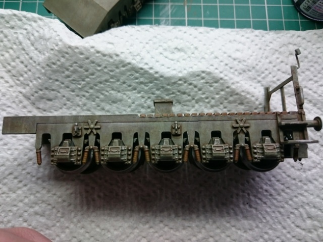

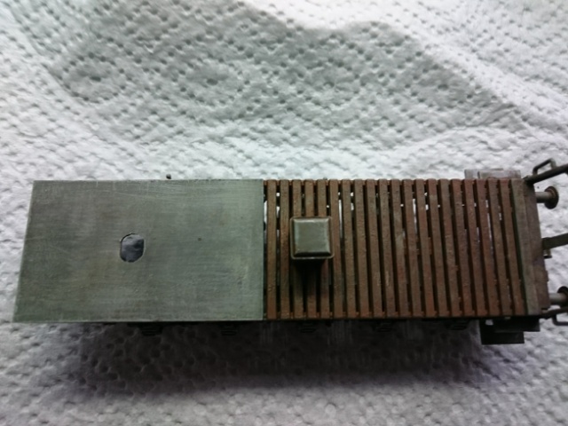

Hi thanks for all who looked in and left comments, much appreciated. I finished building one of the main girders.and bin playing about weathering a truck. Won't be to everyone's taste but I'm happy with it as is.the whole process is as follows.
1.paint truck matt black.tamiya XF 1
2.paint the truck rlm tamiya XF 22
3.mix 3 shades of base grey with white tamiya again.getting lighter each shade apply in direction of rainfall ie top to bottom.
4.apply all over thin wash of vallejo 70.872 chocolate brown all over.
5.mix tamiya X16 purple with tamiya flat base X21 50/50, thin it down a lot, and apply wash to upper parts of bodywork. Working it in to leave faint stain.
6.apply chocolate brown pin wash to to edges an any Lil hollows to bring out the detail.
7.using tamiya chrome silver X11, mixed 50/50 with tamiya german grey.just like it toned down a bit.dry brush extreme edges.tops of bolts.wear on handles etc. And the wheel rims.
8.the wooden planks first painted with humbrol matt 186 wood, then dry brushed with tamiya XF 49 khaki, and tamiya XF 60 dark yellow. Then a thin wash of vallejo 302 dark rust.anyhow at the process I used, and I like me final result.we all have our own ways to weather. But to play with it is fun.cheers mick. BigGrin
