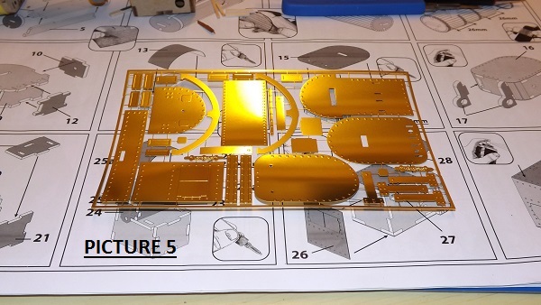

We now start to work with the brass etch and I must admit having looked at the build overall this is the one area that has given me the most worry and concern.
The etch is very “Hard” and not flat. If anyone is familiar with the film “The Longest Day” there is one part of the film were the American troops are issued with a “Clicker” and to be honest that is exactly what the etch is like. If you flex it, you get a nice click from it.
All is not lost but is does require some additional work because in its supplied form it will be next to impossible to shape and glue in position.

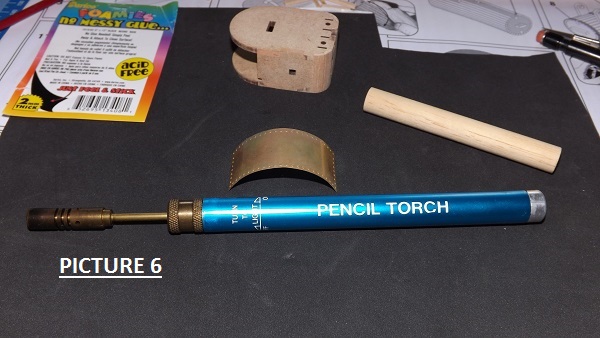

To soften the brass and take the “Spring” out of the metal it needs to be tempered and that means heating it until its Cherry Red and then rapidly cooling it in cold water. The internet and YouTube have many examples of how to do this but I did find some of the instructions between sites contradicted each other with both the colour the metal should be heated too as well as how to cool it.
I did initially try out a Dremel gas powered soldering iron I purchased last year as that has a hot air blower but this did not work as the hot air jet was too narrow to be of much use.
In the end I resorted to using a Pencil Blow Torch that I have had in my tool collection for at least 15 years’, probable longer. This worked a treat and out of interest I had a look on eBay and this style is still available and from just under £4.

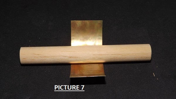

PICTURE 7
Having tempered the brass and taken the spring out of it there is a real difference to the feel of the part. Some basic shaping of the curved parts is required and for this I used a piece of 5mm foam sheet I had knocking around and a dowel rod that allowed me to roll in the basic curve needed for this piece.

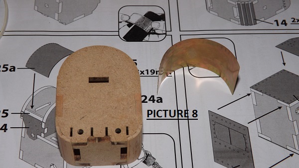

Before committing to glue it’s really important to dry fit the parts to ensure that they fit nice and even. We really only get one chance with these particular parts as there are no spares provided so take it slow, check the fit and all should be well.
PICTURE 9
Some thought was given to what type of glue to use to stick the brass etch to the MDF part and having discounted superglue I opted to use a contact adhesive and in this case it’s a tubed Evostik product called “Timebond”. It says that you can make a quick fix by putting the glue onto the less porous part and then clamping the parts together. So in this case it was put onto the brass part having roughened the back of that with some sandpaper.
You do need to be very careful with these tubed glues though because they can take a while to start dispensing but suddenly you will find the heat from your hand will put pressure into the tube and it comes shooting out.

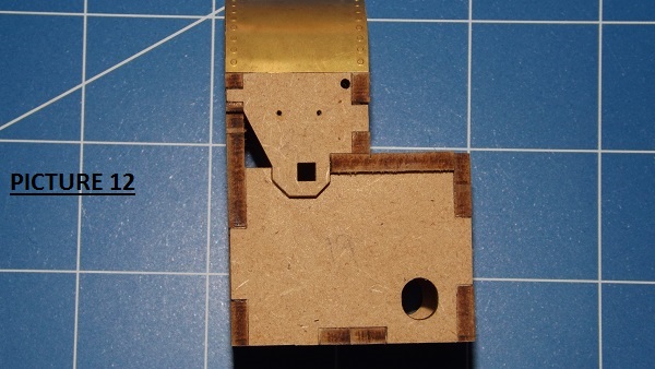

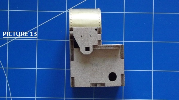

PICTURE 12 & 13
Having allowed the recommended time to dry we can remove the elastic bands. I must admit that I was pleased with how this part fitted. I never like using the word “perfect” but in this case it’s very close to that.

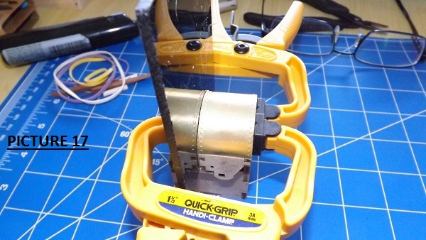

When gluing the firebox etch part in place we need to ensure that it is left to dry under even pressure so to provide this I have used a small 5mm acrylic sheet offcut over the etch part and then a couple of small clamps to hold it all in place.

The majority of this week’s build has been getting the remaining brass overlays in place. Fairly slow because I have had to clamp up each panel and allow the glue to really dry out thoroughly.

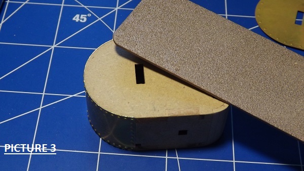

Because the etch panels have “rivet’s” around the edge it was necessary to add some padding to ensure the clamping operation applied a nice even pressure across the piece. In this case a piece of twice folded paper kitchen towel did the job well enough.
PICTURE 3.
Just to ensure the brass parts butted up as neatly as possible to the previous piece I used a flat file just to ensure the MDF part was rubbed down to the same level as the etched part already in place. Nothing major here at all but it does ensure there are no gaps left between the various etch parts.

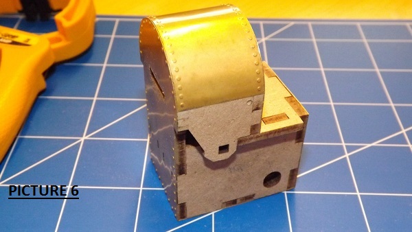

PICTURE 6.

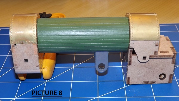

And here we can see the firebox end of the loco with all of the supplied etch parts in place. It’s interesting to note that while they provide an etch part for under the fire box (which will probably never be seen unless you upend the loco) there is nothing provided to cover the sides of this part.

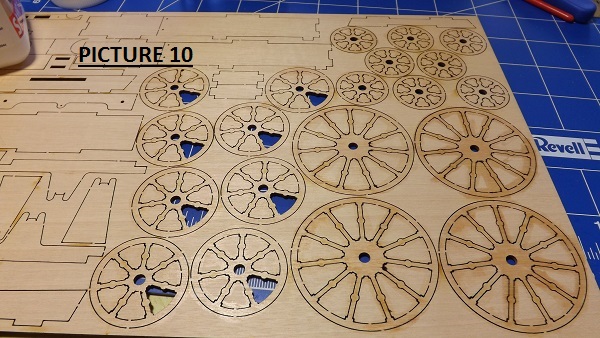

PICTURE 9 & 10.

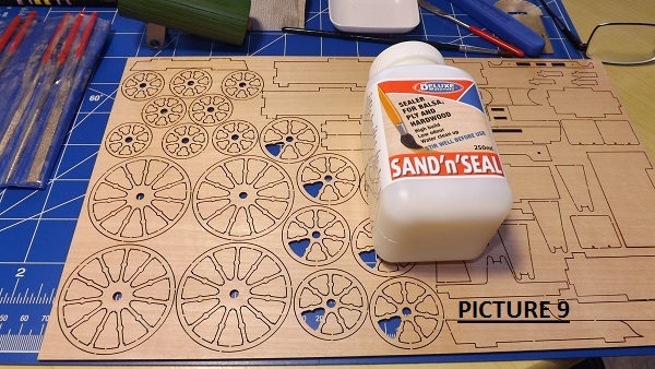

One of the major issues with the previous version of the kit was that the wheels were about 1mm to small in diameter so when fitting the metal “tyres” it was necessary to put bands of paper around the wheel to ensure a tight fit.
I was keen at this stage to see if the same issue had transferred over to this kit and am pleased to advise they have resized the wheels and they fit the Tyres just perfectly.
In picture 9 you can see I am using the “Sand n Seal” product again as I really like the fact it is no solvent based so no nasty fumes and brushes clean out in soap and water.
In picture 10 you can see the end result having applied 2 coats of the sealer.
