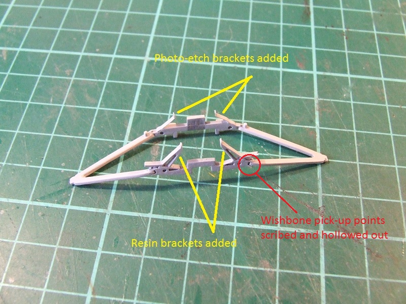

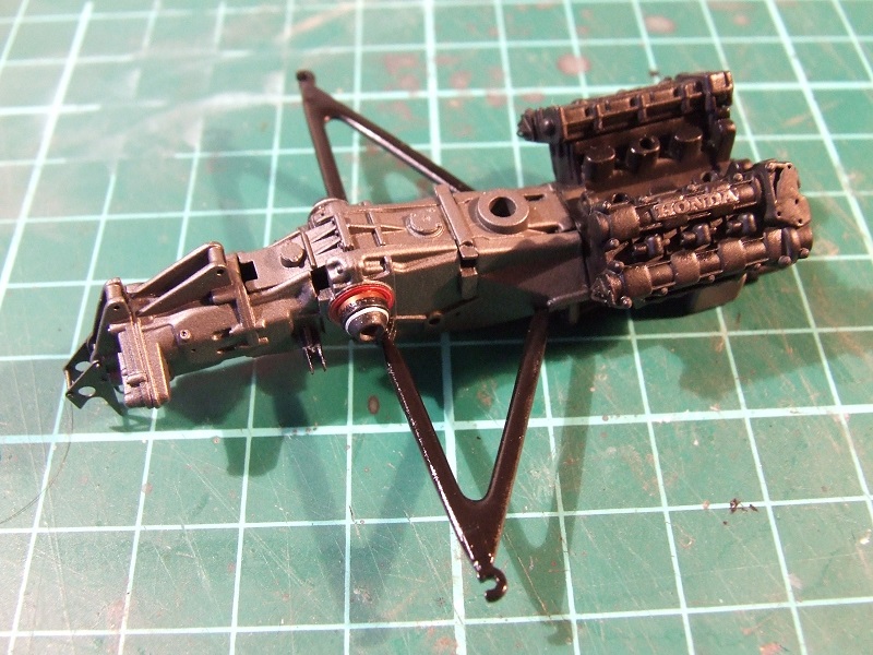

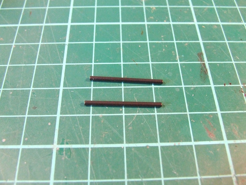

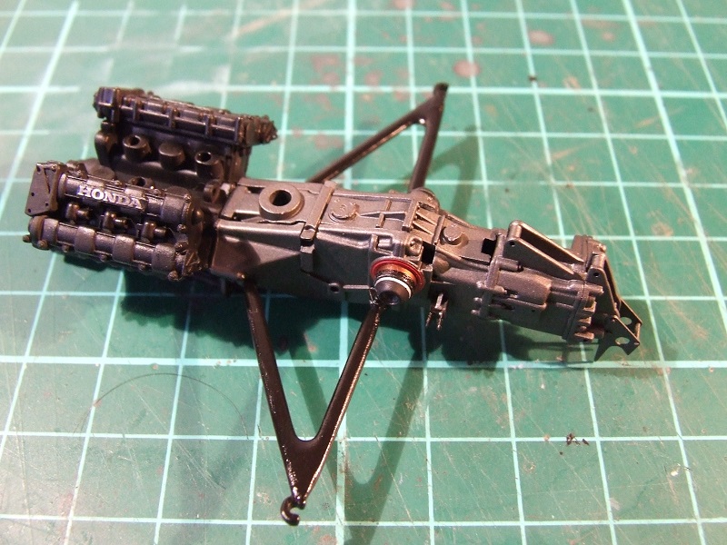

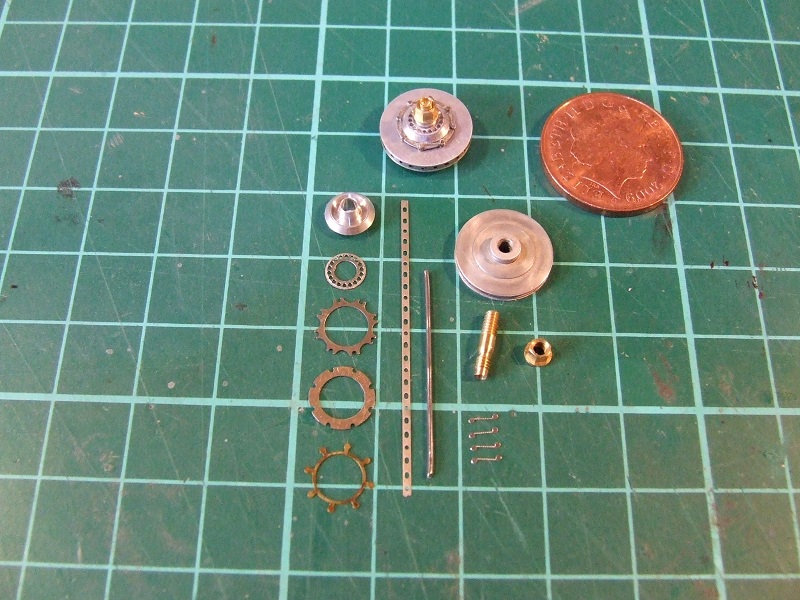

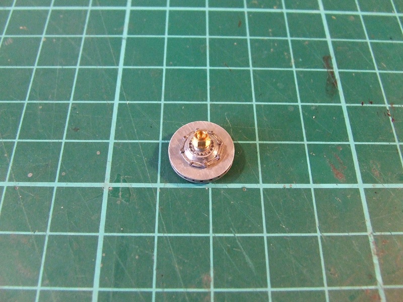

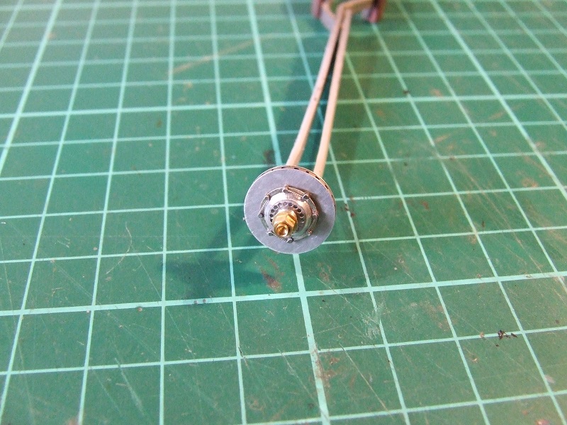

Hello all,
Found some time to make a little more progress on this.
When I last updated I was working on the basic engine/gearbox build and the upper rear suspension arms and a couple of other bits, but I'm not going to show that work in this update as I want to leave the engine/gearbox assembly just for a little while and come back to it later. I want to do some work on other areas of the model for a while, but will do small pieces to the engine/gearbox in between and will show the work as I do it, but probably leaving the final engine assembly until nearer the end?
Using 'Krick' metal blackener, I have blackened the driveshafts, which were supplied in my upgrade set as plain machined brass bar. These can be seen in the first photo below. Not sure why they are portrayed as being a copper/bronze colour in the kit instructions and also in the DeAgostini 1:8 version of this car, as every reference photo I have seen shows them as being a metallic black and I prefer to stick with what is on the real car?
I have also assembled and painted the rear shock absorbers which are supplied as part of the upgrade set and come as a resin body with a turned aluminium upper part and a blackened metal spring, much better than the one-piece kit part from Tamiya! I did have a photo of the parts before construction but can't locate it anywhere so it's just the one photo below I'm afraid? There will be other scratchbuilt parts added to the shock absorbers at a later date before I fit them to the sideds of the gearbox.
Moving on to other parts of the build, I have decided to start constructing the wheel hubs, brake discs and brake calipers. The upgrade set provides complete replacements for these and none of the Tamiya kit parts are used in the construction. The photo below shows all of the parts needed to construct just one wheel hub/brake disc assembly and consists of no less than 21 pieces for EACH one, and even includes etched metal locking wires for the hub bolts! The dull metallic piece of wire in the centre-right of the photo is a piece of 0.6mm soldering wire which has to be cut into eight slightly over-length pieces then glued into the eight circular indents around the edge of the two steel coloured star-like discs on the left of the photo once they have been glued to each other. These pieces of wire are then cut and sanded down to size to portray a ring of bolt heads and then the brass coloured star shaped disc is glued behind and the etched locking wires then glued on top - quite ingenious and very effective I think? The photos show the first hub/brake disc assembly before and after construction but I now have another three to do after this, so that's a total of 84 parts just to build four assemblies and that doesn't include the brake calipers! Penny shots are included to show the small size of these in 1:20 scale! I am super impressed with the look of the replacement assemblies and in my next update I will show all four constructed units along with the brake calipers as well, and if I get time, hopefully everything will be painted.
Thanks for looking, all comments and criticisms welcomed.

This upgrade set is awesome, man. Really great job. What are you using for references? Internet pictures or some book?

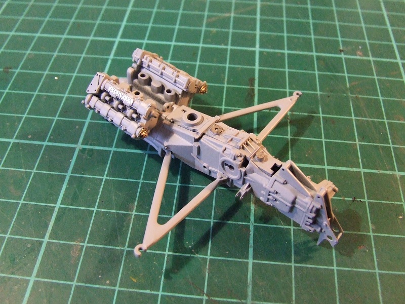

Hello all,
Finally finished building all four of the brake disc/hub assemblies (84 pieces in total!) from the upgrade set, photo can be seen below. Next job is to prepare and prime the calipers and their associated hydraulic piping and unions.
I've also added a few more PE parts to the engine and gearbox which can be seen below. The 'Honda' badges on the cam covers were already attached in a previous update, but I wasn't happy with the way they were sitting so I sliced them off and re-attached them.
I have also assembled and primed the resin upper rear wishbone assembly which comes in the superdetail set and which replaces the plastic kit part. I did have a photo of the component parts before assembly, but can't find it so I can only show it as assembled and primed, but I've indicated on the photo what work has been done? Needed a fair bit of Mr Surfacer 500 and sanding on the wishbone parts to tidy them up as they are not the neatest of mouldings which was a little disappointing given the cost of the set!!

Great update kev BigGrin has really got some small etch workBigGrin superb jobDrool regards PhilCool

Way to go, Kev! These discs look awesome, you did a really good job of them.

Great work Kev, very impressive....Drool Drool

Hi Kev. Great to see your progress on this build. Those wheel hubs and discs look fantastic.Cool
Super neat job from you as always.
