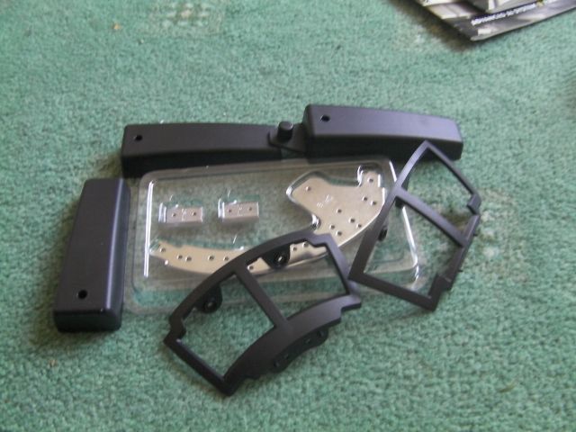

Issue 10, comprised of parts for the dome and a couple of leg parts not to be used for this issue, it also came with the lens mounting plate.
The frame piece that was to go on the dome was for the lens,the best way to see where to fit it is to ensure it is on the two holes opposite the shortest groove at the top of the dome
Also on this row the nuts go underneath
The next thing to do was to fit the lens to it's cover and the mounting plate
Most importantly the lens should curve outwards
It is a bit of a tight fit, but looking at the instructions and how I had it I noticed as long as the tabs were angled outwards it should be ok.
To secure it I used the SMALLER self tapping screws as I only had 4 of these.

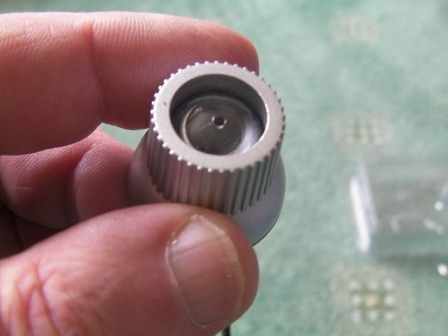

The microphone was built up next and is very straightforward to do, as has all the build being so far BigGrin
The parts were as follows;
putting them together as I say was so easy, although it may be an idea to handle the microphone carefully and no pull too hard on the wires.
stage 1
stage 2
Stage 3
Finally Stage 4, for this I used the smallest black self tapping screws, as usual it didn't say exactly which ones to use so I picked these as it felt right

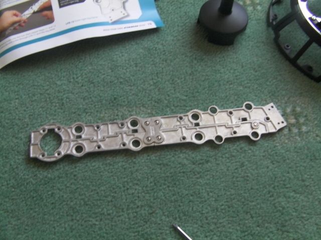

The instructions say to take the leg piece and fit the casting to it, now looking at the pictures, the centre piece that was fitted previously in the shoulder, wasn't there it was just a hole. so REMOVE it.
The casting assembly can now be fitted. to do this I used the black screws that came with issue 21, seemed to make sense. Also, made sure that the nuts and writing were uppermost.
So it is more ore less like this when fitted.
The arched bracket from issue 20 could now be fitted, make sure that the curved part and flat edge faces upward towards the blue bits, which is shown in final image. The wheel fitting is also added now, all it says in the instructions is use silver screws. Well I used the thicker screw as this seemed to be the best one.
