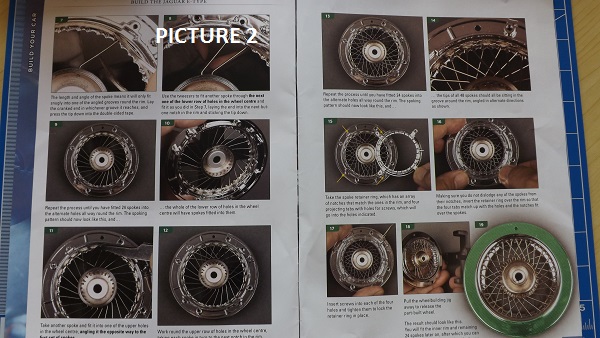

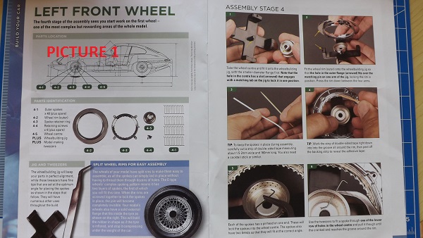

PICTURES 1 & 2
Here we have the build instruction pages from issue 4. Of note this issue is the fact we have a more complex build to work on and this is reflected in with the instructions covering 4 pages for this edition.

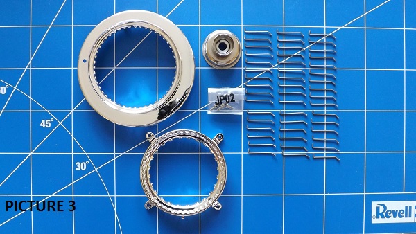

PICTURE 3
This picture shows each of the component parts we receive with Issue 4 (again this is from the TEST so there may be some changes with the full subscription Issue 4 Parts). In my test pack I had just the required 48 spokes for this stage and no spare. Not an issue to be honest.

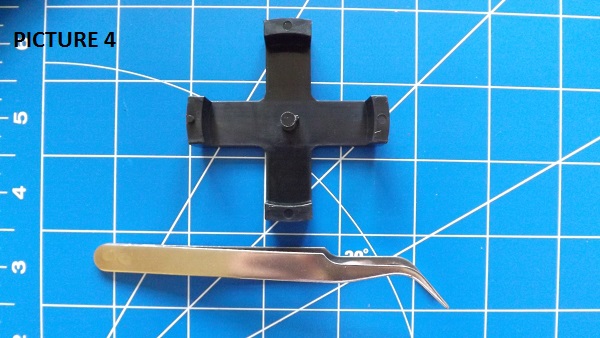

PICTURE 4
Here we can see the jig upon which the wheel will be constructed. This issue we are also provided with a pair of tweezers to allow us to work on the spoke section.
I personally found the tweezers supplied rather springy and needing a fair amount of pressure to keep closed. As I have a bit of an issue with my fingers I opted to use a pair from my own tool kit.

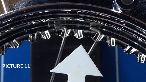

PICTURE 11
As you start inserting the spokes into the lower set of hold on the Wheel Hub bear in mind that its “SPOKE”, “MISS ONE” “SPOKE”, “MISS ON” all the way around the slots in the Wheel Rim.

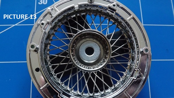

PICTURE 13
And having inserted the remaining 2nd layer spokes this is the effect.

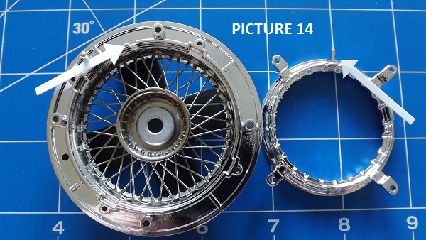

We now have to prevent all of the spokes coming free and for this we are provided with a Spoke Retainer Ring.
This part is again keyed with a TAB on the Retainer Rim and a Slot on the Wheel Rim.

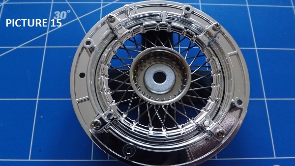

PICTURE 15
Carefully check that all of the bent ends on the spokes are correctly in place and then lower the Retainer Ring into place.
It gets secured using 4 of the 5 supplied screws from this edition. Again remember that you are screwing into plastic so do so with a light touch to prevent damage to the plastic part.

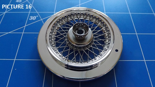

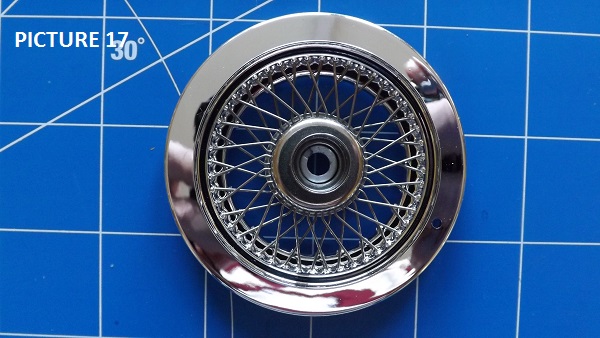

PICTURES 16 & 17
And having removed the assemble from the build jig this is what the first half of the wheel looks like. And I must say it looks very smart indeed.

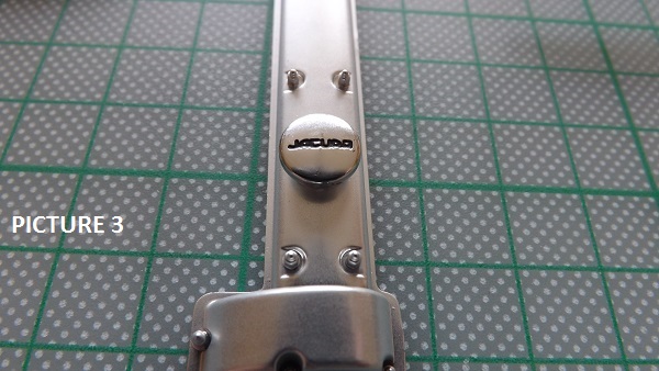

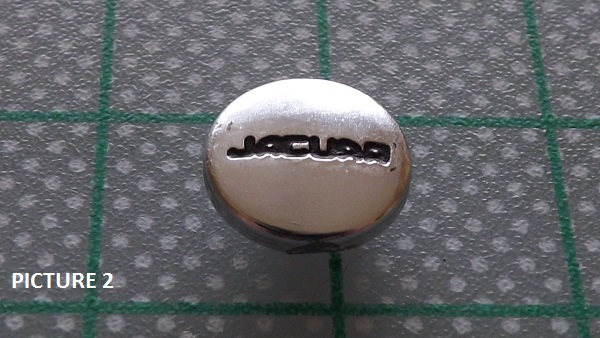

The first part that has seen a change is the Oil filler cap which sees the locating tab being in a different position meaning that when installed the JAGUAR logo runs across the cam cover.
There is some fairly decent depth to the Jaguar lettering on the oil filler cap so I thought it would be good to bring out this detail with a little paint.
“PROCEED WITH CARE”
If you should decide to follow me with this slight enhancement, please ensure that you use nothing more than a water based paint to infill the lettering. Anything that involves solvents is highly likely to destroy the chromed finish on this part so proceed with care.
PICTURE 2
Having given the water based black paint a few moments to settle I used a cotton bud to remove the excess paint leaving it just in the recesses of the JAGUAR name.
PICTURES 3 & 4
And this is what the oil filler cap looks like once screwed into place on the cam cover

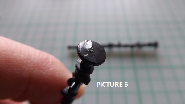

PICTURES 5, 6, 7 & 8

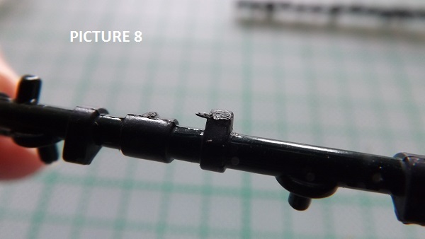

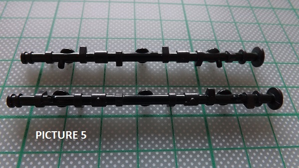

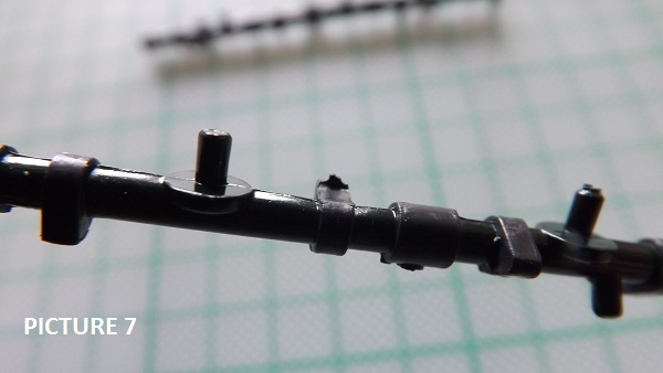

I was somewhat disappointed with these revised can shafts. They have been changed in that the cams themselves are not all aligned in the same direction as was the case on the test parts.
However, in my example there is a significant amount of flash on the parts (easily cleaned off with a small file), but slightly more disappointing is the fact that one of them is a very loose fit in the engine mounting and the other has one end that will not fit flush into the hole in the engine part.
PICTURES 9, 10 & 11
The issue with the cams not sitting correctly has a knock on effect in that when the Cam Covers are pressed into place the do not sit correctly and a gap is left between the cam cover and the engine mount.
At this stage the correction would be the use of spot of CA glue but as I do not know how these parts will interact with future instalments I do not want to start gluing things at this stage only to cause myself issues later on.

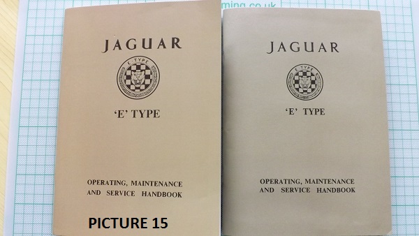

PICTURES 15, 16 & 17
Subscribers receive the first of the Free Gifts with Issues 1 & 2. This takes the form of a facsimile of the E Type Operating, Maintenance and Service Handbook.
Picture 15 shows the edition received today with the one from the test run on the right side of the picture.
The main differences between the 2 are the paper used to print up the book with the new edition being on a shiner paper. The other point with this revised copy is that Deagostini have stamped each page with their name. This may be to stop copies of this book being posted on EBay as “Originals” as seemed to be the case with the trial versions and people asking “silly” amounts of money for them.
Anyhow a very nice addition as a subscriber and I can already see it forming part of a display once the car is complete with maybe the book being added to the display case open at a suitable page – I am sure you get the idea.

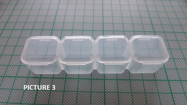

Pictures 1 – 4 shows the box I have purchased (my earlier version saw a refund being given as it arrived damaged in the post but luckily I was able to track down an identical version to replace it.

Many thanks.
Its minor issues to be honest that i am sure can be sorted.
While they have changed the cam shafts in the new release if they are never to be seen under the covers i may just revert to using the old ones as the fit was a lot better.
Its a case of waiting to see how it all shapes up over the coming months without rushing in and making changes that could cause problems later. BigGrin

The cam lobes differ from the test because they are closer to accuracy than those of the test. Also the, the seat cover of the test was faux leather, the launch version is real leather.
