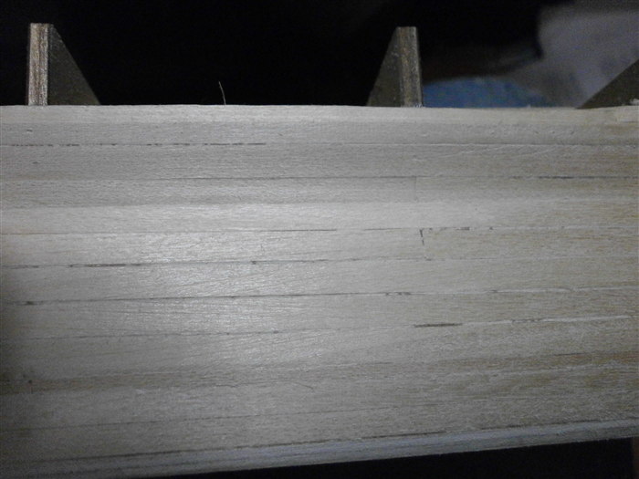

#50 Posted : 29 November 2011 20:43:27
BigGrin Hi all some more pics of the central strakes build, still a bit rough as its before any sanding has been done.Crying But a word of warning here for this section of the build in the download instructions[pg 71-72]its a compleat hash.It says take a strack [no7] and attach it from frame 6 to 12 [the wood provided isnt long enough to do this anyway],then to take the second strake [no7] and attach directly below it, ignore these instructions. Instead follow tomics official build diary and attach strakes [no7] from frame 5 to 9 then the second strake [no7] to frames 9 to 13 [not frame 6 to frame 14 as stated in the download instructions]then fill in below with strakes [no6].Had me scratching my head for a while till i read an old post [pg3] of another builder who had the same problem,hope this helps bulders who are building this now
