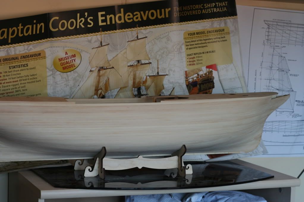

hi jeff and the rest of you kind gentlemen,there are two ways of planking this model,the first is to balsa plank,then cover with dope tissue,after a coat of diluted aliphatic glue,then primed and rubbed down and srayed paint.the second is to do all the above then before priming put 2nd planking(veneer) then prime and paint.not decided yet which way to go.

hi mike and Ian,yes mike the tissue/dope is to have a smooth finish,but put onto the balsa it would susceptible to dents and digs,so I will sand seal and rub down several times and then tissue with further rub downs to get the smooth surface.

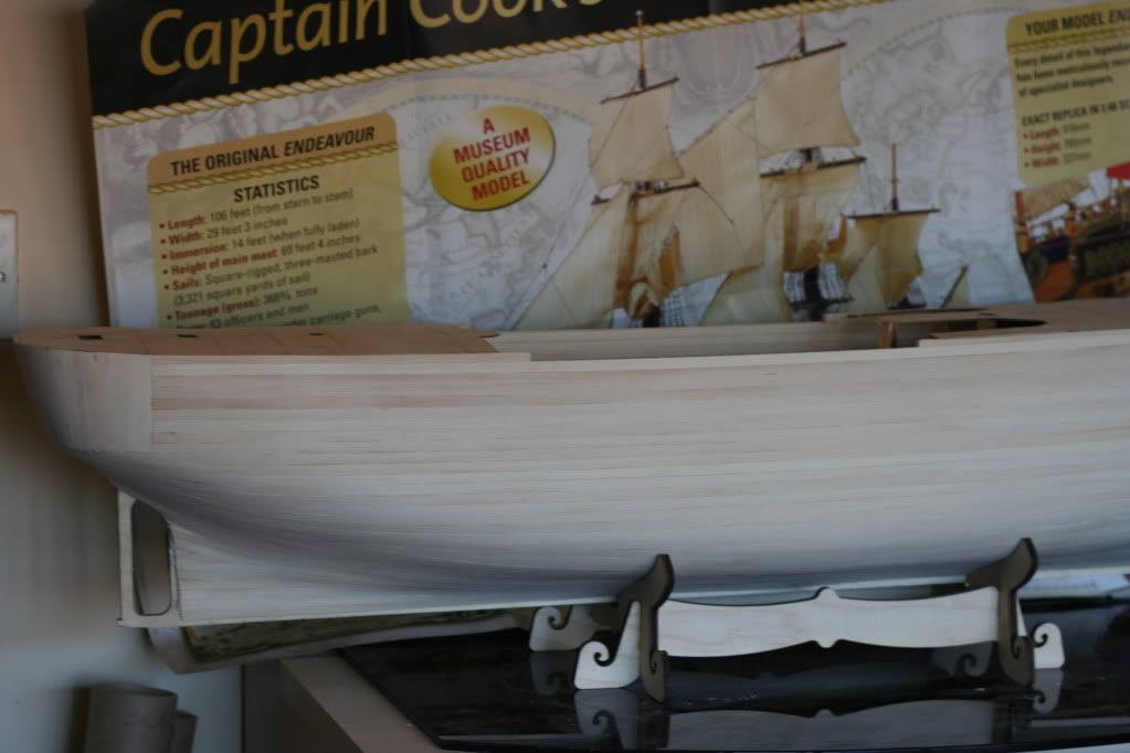

that's the 2nd.layer of planking,.8mm.x6mm.

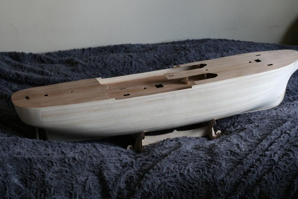

the decks are now planked with 3mm.x.05mm walnut.
