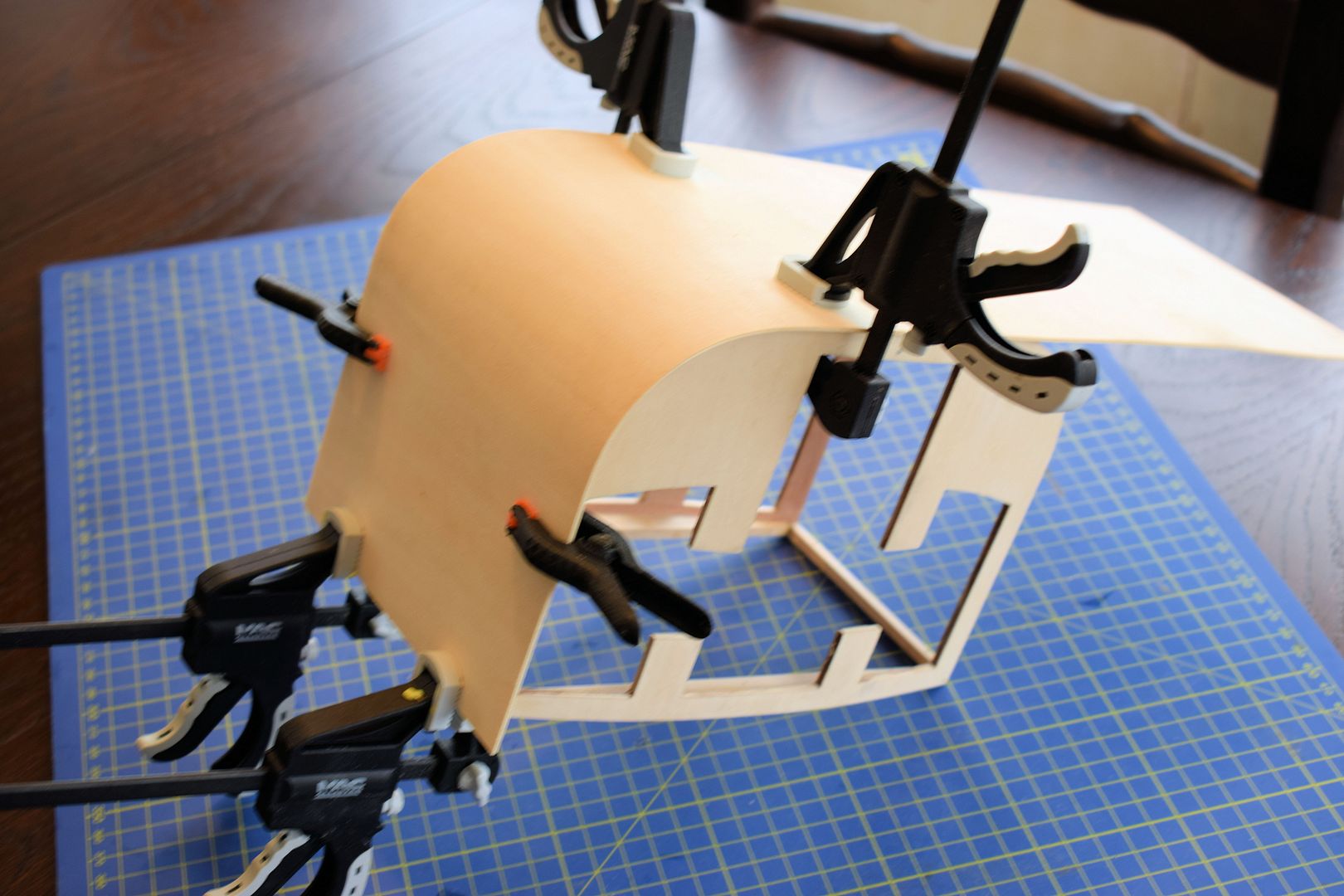

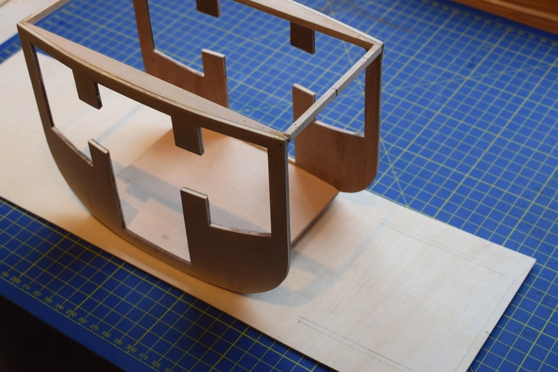

Hi all, time for an update, today I fitted the wall this had to be sanded be for fitting.The wall forms part of the coach structure, the first job was to moisten the area to be curved then ensure that it was well centered, then start to glue on the upper part of one of the side beams, I then left for 24 hours, if all goes well when dry and the glue has set, using a modelling saw or cutter trim off all the surplus.
Have a look.
Trev

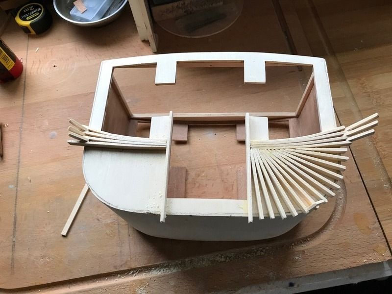

Kev: Lined the inside and started to place the battens on the front side of the box,I think it is to give a bulging effect,this will be made from 2x4 basswood you need a fast setting glue as you have to stand them on there side,more pictures soon.
Trev

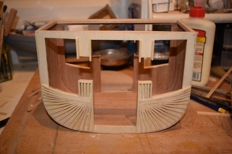

#57 Posted : 11 February 2019 09:44:10
Lining the interior and floor of the box.
First I cut several pieces of 150mm of 0.6x30mm from sheet to line the interior part of the curved wall and then cut several pieces of different sizes to line the interior of the side beams and floor.
Next I cut four pieces to line the interior corners using a steel rule to cut the strips,glued in place and sanded down with fine paper.
Placing the battens on the side beams of the box on its exterior part.
This is to give the box a bulging effect by gluing different size pieces of 2x5mm basswood on there sides and sanding down to the edges.
Thanks for looking
Trev.
