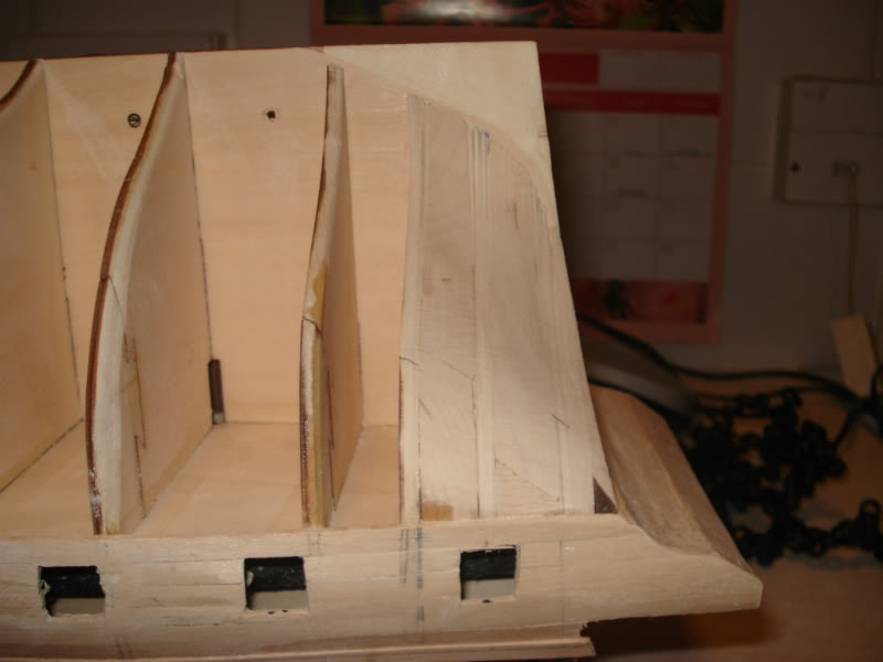

#41 Posted : 10 April 2012 01:33:20
Hi Darron
Thank you for the comments, have attached picture for you to look at
Ian.

Looks good Ian.
From your pictures it looks like the stern may need to be sanded back a bit more - until the brown laser cut on the keel starts to disappear.

Thank you Ian! ThumpUp
Stefan is right the stern looks as if you will need to reduce the transom down some more to match the false keel. Take care not to reduce the keel! as soon as the transom matches the angle of the keel and there isn't a slot anymore in the centre stop.

Hi Guys
thank you all for the comments, darron thanks for the stern photos realy clear explination of what needs to be done.
Ian BigGrin
#47 Posted : 11 April 2012 23:39:36
hi guys.
Have reworked transom as per Darrons excellent guide.
it saved me a few hours sanding down later when doing transome planking, thanks very much Darron.

Hi Ian
It may just be the angle of the pictures but it looks to me like a shade more need to comes off especially where the transom meets the planks. The false keel should be flush with the transom for it's whole length.
Here's mine for what it's worth
If it is then ignore this.
John

From the pictures I have to echo what John said.
#51 Posted : 12 April 2012 15:20:00
Thanks guys.
A bit more sanding to do. will post another picture when done.
your comments are allways welcome Ian Cool

#53 Posted : 12 April 2012 23:49:17
Hi guys.
Gallery sanded back to stem post. please feel free to comment ian .
#54 Posted : 13 April 2012 00:54:07

Just sand off that laser stain and it will be perfect.
John
#57 Posted : 13 April 2012 13:22:28
Thank you all for the comments and assistance in getting the stern correct. John the last part was sanded off after i looked at the pictures Ian BigGrin

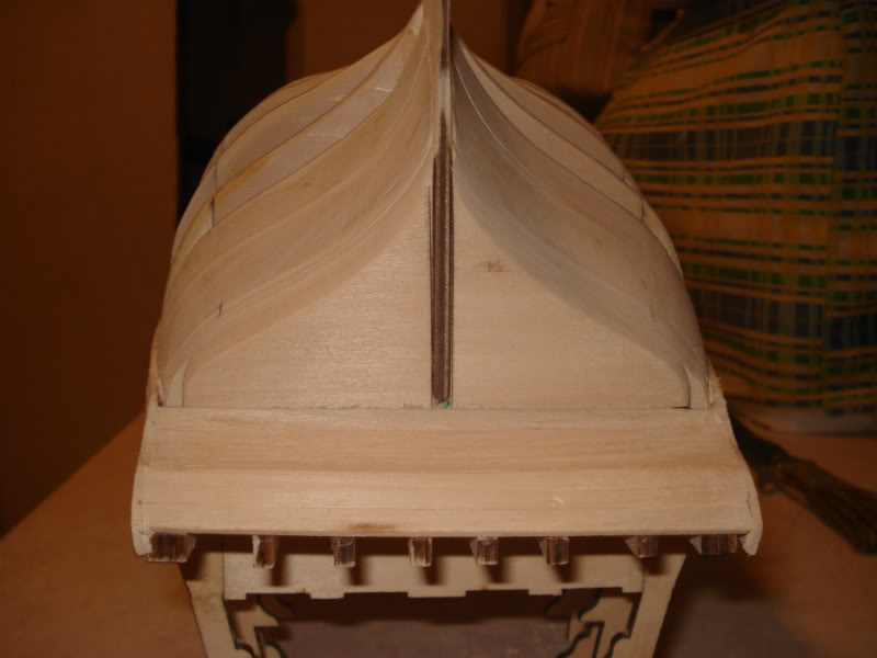

#58 Posted : 18 June 2012 21:35:46
Hi Guys.
Just a quick update on my build so far.
I have completed up to issue 32 on hull planking to the first four layers of planking on the lower hull.
#59 Posted : 19 June 2012 01:39:21

Great stuff Ian! Your planking is looking really neat, you can give yourself a well deserved pat on the back.
