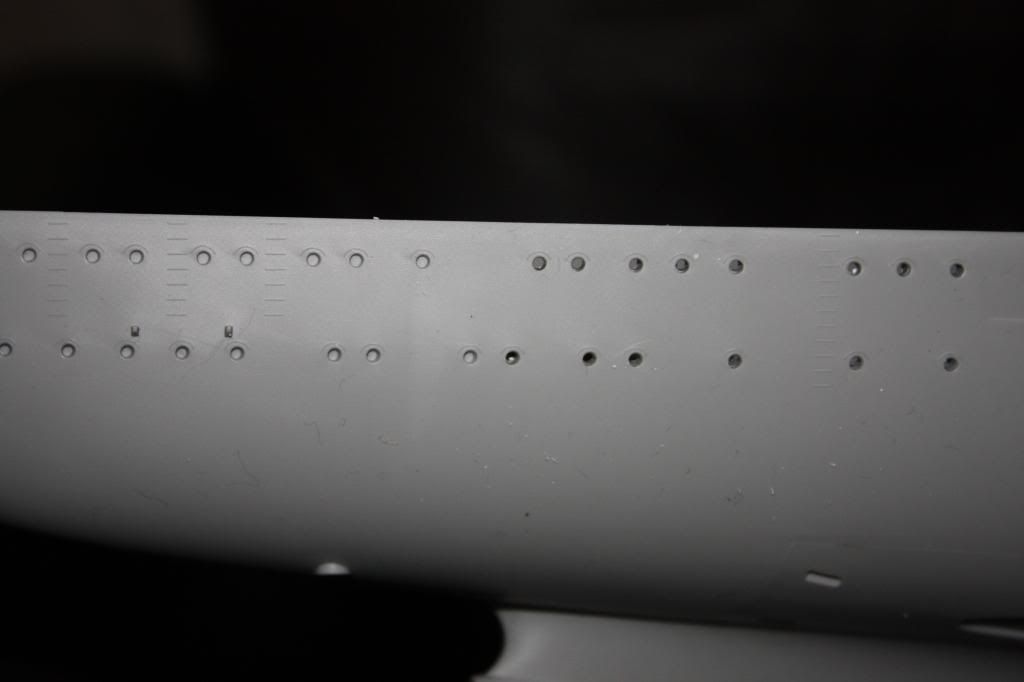

One way or another there is quite a bit of work to be done on the hull. I have started by drilling out the scuttles, I used a 1.5 drill for this, some care is needed as the stern flexed a little while the top row was being drilled out, but generally the hull is thick plastic so no great issues. there are three scuttles that fowl inner mouldings when drilled out so some care is needed not to over damage these. Once done i de-burred the inside with a wire wheel.

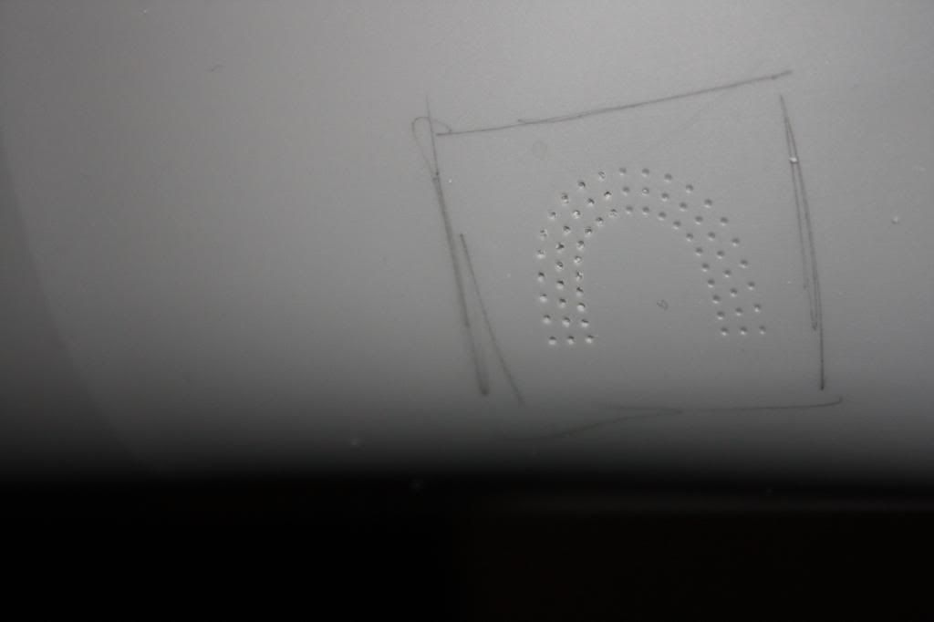

Next job was the exhausts for the smoke generators. I drilled two holes using a 1.3 drill, on reflection a bit large and would recommend a .7 drill. I have positioned mine 21mm from the top of the hull with a center point 2mm either side of the centre seam line (see link)

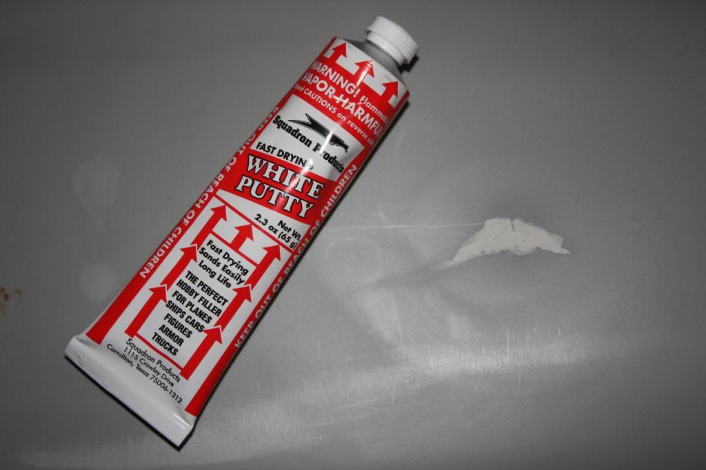

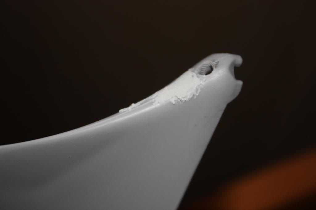

Moving to the bow the centre anchor hole needs repositioning. I have placed a 3mm diameter hole 7mm from the very top of the bow (see link for reference). once this was done I glued some scrap plastic behind the original hole to brace it. I have filled this and the blemishes under the hull with Squadron filler, i find this a good product for minor surface blemishes.

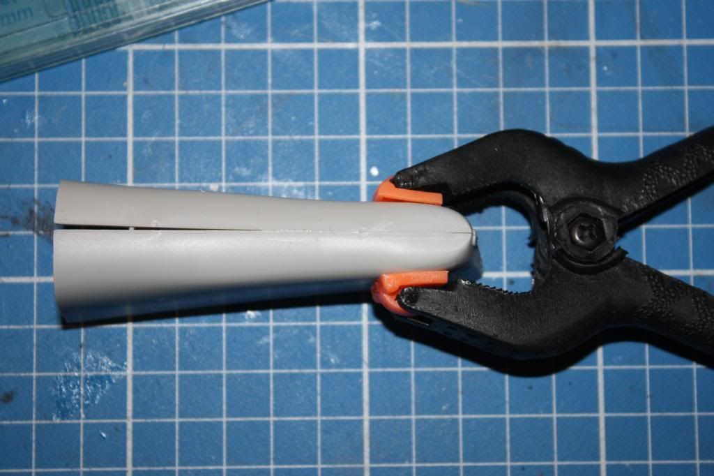

Hull Prep continued
Total Build Time 3.5 hours

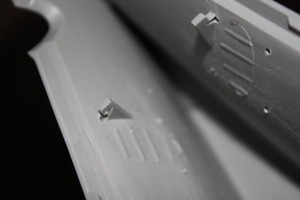

I have drilled the hydrophone holes a bit deeper so i dont lose them when sanding and to make sure they will be okay to take primer paint and was without vanishing. I used a .5 drill for this.

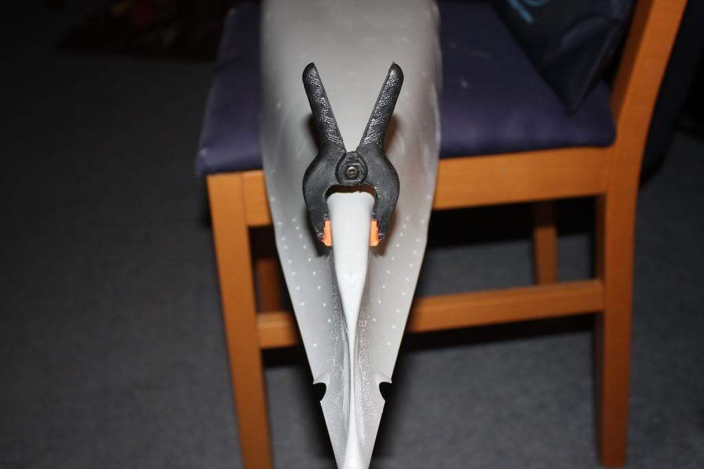

The bow section needs some clamping to get the parts to fit. I clamped the front end first and once set cemented the part to the hull and clamped the back end to pinch the parts into place.
