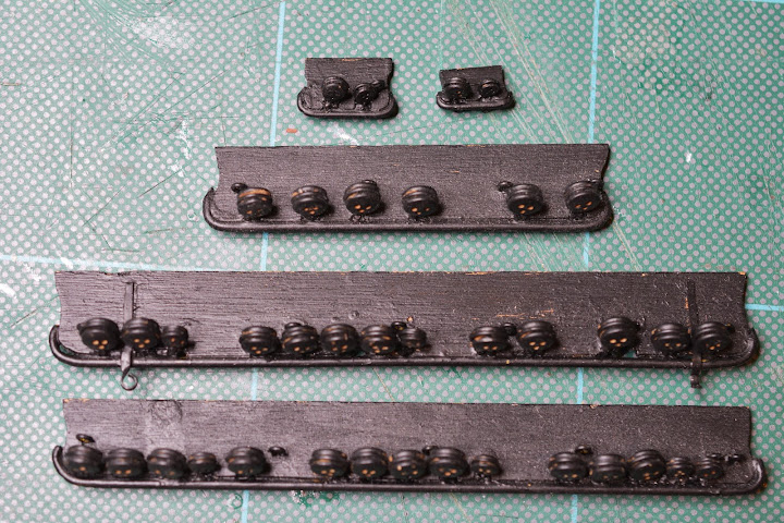

Another thing I did make, but will not be fitting to the ship until all the hammock cranes and netting are in place, are the chain wales or channels. I didn't like the Del Prado supplied ones or their plastic dead eyes, so made my own from my hard wood sheet and wooden dead eyes of
varying sizes purchased through Model Dockyard. Below are some pics of the portside set (starboard side is the same but reversed) starting at the front with the fore channel.
After the dead eyes were fixed in place I edged the channels with small brass rod bent to shape, then the whole assembly was painted black.
