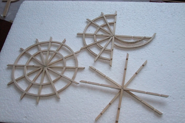

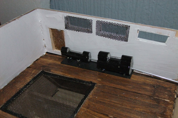

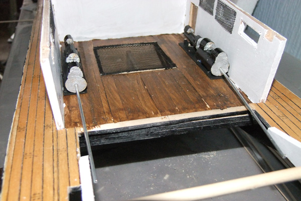

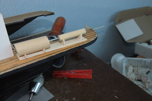

I was pottering round with some pieces of dowel, when I thought I may be able to make some engines out of this. You can see the result, the valve rods are made from paper clips and the piston rod is aluminium tube, bought in for the job. I have made some louvres for the first deck cabin shutters, I am not totally happy with them, and may redo them.
I have made a start on the stern wheel, the first part made was a bending jig, as I am laminating 1 x 4mm strip wood for the circular parts. I think it will be a slow job, as the wood takes forever to dry after bending and glueing. More next week all being well.
Regards,
Tony.
Tony C attached the following image(s):

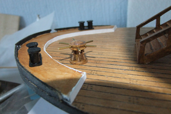

Not very much has been done, as I have been trying to complete my Victory cross section. Issues 149, and 150 arrived on the 21st, but I am still waiting for a missing elm tree pump section from issue 146. I have worked around that as much as possible.
A bought in capstan has been assembled and stained, a start has been made on the second boiler, and cabin door shutters. The second paddle wheel is under construction.

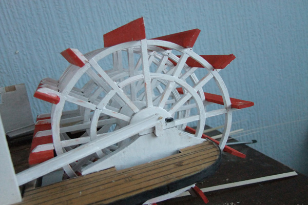

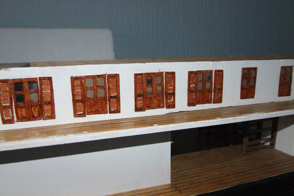

The second boiler has been completed and gauge glasses made for them both. They are oversize but it would be practically impossible to make them to scale, with the tools I have. The third paddle wheel is complete and the fourth under way. I have shown two of them temporarily mounted to the shaft. The final two doors for the port side 1st deck cabins have been made, they need staining and glazing, more shutters are being made.
I have a spare electric plank bender if anyone is interested. Why I have one is a long story I don't intend to get into here. It is used (it did the plank bending for HMS Victory) there is discolouration, but it is in full working order. Contact me by PM if you are interested.
Kind regards,
Tony.

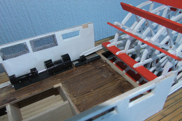

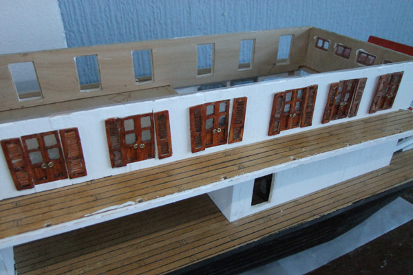

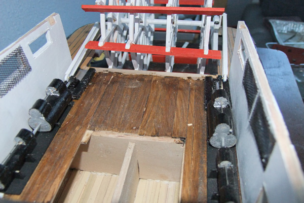

A bit later than usual, but here we go.Doorknobs have been made and fitted to main deck and port side 1st deck doors. The stern wheel has been completed and fitted, the bearing cap is held with 1/8" cut off screws and nuts. Crossheads and slides have been made, aluminium sheet is used to simulate the polished slide. The connecting rods should be in line with the piston rods, but space precluded this. A start has been made on the steam piping. I have decided that when the steam piping is complete, a control stand made, and a simulation of the valve gear made. No further details will be added to the engine and boiler rooms, or I could spend months doing nothing else. I hope people will not be too disappointed. Hopefully more next week.
Kind regards,
Tony.

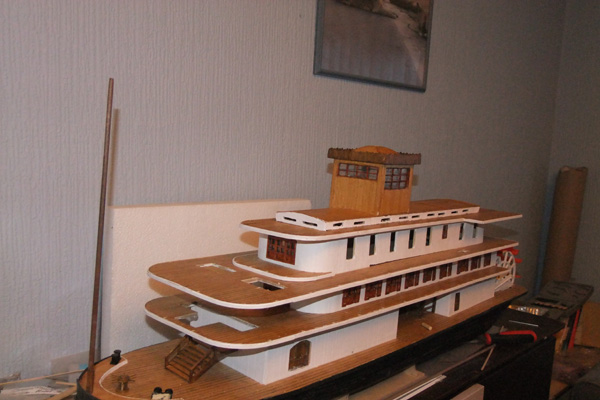

Progress has slowed due the the long awaited arrival of issue 146 Victory cross section. The third deck planking has been completed, stained and varnished. The superstructure has been assembled, the top planked stained and varnished, and the sides planked and painted. The mast/flagstaff has been made and varnished, a headlight needs making to go about half way up it, and a block fitting for the flag.
Kind regards,
Tony.
