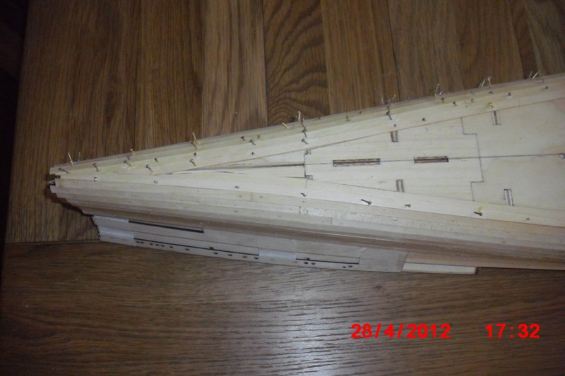

ISSUES 33 and 34
Hi Team, I have nearly finished the second planking, only the base of the Hull to go, this will be straight forward as putting a bevel on the planks is not required because it is a flat surface and we do not need as many pins.In issue 34 we received more planks fo the second planking.
Questions and comments welcomeBigGrin
Regards Mike

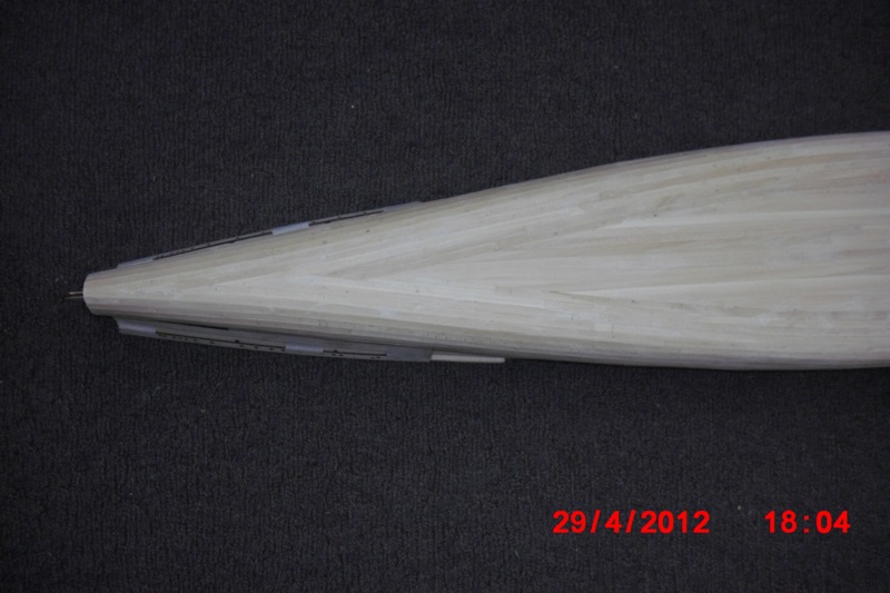

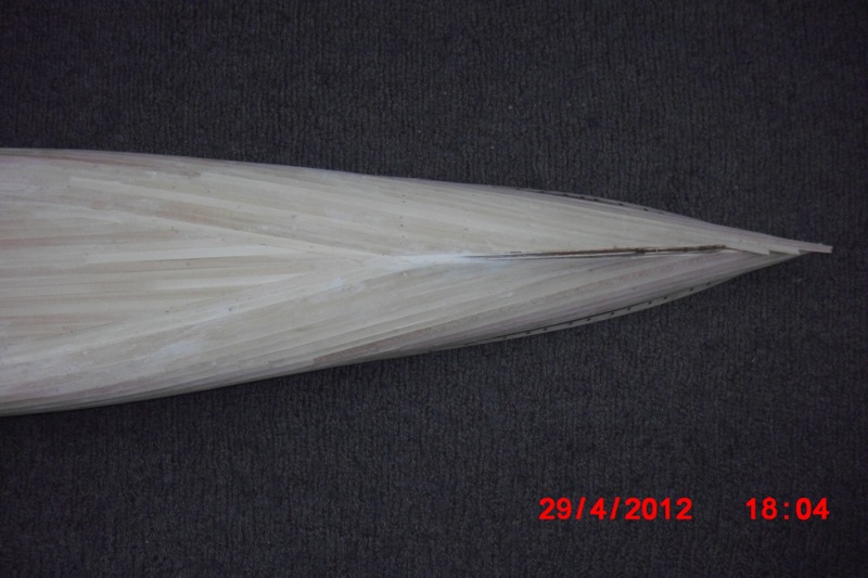

ISSUE 34
Well team I am up to and completed issue 34, I have applied the second planking on the ship and it is finished, here are some photos half way throughBigGrin :-
#606 Posted : 29 April 2012 20:15:31
ISSUE 34
Here are the photos of the ship with its completed second planking.
Please note I have started to fill all the pin holes with Ronseal wood filler, I have not yet started to sand the HullBigGrin Questions and comments welcomeBigGrin Regards Mike

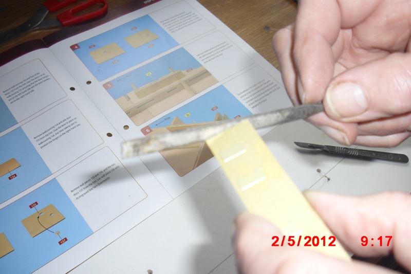

#612 Posted : 02 May 2012 12:10:14
ISSUE 35
These are the tools and adhesives I am using:
A metal file to remove the brass burrs.
A scalpel to cut the brass from the fret
Superglue Loctite ultra gel is good it contains rubber and will not go brittle overtime, this is for sticking brass to brass.
Evo stick Serious Glue to fit the Brass parts to the wood. there are no fumes with this glue and you have 3 mins to position your part. :-

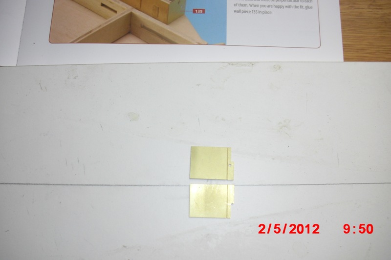

#613 Posted : 02 May 2012 12:13:09
ISSUE 35
Start by cutting the brass parts from the fret and file off the burrs where they were joined to the fret:-

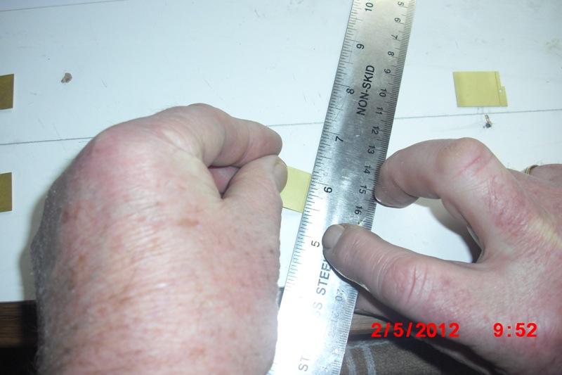

#615 Posted : 02 May 2012 12:26:08
ISSUE 35
Next job is to bend the parts which need it using a straight edge:-
Please not I believe the is a misprint on page 140 visual 7 the instruction call fo you to bend part 138 to 45 degrees, I feel this should be 75 degrees as in visual 10 part 139, in any event I have bent both parts to 75 degrees and they fit.
