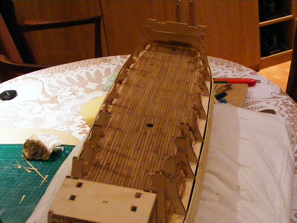

Hi alan, great build you got here, tis a shame about the wood stain though, my stain was darker than i hoped too even though i tested it before hand, but as you say it'll barely be visible. Will sanding it down not do the trick?

#602 Posted : 17 March 2013 10:45:30
Thanks for those kind comments Admiral... This deck was always intended to be used as a practice area. Now that somethin hasn't turned out quite right it is up to me to correct it to an acceptable standard.. It's all part of the learning process and will help me progress from being an average builder to a good builder and beyond... Will be trying to sand it down today to see if i can lighten it a little, a little use of white spirit may also help.... At least no damage has been done, none of it will be seen so am quite laid back about it now... Will post progress, good or bad so it can be used as a learning point for others following on behind...... Cool Cool
#603 Posted : 17 March 2013 13:17:46
Hi there Alan!
Just had a look at your deck staining problem, as you say it does look a little dark although its probably closer to the real thing than clean bare wood would be!
Have to admit I've never used stain of any kind on my three wooden decks (Grimsby, Bounty and now the ol'Vic), I've always preferred the look of the actual wood so I've either matt varnished or sanding sealer-ed it, (both clear finishes)
With regards to your problem, I think I would recommend using a very fine grade foam sanding block and lightly go over the deck until just enough of the stain has been stripped off, Using the block will mean you can't reach into every nook and cranny which is actually better for the finish, the areas you can't get into will appear naturally darker and will help the effect of 'shadowed' areas which will in effect add more depth to the deck.
You should hopefully end up with a good approximation of a 'weathered' deck, (just look at some photos of the real Victory's deck, they don't look as pristine as they once did - and that's an understatement!)BigGrin
As you say, this deck is almost invisible once the uppers go on so it's a good chance to try out some techniques, you never know, you might even get it looking so good you'll repeat it on the other decks too! Cool
Best of luck with it and let us see how you go!

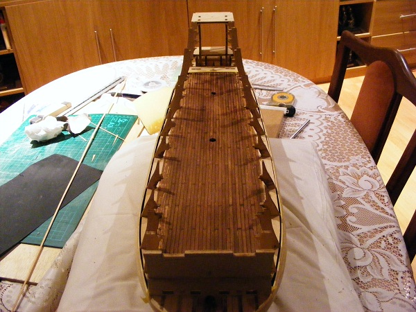

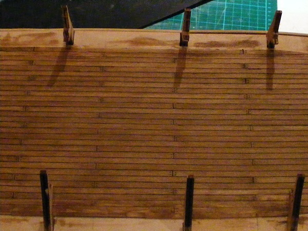

Am now a lot happier about the decking after a few courses of fine sanding following by cleaning with white spirit.... Not sure I can improve on it much more so tomorrow will give it a coat matt clear varnish and call it a day.... Good learning lesson this one..... Any comments prior to varnishing is appreciated....BigGrin BigGrin... First pic shows the deck as she was before I started.....Cool

Hi Alan!
Agree, the new color looks very nice, much better than the dark!
Regards, Bernd

Definitely an improvementThumpUp ThumpUp

Looks goodThumpUp
I might try that technique, of a Dark Stain then sanding back.
#616 Posted : 18 March 2013 10:48:37
BigGrin Hi Gandale .Looking good .I would just use Danish oil and not varnish .Regards MartynBigGrin
#617 Posted : 18 March 2013 19:35:30
BigGrin Hi Alan
A definate improvement there on the deck, another way to go with staining is artists inks but these are more substitutes for main colours. Hope this helps

Hi Alan,BigGrin
That must have been a lot of hard work, but I think time well spent even if on a deck that won`t be seen very much.A vast improvement if I might say so.
A lesson learned for the good, for us all.
Keep it going
